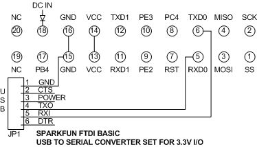

Just in case the information has not spread around yet, there has been a discovery by DeKay on wxforum that unlocks the Davis serial port on the back of the Vue (and probably other Vantage products that can use the Weatherlink datalogging cable).
Bottom line is that a Davis to USB cable can be built from easily procurable electronics, probably around $30 inc freight.

Initial report.
I was given a Vantage Vue for Christmas.
Using the resources above, I assembled the required components and built a Vantage to USB adapter cable with the Sparkfun FTDI Basic Breakout 3.3v DEV-09873
Wiring as per this diagram from madscientistlabs:
Upon USB connection, dmesg reported:
Configuration within Meteohub was trivial using the tty device and a selection of the init command (clear initial+5minutes)
I haven't put the sensor module on the roof yet, but the Vue is recognized by Meteohub and indoor temps, humidity and barometer are being logged.
