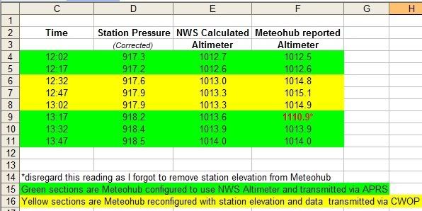

I finally had a chance to update to 4.9n yesterday and there appears to be problem with Altimeter pressures being reported to CWOP. While I cant tell for sure, it appears that the Altimeter formula may not be taking into account any barometer offsets from the sensor calibration page. On inspection of my data, it looks like CWOP receives an Altimeter value about 2 mbar higher than what I calculate it should be. This matches up closely with the 2 mbar reduction I use for my barometer offset on the Settings page of Meteohub. The reason I cant tell for sure if this is actually the problem is that when I reconfigure Meteohub to take into account my station elevation, Meteohub calculates a SLP value for my station that gives me roughly the same pressure error. This makes it difficult for me to determine if Meteohub is sending SLP instead of Altimeter or if Meteohub is simply not factoring in a barometer offset in the Altimeter calculation.
Below is the raw data I see on the APRS network. Unfortunately, I've got changing weather conditions here at the moment so its not as stable as I would have liked to show you but its close enough for you to see the problem. Data streams with "qAC" represent data sent via the internet with the APRS network selected using the AWK code for Altimeter. The data stream with "qAX" represent data sent via the internet when I select the CWOP checkbox and gives values from what I am assuming is the the built in Altimeter calcuation in Meteohub. Once I saw the error, I reverted back to the AWK code until we can sort this out.

Looks like there is still a problem. Upgraded to the revised 4.9n and reconfiguring the station to let meteohub report altimeter to CWOP...It still appears to give SLP.

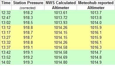

I've returned home from my trip and I see that there was an update to 4.9n while I was away. I've downloaded that update (4.9n, build 1116) this morning. After updating, reconfigured Meteohub to use CWOP and I logged about one hour of data as shown below. There still appears to be some kind of issue with the Altimeter calculation.
Data in green was transmitted via APRS network using the NWS Altimeter formula. Data in yellow was transmitted via CWOP option in Meteohub.
