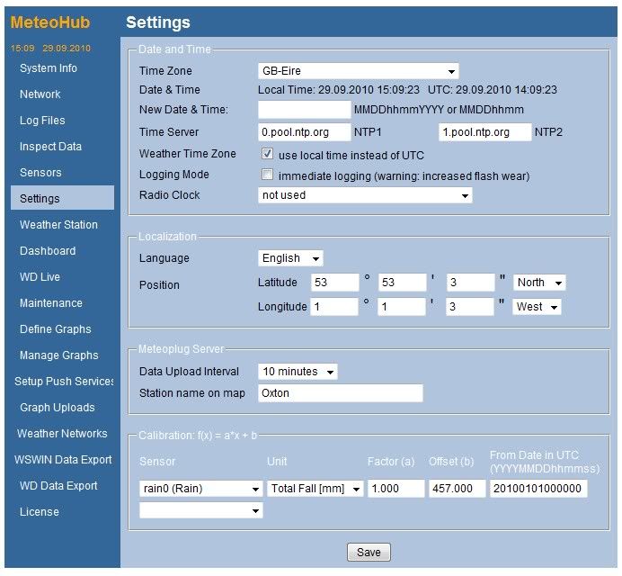

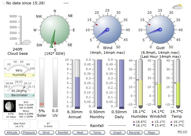

I am still unable to get Meteohub to accept the rainfall year to date. I have tried setting it as an offset - 457mm but it is still not showing in WDL:
What am I doing wrong or have I missed something?
David
Edit: Just tried putting an offset in for barometric pressure and that worked immediately in WDL. Is this a bug?
