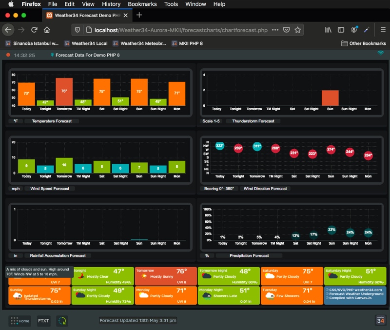

screenshot of your data forecast I just grabbed from wuforecast.txt in Firefox locally
