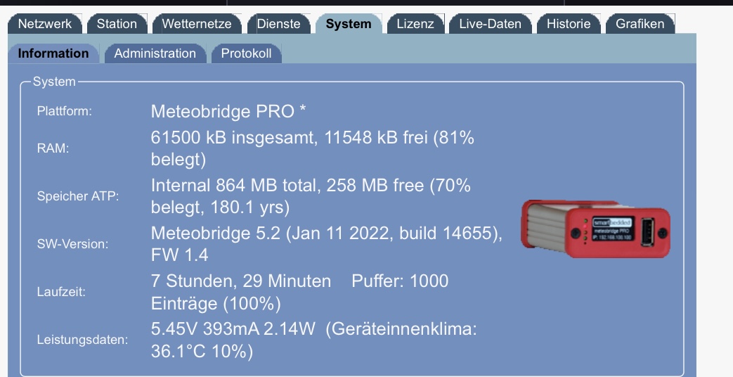

I am using a Meteobridge PRO with version 5.2 from. 11.01.2022 build 14655 FW 1.4. My uploads to Windfinder, Windguru and Windy are configured to upload every 5 minutes, skipping any retries but those stopped working properly. After a power cycle, the Meteobridge Pro comes up and transmits weather data for approximately 6 hours. After that no data is transferred to any service anymore. However there is still a green check mark for each service in the web interface although the last upload is already way older than the configured 5 minute interval. In case I increase the repeat interval, the 6 hours are significantly reduced. Moreover from the charts, I can see that there is valid data received by the Station itself, so it has something to do with the uploading service, not being triggered for some reason :-/

If you have defined retries on certain uploads and the target URL is not responding or slow then jobs will queue up. The buffer usage percentage on system info tab will then tell someting about 100%. Is that the case in your setup?

admin wrote: Mon Jan 24, 2022 11:10 am A few items in the buffer is fine as new jobs are first added to the queue and then executed from there.
You were right, the station upload stopped working again, and the buffer is filled up to 100%. Do you think, the internet connection is the source of the problem here? It would just be strange, that I am still able to access the station :-/. Will do a speed test tomorrow. Should the station be able to recover from that?

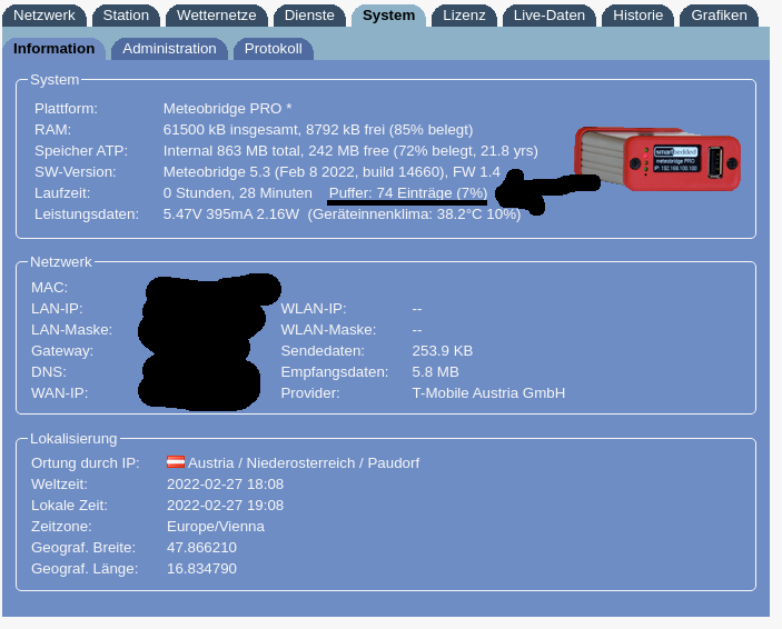

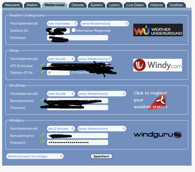

The strange thing also is, that the upload interval is set to 5min for Windguru and 1hour for the other two networks and without retries. So for 1 hour you should have maximum of 3 + 12 + 3 = 18 Buffer entries caused by the weather upload service. As in the Screenshot below the station is filled with 155 entries after 42minutes already. However, weather data doesn’t upload already somewhere in between where the buffer fills up, not only if it has already been filled up.
Any way to see what’s in these entries, or what causes them? Any way to check the logs of the weather upload service?

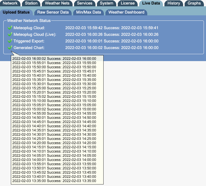

On tab "Live Data - Upload Status" you can check the history of events for your services. Clicking on or hoovering over the marks presents a log list.
That way you should be able to identify which service is filling up the buffer. Can also be a weather network fed with invalid credentials or similar.
Bildschirmfoto 2022-02-03 um 16.00.46.png (163.76 KiB) Viewed 4057 times

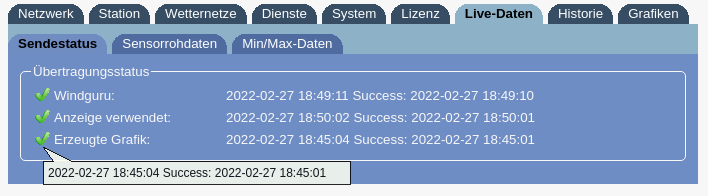

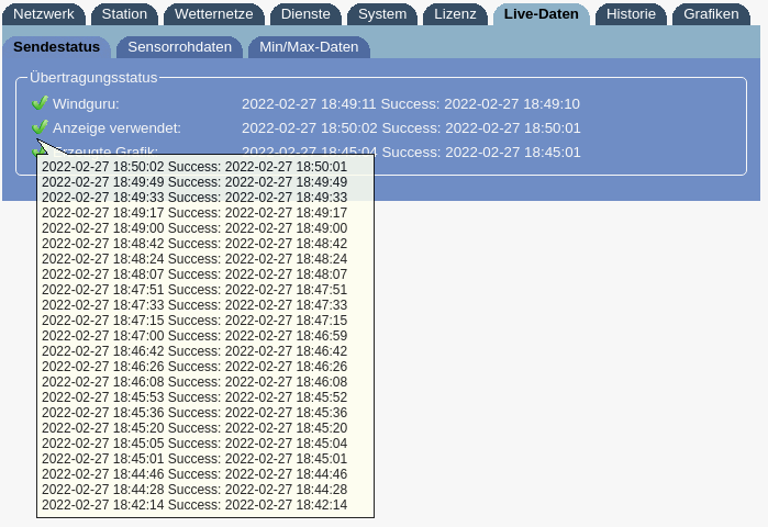

I meanwhile upgraded to the latest 5.3 release, disabled any upload except for Windguru and I did also check the "Livedata Upload - Upload Status" and it seems, the Buffer is filled up by "Anzeige verwendet".

However, there seems to be an issue with the Upload itself, so one can see, that the "Windguru Upload" already stopped working, before even the buffer has been filled up to 100%, which would then cause a similar error pattern.
Bildschirmfoto vom 2022-02-27 19-14-51.png (49.67 KiB) Viewed 3842 times
