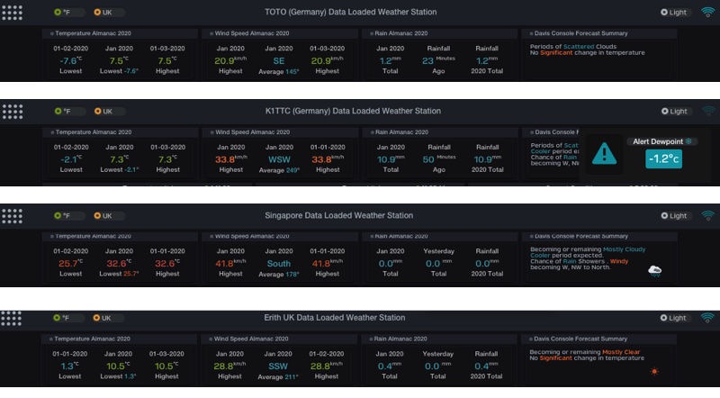

I have uploaded rainfall-year-month.php to GITHUB also pushed a smart update which you can get via https://weather34.com/homeweatherstatio ... smart.html
use whichever method suits you.
I tested with 4 data sets with a fresh download of template to make sure I wasn't on a different version mistakenly.
MBrealtimeupload.txt Datasets used K1TTC,TOTO,ERITH,SINGAPORE
however this does not explain the original problem of [rain0total-max@M1] appearing in the API as a string and not a value .
If this module still produces errors then I will just remove it as nothing changed in this file upto the point of when [rain0total-max@M1] was first noticed late January 1st started appear in the API.
screenshots of datasets tested within last hour

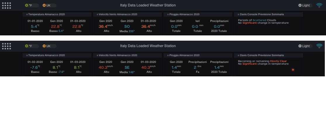

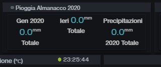

i've this issue....

no issue here are you using the updated file released earlier today 03JAN2020.zip ?
screenshot in Italian

yesweatherist34 wrote: Sat Jan 04, 2020 12:39 am no issue here are you using the updated file released earlier today 03JAN2020.zip ?
what could I do to solve ???weatherist34 wrote: Sat Jan 04, 2020 12:39 am no issue here are you using the updated file released earlier today 03JAN2020.zip ?
http://lamiastazionemeteo.altervista.or ... /index.php

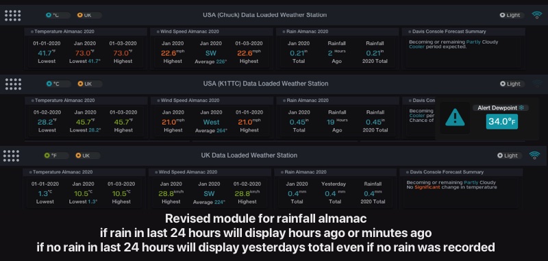

but I decided to remove the feature and the newer code is a lot more simpler and slimmer to maintain .
simple

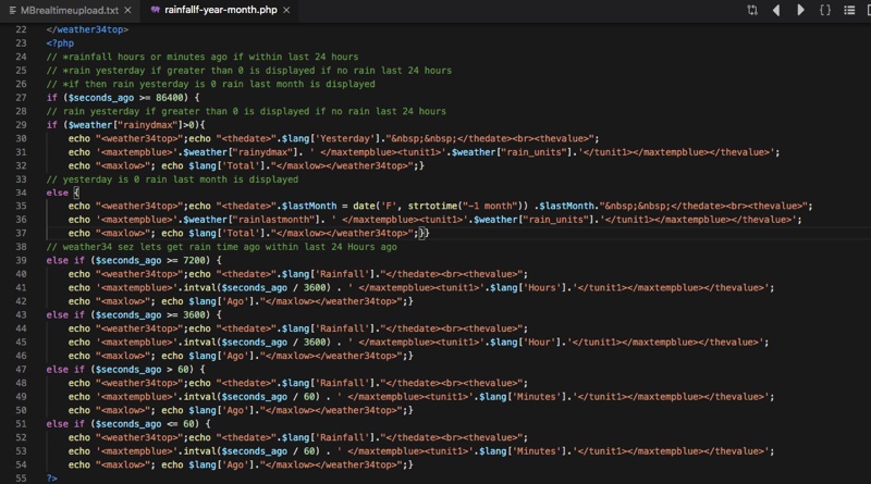

if rain last 24 hours shows hours or minutes ago
if no rain in last 24 hours shows yesterdays total be it 0 accumulation or total accumulated value
*its a rolling 24 hour not a specific to midnight to midnight to determine last 24 hours.

Yep, looks like Boris has fixed the issue. Thanks for the time you spent with the workaround. I agree, your present solution is much better. Also, the inclusion on the 2019 charts is a nice addition to the Console version.

to break it down
*rainfall hours or minutes ago if within last 24 hours is displayed
*if rain yesterday greater than 0 yesterdays total is displayed if no rain last 24 hours
*if then rain yesterday is 0 and rain time ago in last 24 hours is greater than 24 rain last month is displayed

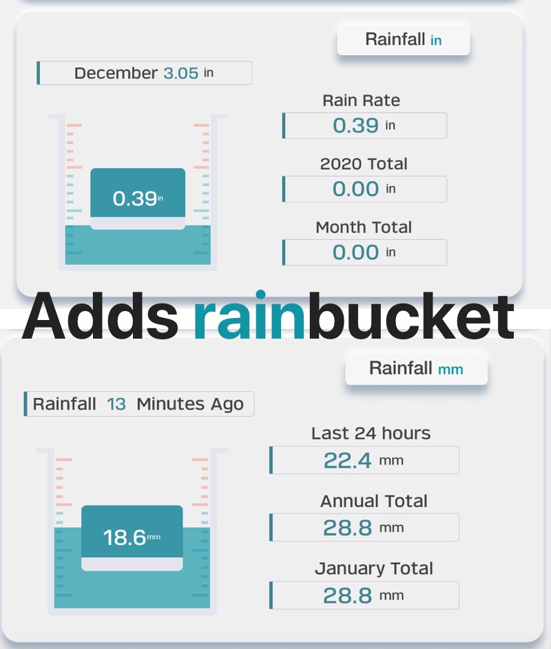

forgot to add ..alternative and stand alone now has the rain bucket feature. rain rate appears if value greater than 0(ZERO) if no rain rate shows last 24 hours.
