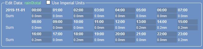

Here an example of import data of one day: 1.2mm
True summary of rain in csv is 2.8mm (1day WSWIN import file attached)
Thanks for help

I am not aware of a rain total import bug. When someone shares an import file that shows this problem, I can inspect.
Re: Data Import function for MB PRO and NANO SD
Please look at my post here in this thread (viewtopic.php?f=61&t=13303&p=31535#p31096), there is an example of wswin data which causes a wrong import of rain amount...
