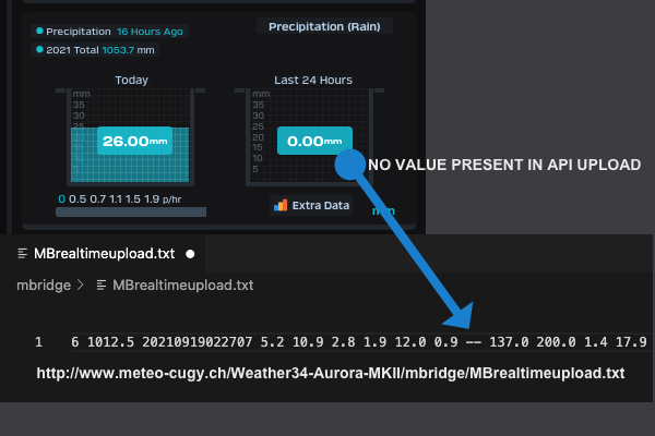

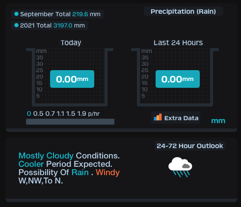

A small problem with the Last and 24h Precipition :
Alain
Good evening
You will have to look at your Meteobridge device or weather station as shown below in screenshot you have no value for last 24 hours in your MBrealtimeupload.txt .cant be of much help as it looks to be localized problem not template..

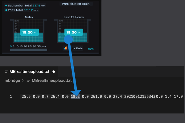

if I go to https://singaporeweather.info where Im guaranteed to see rain values of some sort I've added a screenshot of his MBrealtimeupload.txt with last 24 hour shown . its position 44 in the API
Your API output
Singapore output
Lespius
Posts: 44
Post by Lespius »
I reboot my MB device and it seems OK now.
Thanks for the prompt reply !

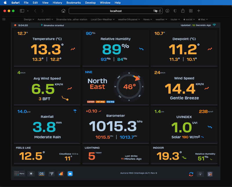

Lots of small changes occurred over the last few days with the Alternative/OS themes
many new tooltips revealing some additional info , use of tooltips prevents clutter and congestion in layout .

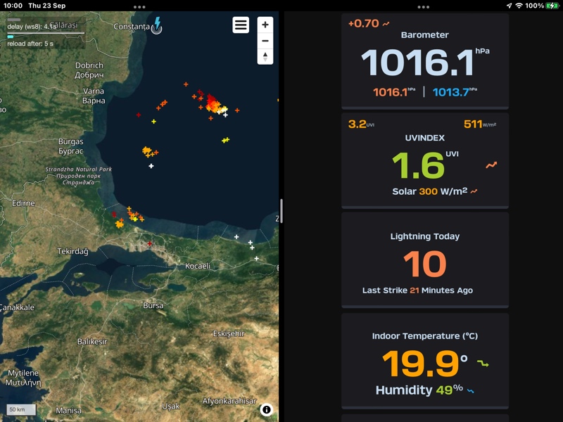

IOS15 compatibility has been there for a number of weeks , not previously mentioned has I was participating in the IOS 15 beta rollouts
on one of my iPads and NDA prevents discussion but now Apple IOS 15 is readily available so the minor changes were done in the background to support things like split mode(shown below) in advance ..
with that the ALT/OS layout have many additional features to use without having congested layout , in recent weeks all charts (90%) have a zoom/larger view again all there available to use without congestion accessing via the small icon in chart view layouts .
so have fun enjoy it and the features..remember it is a free template designed with the help of this Meteobridge community over many years .things evolve , ideas change and browser, devices continuously change with better friendlier ways of using and this template attempts to keep up with the way devices, browsers can be used without difficulty. as always I just make it look pretty :-) ..I reiterate without the Meteobridge device at the center of all this perhaps things may have been a lot less interesting perhaps looking like something built on windows 98 without focus on design capabilities and useability and Meteobridge for me makes life a lot easier to put ideas into practice and it keeps majority of the data all under one roof .
my sincere apologies to all those NON Davis Hardware OWNERS , being able to focus on one particular brand allows ideas to evolve with ease ..Brian

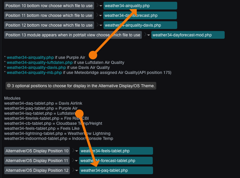

I added a Purple Air to my setup yesterday and was a little uncertain if I set it up correctly. The example below the setup field shows a 4digit number for the Station ID. I have no 4digit ID so I used the MAC or Station ID from the device. It appears to be working.
I set the Purple Air option using weather34-airquality.php and compared my Extra Data to Chucks and they are quite different. How do I get the same Extra Data screen for the Purple Air as Chuck's .. :-). I realize Chuck has 2 AQI's but the Extra Data from the Home Screen option is only showing data for the Purple Air.
Did I miss an update for the weather34-airquality.php module?

Hi Ron,
Purple Air :D
The Extra Data on mine is slightly customized. I am still using one of Brian's previous Purple Air files (weather34-aqi-info.php) in that slot.

Hello Ron

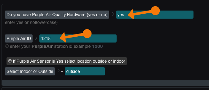

use the purple air traditional method by using your Purple Air ID . it will work when using the extra station thing in Meteobridge but it was originally designed to use the purple air API . I took screenshots the ID is required and option set to yes both of these are required to get chart data populated in day, month,year.
what chuck uses is a combined air quality config using the Davis Airlink indoors and purple air outside so unless you have both pieces of hardware you won't see those screens in that layout .
glad you got a purple air ,I've tried to order one many times but no shipment to Turkey unfortunately , I did have one user offered to purchase and ship from the his USA home address but he had some personal problems develop so I never pursued it. I have Airlink sitting in a box as I took mine down as we had a extra Air condition unit installed a couple of months ago and the outdoor extraction fan was very near .Airlink is ok but I've noticed it kind of suffers from being influenced by humidity when humidity is high I frequently saw readings that didn't reflect my microclimate :-) .so hopefully Ill find a way to get a purple air device one day ..
screenshots of setup and worth checking the air quality files are not locked !! (file permissions) , im sure you and chuck could resolve it easier due to being in the same timezone .
