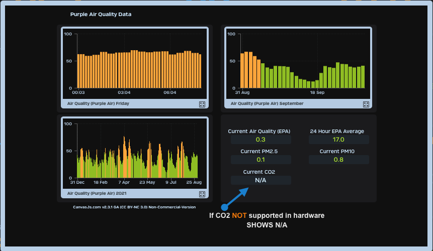

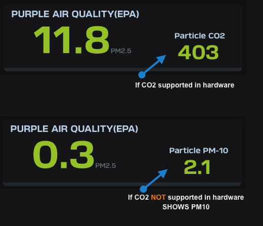

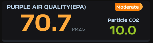

I have adjusted the purple air ALT/OS theme modules to recognize CO2 if present in the hardware .
Download Update 24th September 2021
* (08:42) * Alt/OS adds CO2 if present in Purple Air Hardware
* (08:42) * Alt/OS aligns barometer trend value
* (08:42) * Alt/OS adds last 24 hour rain value
for live example of purple air changes go here https://singaporeweather.info/weather34-tablet.php

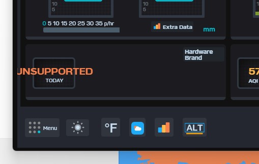

Just done the latest update and now my Ecowitt lightning module is now saying unsupported
http://192.168.0.125/Aurora2/index.php
Graham
Graham
- Posts: 1824
hello graham
im sorry the brand and alike are not supported any longer.. in terms of lightning it doesn’t conform to how ive used lightning with weatherflow for a number of years, the nonzerotime method is null after 3 days or aprox 72 hours and the standalone method with that brand is a bit confusing to maintain and setup . im so sorry but as i’ve mentioned quite a few times recently im streamlining the template because i cant support any stuff i dont own without the end user providing input at code level and at code level it needs to be a universal solution not a personalized solution as the another end user using a similar brand may have things all configured differently so it all becomes rather confusing for me to find a balance.
sincerely sorry but there are other templates around they may meet your requirements and offer better support going forward.
some may think ill lose users , can only say its a free template so the user base quantity is irrelevant and its not my incentive to plod along .I just want to have it all manageable and sometimes to achieve that you have to reduce the overhead for a manageable balance without it becoming a chore ..
edit
your new url graham is not reachable here forgot to mention http://192.168.0.125/Aurora2/index.php

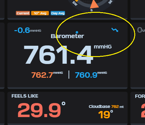

Hi Brian, if the barometer drops only one blue point as a message, no data.
- Sin título.png (24.92 KiB) Viewed 6091 times
- Posts: 1824
Hi Josep see GITHUB ..thanks ..Brianjmontamat wrote: Sat Sep 25, 2021 3:19 pm Hi Brian, if the barometer drops only one blue point as a message, no data.

Thank you for spotting ...
Download Update 25th September 2021
* (16:56) * Alt/OS add missing pressure falling tooltip Ref Josep

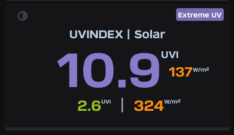

Download Update 27th September 2021

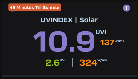

* (15:52) * Alt/OS Theme adds color coded tooltips to Air Quality
* (15:52) * Alt/OS Theme adds color coded tooltips to Temp/Dew/Hum
* (15:52) * Alt/OS Theme adds color coded tooltips to UVINDEX
* (15:52) * Alt/OS Theme adds color coded tooltips to Wind Speed
* (15:52) * Alt/OS Theme adds Air Quality caution phrase icon
* (15:52) * Alt/OS Theme adds UVINDEX caution phrase right icon
* (15:52) * Alt/OS Theme adds sunrise/set to UV module left icon
