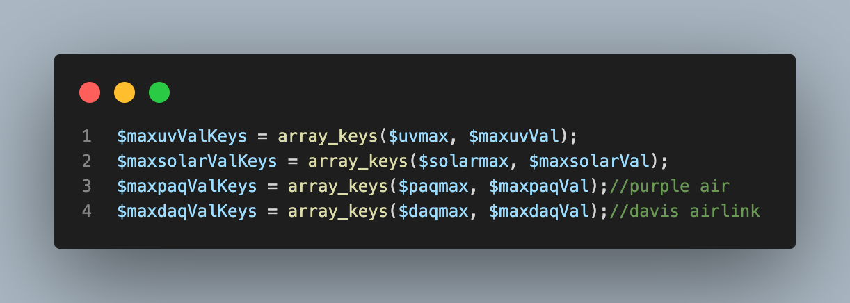

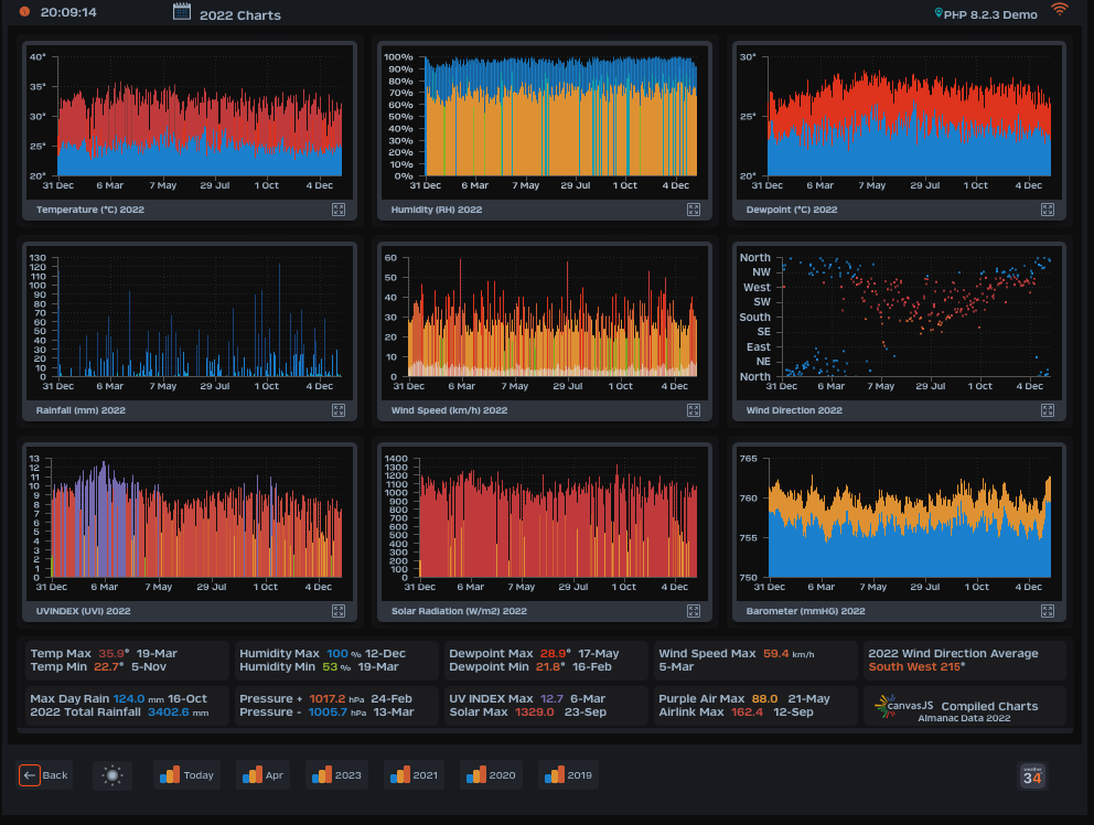

Hello Torsten
so this is how it panned out
uv/solar/air quality are all based on setup settings if particular hardware is set to yes i.e uv sensor == yes purple air== yes and so on
also recoded the rainfall to reflect max day total and date occurred alongside relevant year total
if no just displays relevant year phrase "Almanac Data 2022 etc , I have coded back to 2020 as that was when the extra sensor data for charts were added
so end of week do a simple update ..

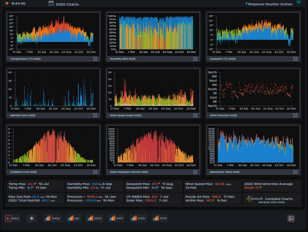

Simple-Update-Aurora-MKII-April-2023-Rev-Tor
https://www.mediafire.com/file/1ra4f0ga ... r.zip/file
Firstly a big thank you to Torsten for taking the time to compile a big part of this update .
This simple update is quite a significant update so it is very very important you do a back up of your current template install in the event something is wrong.
The update provides max, min ,average, rain total acumm for data going back to 2021 it does not provide history almanac data prior to that year (2021) simple reason during 2020 July the structure of the charts and collected data changed significantly adding more data from various sensors therefore the extra data is not present prior to July 2020 !!! so please don't ask or raise it as an issue Im totally aware of it . it is kind of complex to come up with a script to eradicate missing data or cater for data that don't exist.
additional code was added/modified from Torsten's original now caters for Rain total,max day rain , air quality via Purple Air or Davis Airlink ,fallback for no uv sensor but have solar sensor or if neither is present.
Update also includes numerous fixes raised over the last few months that got left aside so I thank you for raising those .
Adds Almanac data to chart footer (Torsten)
Fixes missing links in info hardware popup (cant remember who emailed this one but you know who you are ..thank you)
Fixes incorrect firerisk code (Josep)
Fixes numerous sunrise/sunset deprecated code (George)
Adds requested Earthquake module option in position 11 in theme 6 (George)
mmHG use simplified across all themes/layouts
screenshot of grahams (Ringwood UK) 2022 data using this update https://woolfg.hyperphp.com/Ringwood/co ... s-2022.php
...(Paul Wilman,Lars,Gary Bridge your sites are fully up-to date with is update)
brian..

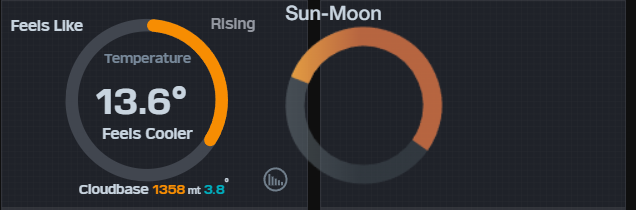

Hi Brian what is this module?
weather34-sun-moon-full.php does not appear in the setup.
Thank you.
It also looks bad:
Thank you.
It also looks bad:

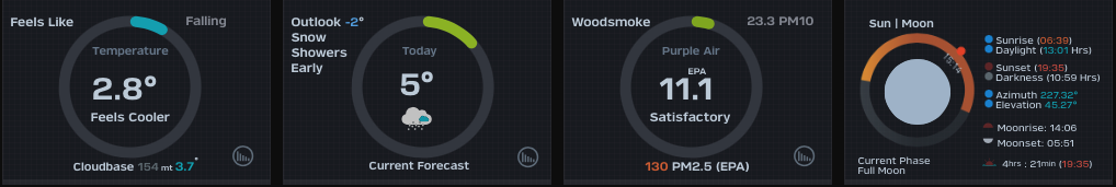

- Posts: 1824
hello Josep
it doesn't appear in setup option because it is not finished .
currently looks like this

Sorry for my inpatient.

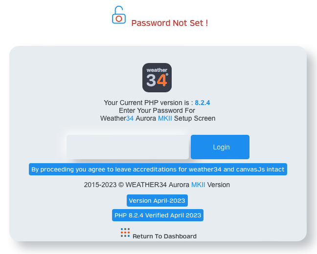

Simple-Update-Aurora-MKII-April-2023-Rev-K
https://www.mediafire.com/file/ruewxbms ... K.zip/file
this update adds the sun/moon module to theme 6 .this module completely reworked to match other modules in this theme(6) .this module also the moonphase script has been totally simplified and has simple small svg image to reflect current phase.
adds earthquake info popup link
adds requested sun|moon module (Alexy)
PHP 8.2.4 VERIFIED
adds more options to layout 6 in setup screen
adds small module for air quality max Purple Air | Davis Airlink to current month/year charts (Josep)
this update contains all files updated since August 2022 so important if you are on a version prior to August 2022 this update will not update correctly.
So there we are lots of module options to cater for everyone..
Johnscal sorry I'm not sure I get why a timezone difference would prevent 2021.csv being found perhaps provide a url so I can take a look to see if I can spot anything . FWIW we switched to no daylight here in Istanbul Turkiye ..a few years ago wouldn't want it any other way we simply don't deal with the inconvenience of time changes .initially a few home devices(mostly automated timers)/solar panel control box had issues but most of those were fixed with updates or replacements .I see absolutely no benefit in dealing with daylight saving inconveniences..
brian

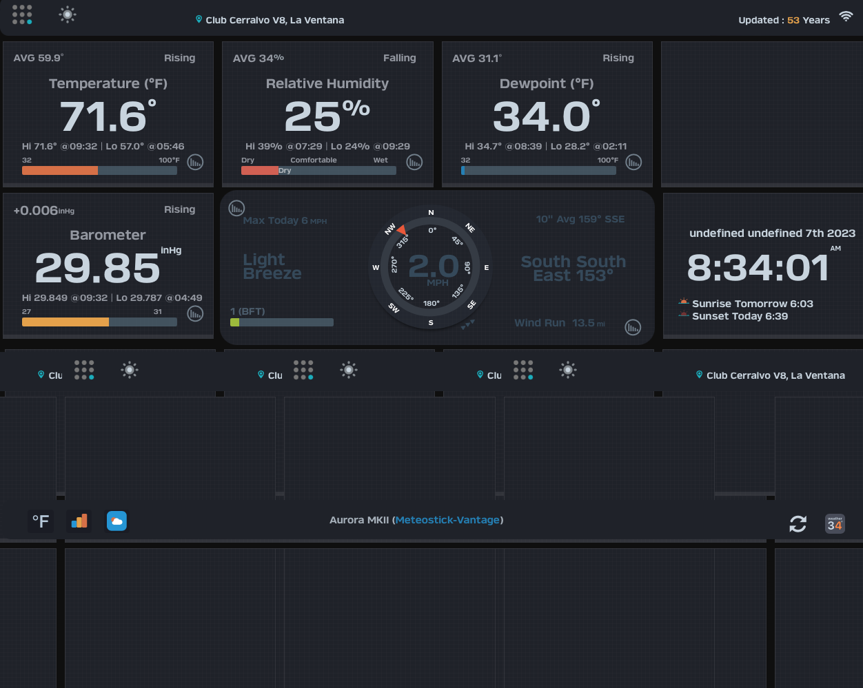

brian,
i think the timezone problem relates to various versions of php including 8.2.4 using a olson timezone db from 2021. there are more current ones on the php site but no windows dll to integrate it with iis using pecl extension. apparently it can be compiled with visual studio but kind of above my head.
you say the updates are for after the aug 22 update. my last update was 2021. it looks like the final master file you have posted has files from 2022. i tried starting over with that master and applying latest update. is that the correct that the updates should include everything changed from that final?
after doing so, it all looks good except layout 6 doesn't render correctly. see attached.
another long standing issue is whenever i start with a new master. the data update always says 53 years, i have to replace data_updated.php with an old copy from 2020 to make it work
finally you say verified for php 8.2.4. after switching to that, the updater no longer works and errors saying the version of php does not support unzip functionality. backup no longer work either. so reverted to 8.1...
thanks for your help
- Screenshot 2023-04-07 at 8.34.05 AM.png (205.49 KiB) Viewed 27435 times
never mind on the php 8.2.4 zip not working. for some reason iis installed it with zip extension disabled. now it works after enabling...
ugh. layout 6 wasn't rendering because i hadn't defined new parameters in setup. now it works...
