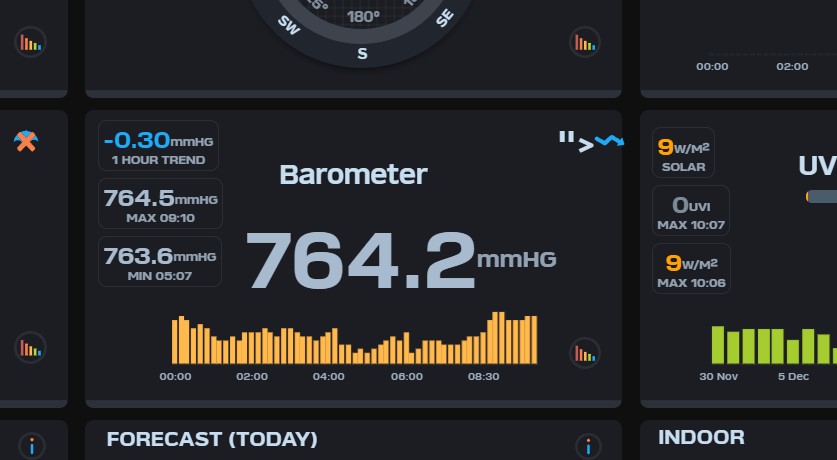

Hi, Brian! I noticed such a thing... This is possible only in the version with mmHg.
Screenshot 2021-12-26 101059.jpg (55.42 KiB) Viewed 9050 times

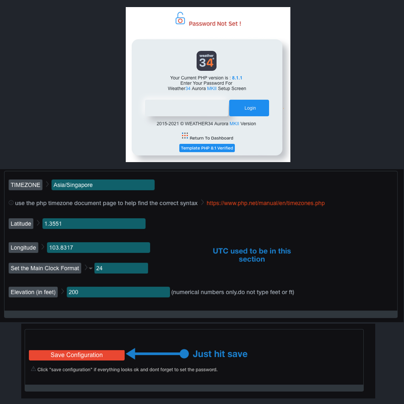

Hi Brian, a suggestion, with the use of TIMEZONE in setup it would not be necessary to change UTC Offset every 6 months in countries that change from summer to winter with the function:
$UTC = ($timezone->getOffset (new DateTime ()) / 3600); it could.

Hi Josep not sure where your adding this in ? if I add this string to various files it breaks in PHP 8.1but I haven't checked any other PHP version, perhaps you can enlighten me where you are using this ?
@Alex apply update as always sorry forgot mmHg ..
Added in livedata, works fine in PHP 8.07
include('settings.php');
include('shared.php');
###################### UTC ##################################
$timezone = new DateTimeZone($TZ);
$UTC = ($timezone->getOffset(new DateTime()) /3600) ;
##################### UTC END ###############################
error_reporting(0);
( you have to remove $ UTC = "1"; in console-settings.php ).
(Sorry I forgot to define $timezone) :shock:

Hello Josep
ok I see now the $UTC in the setup was conflicting . I think best to leave this till the new year and requires end user to rerun the setup screen to remove the existing UTC setting. so needs a strong message to highlight this (most don't read the changelog unfortunately and many don't read the notes just see the update and download it without reading but hey I can only use what means I have to get this change across !).sometimes things don't seem as simple as you envision ..many thanks Brian ..

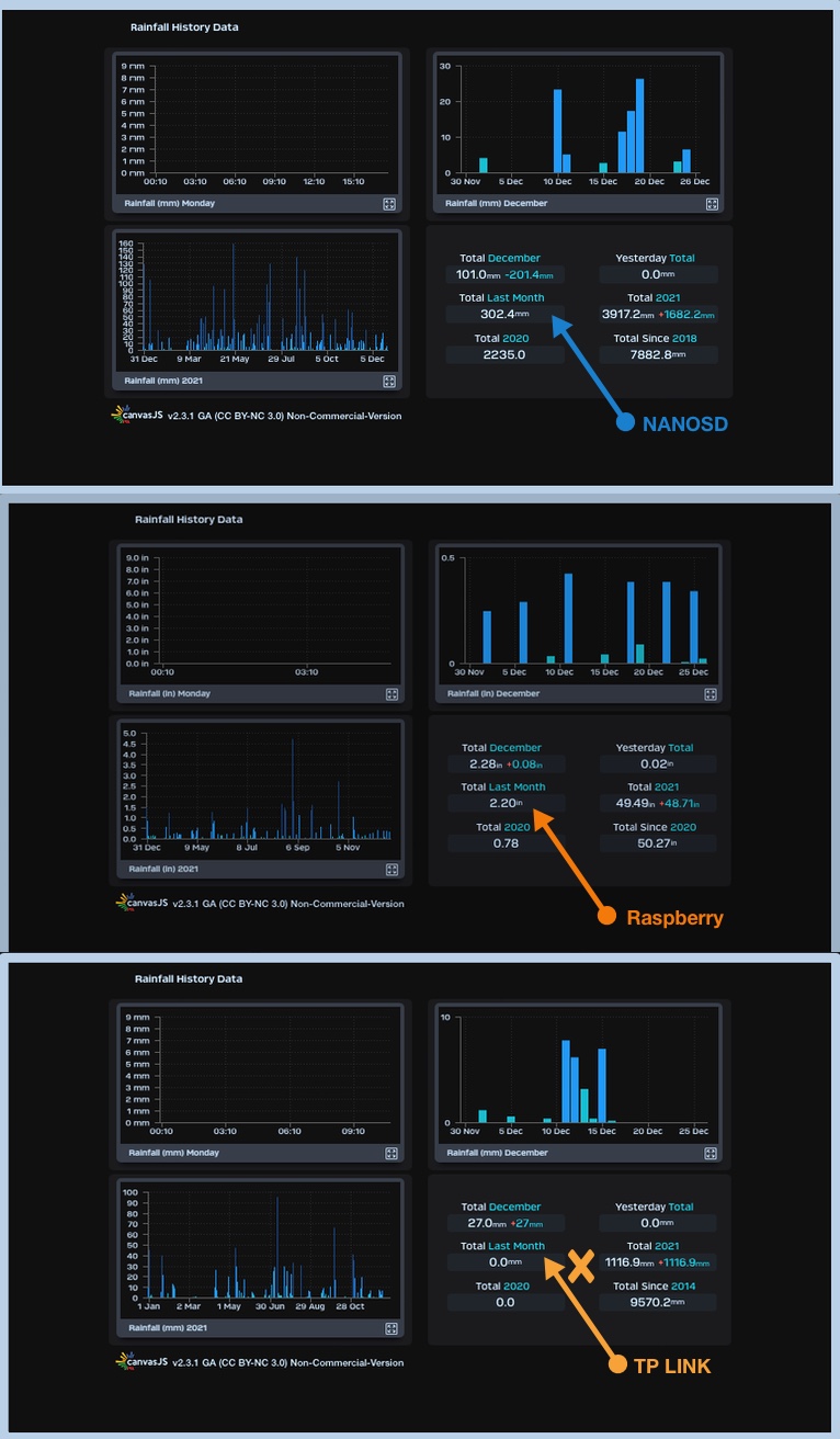

I'd like to point out that the previous rainfall "Total Last Month" is sitting at a value of 0mm.
I know this is incorrect as over 120mm of rain was accumulated during November.

Hello Good afternoon
are using a TPLINK ? unfortunately if so this data is not available .I checked various sites with TPLINK setups all show zero for last month.
screenshot below shows data available via nano(sd), raspberry also this particular data is available via Pro device but the data is NOT available when using with a TPLINK
device due to limitation of memory(ram) also I would think last year data will reproduce a zero..hope that clarifies it for you ..only thing I can do in a future update insert a if TPLINK or alike show nothing .template only displays what is sent via meteobridge itself for these values and alike.

TP-LINK is limited in memory, it does not present the Barometer 24H Change values ​​well either.
https://meteobridge.com/wiki/index.php/Comparison

Josep I have pushed your $UTC idea to GITHUB please note not added to livedata.php but added to settings.php as other files outside/not using livedata.php also require the UTC code i.e clocks, forecast etc .settings.php is a universal file used . also note common.php is no longer a requirement so that was removed .
please note me and my wife embark on a overnight road trip tomorrow as we cancelled our trip to Dubrovnik for obvious reasons so I won't be around till the 4th to respond but I don't envision any issues .
GITHUB users ensure you run the setup as to remove existing $UTC offset , just simply scroll down and hit save there is nothing to actually set just hit enter and it will erase the UTC setting.
