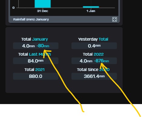

Hi Brian
Happy New Year
There appears to be a problem with rainfall extra data chart
http://ringwoodweather.ddns.net:86/Aurora2/index.php
Graham
hello Graham
80 mm less than last month(december)
876mm less than last year (2021)
equals 4mm accumulated so far this year.. :D
the blue values will always be the current difference between last month and last year
ps your url dont work hasnt for many months .

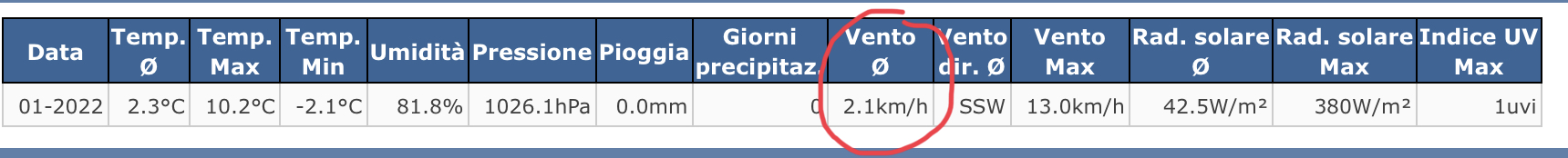

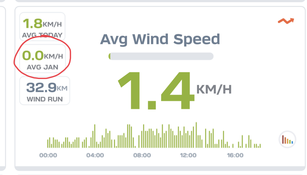

I have a problem: why the monthly average is always 0 km/h?
MeteoBorgo: www.meteoborgo.it
Hello Lorenzo correct my mistake its not in the API output and neither is year average speed . corrected or replaced with 15 min average will release simple update tomorrow . Brian

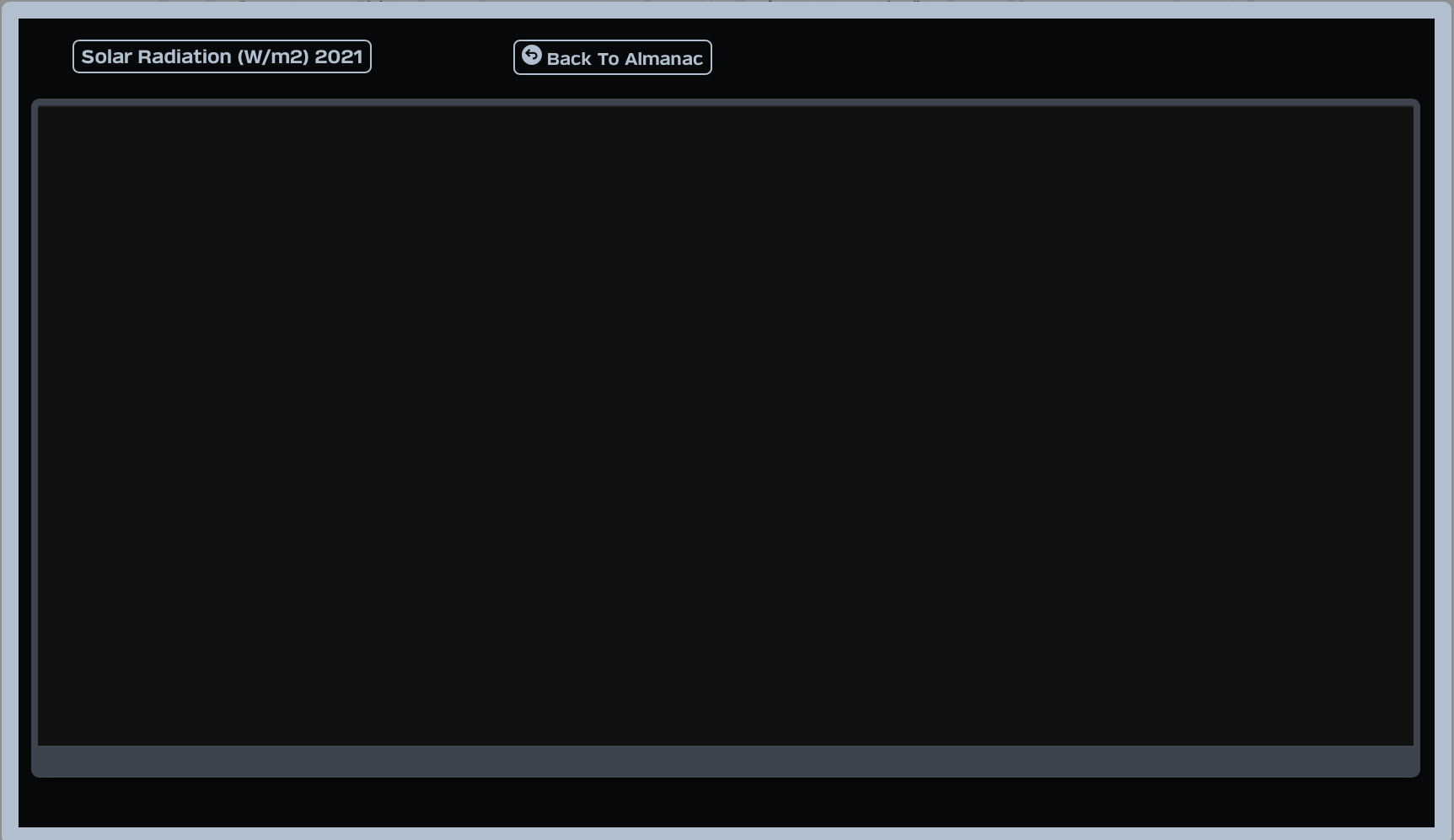

lorenz1982
Posts: 158
Post by lorenz1982 »

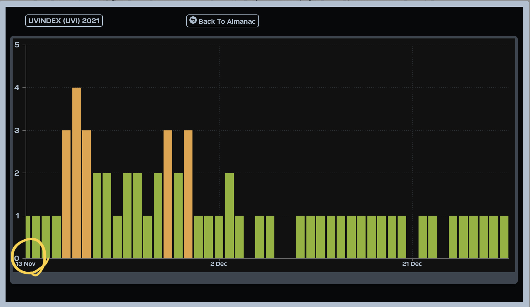

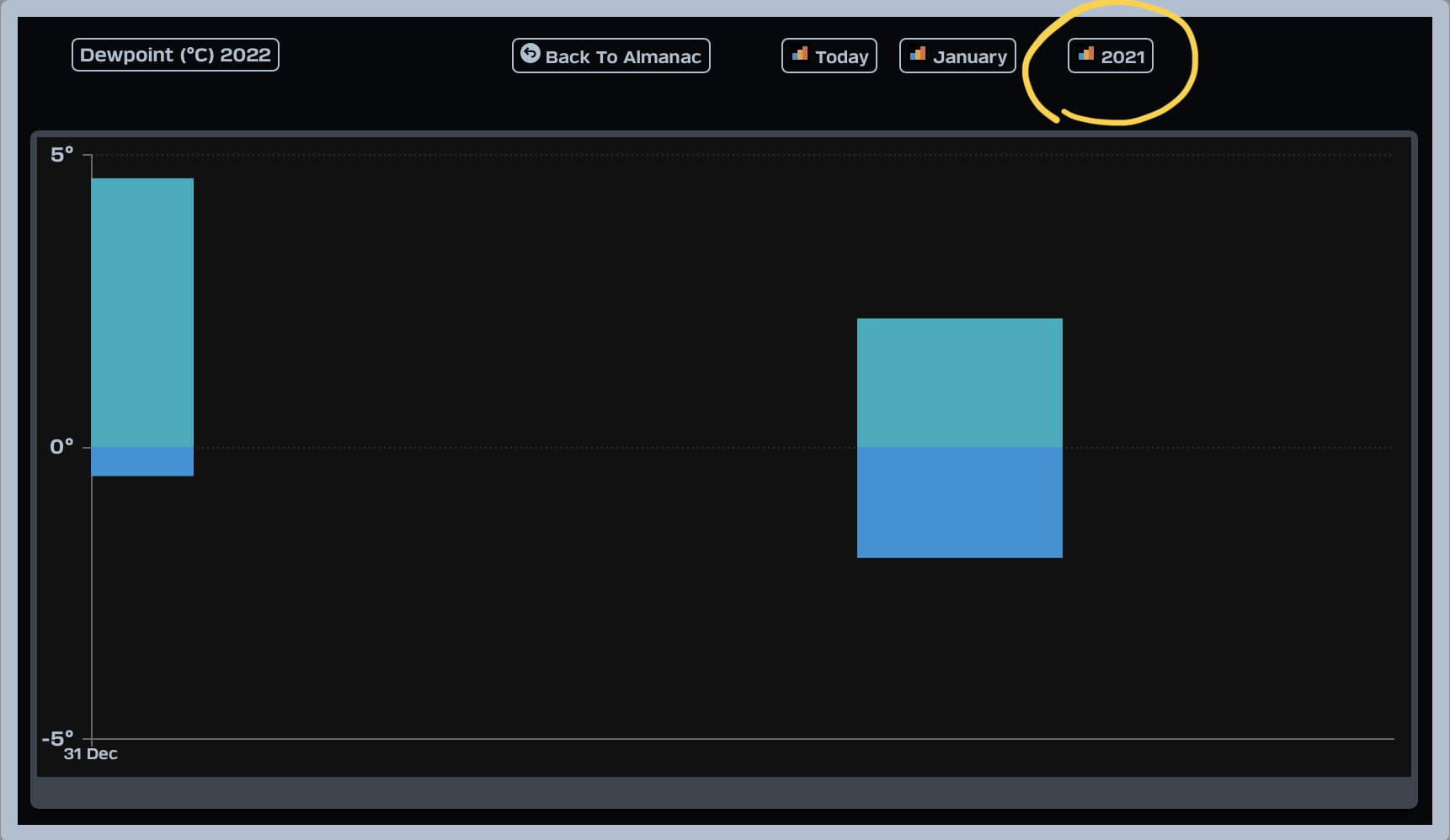

I still have some problems with connecting to the charts of the previous year. The UV chart starts November 13 and the solar radiation chart is empty.
good morning Lorenzo
see update just added addresses some of those but I can't reproduce the UVI shortfall of days....
Change Log 3rd January 2022
* (18:40) * Contains all features/fixes from December 4th to January 3rd
* (18:40) * Solar chart and dewpoint previous year phrase Ref Lorenzo

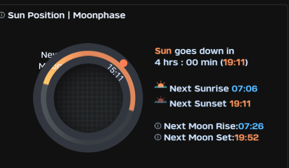

Posts: 259
Sun moon Text is currently moved off centre.
