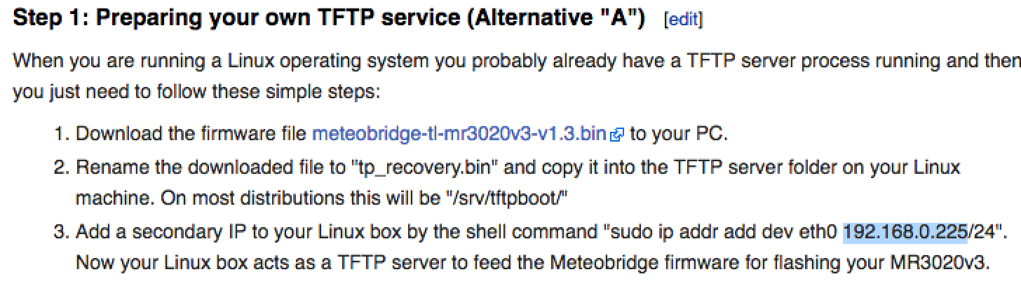

It would be good to add in the guide that the router are only listening on the IP address 192.168.0.225 when trying to get in the new firmware.
I was trying with everything to get the new firmware on my unit i´ve got. And i did it from windows with i believe tftpd64 program.
I´ve used sooo many programs that day with no results but when i changed my tcp/ip connection to 192.168.0.255 i finally got the results i been trying for after about 14hours of try and fail. Just telling!
Re: TP-Link TL-MR3020 Version 3 now supported (with WiFi)
Hodji wrote: Thu Sep 13, 2018 4:26 pm It would be good to add in the guide that the router are only listening on the IP address 192.168.0.225 when trying to get in the new firmware.
Sorry it explains exactly that in the wiki. Please see below:

I know that, i am more about to highlight that you need to hard-code that IP to the network adapter. Because i am not using Linux i didn´t know
i that i needed to use that specified IP address. I am more of an windows user and i didn´t manage to get it working with Linux. I tried and fail and looked at other alternatives to make it possible.

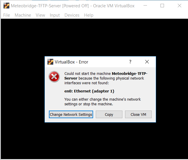

hi , using VM virtual box for flashing tp-link 3020 v3
stuck on step 6 - (Virtual machine will start and lots of log messages will scroll through a black terminal window. Just ignore and wait until screen holds and shows flashing dialog.)
Instead i get this ...(attachment)
Any help much apreciated...
thanks

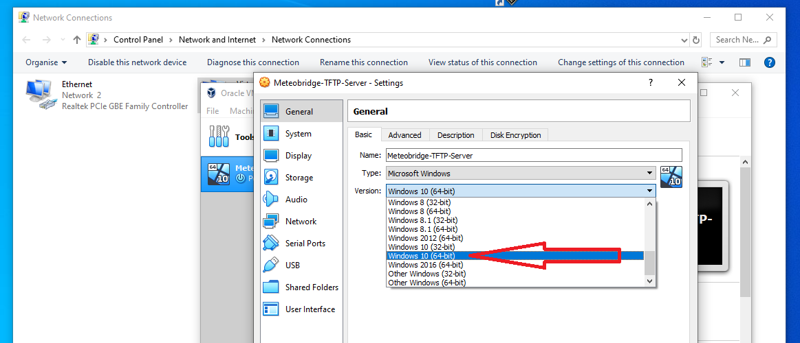

So , i go step by step from another pc in another location now with the same result....what do i do wrong ?
windows10 , at step6 stuck...

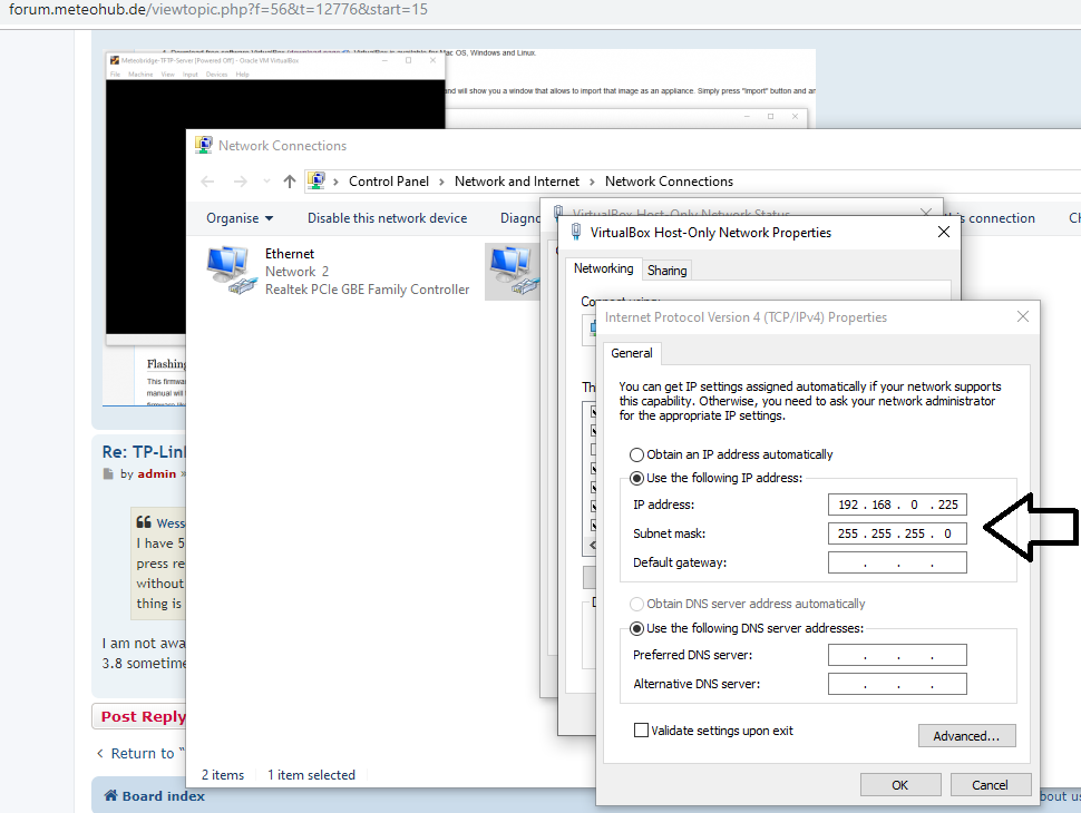

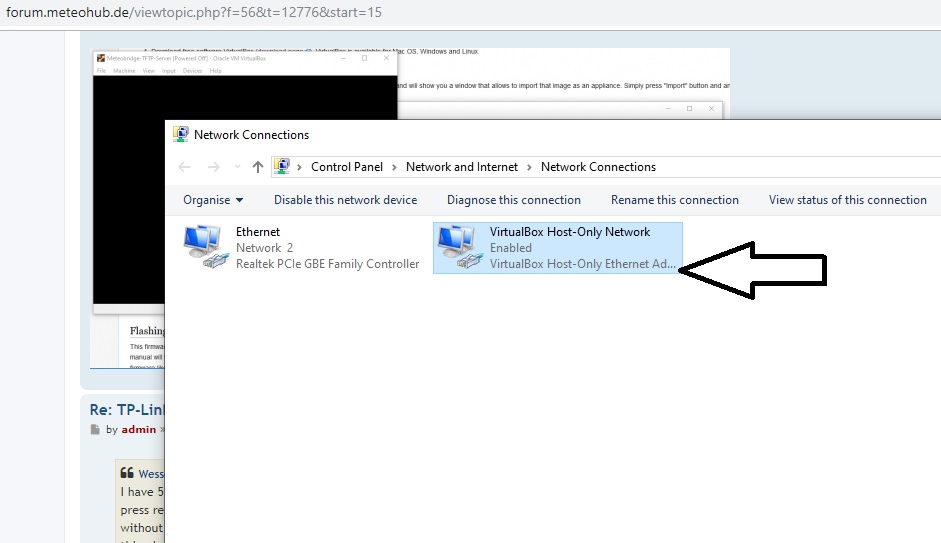

go to ethernet ....tcp.ip4 manual at 192.168.0.225
very important ...go to settings in Virtual Box and select the version of operating sistem (windows 10/64-bit in my case)
All fine now....

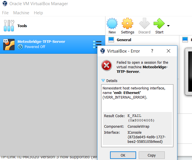

ullises wrote: Tue Oct 08, 2019 12:34 pm hi , using VM virtual box for flashing tp-link 3020 v3
thanks
I have exactly the same problem, get stucked when I try to start the virtual server. Trying to change the "Networks settings", but only gets "Invalid Settings detected", what ever settings I use.
Using Windows 10, A new TL-MR3020 ver. 3.20
Any help appreciated. / Johan
All fine now....

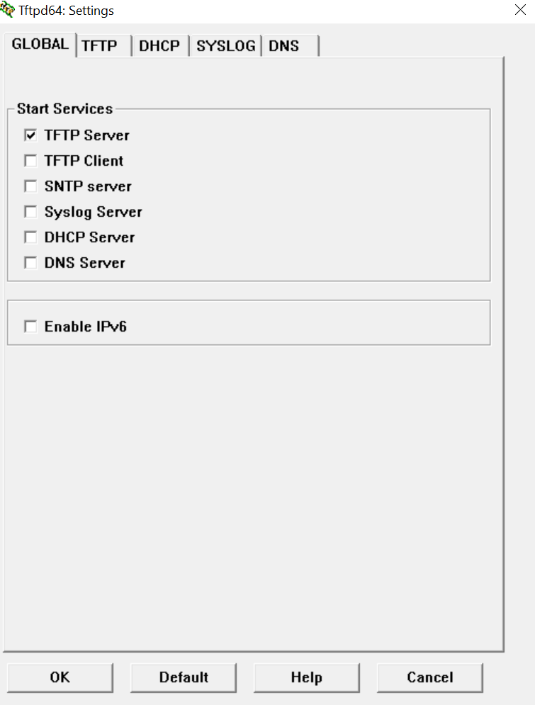

Hi '

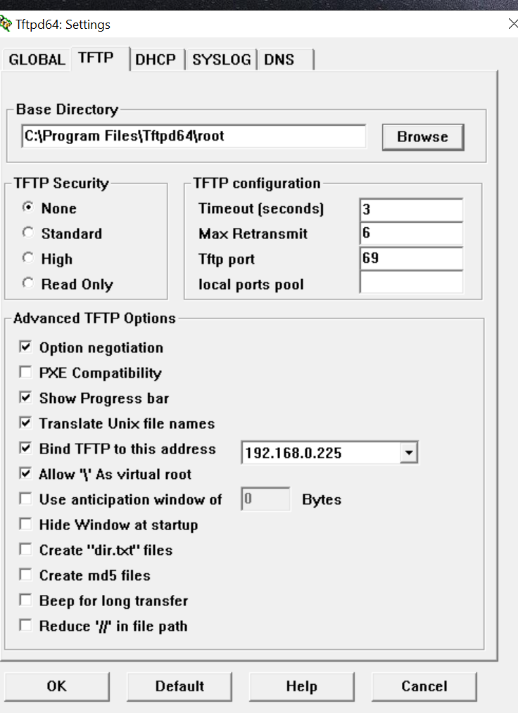

I'm a Windows 10 user and did the flashing in a different way. It took less and 5 minutes.
Download tftpd64 from https://bitbucket.org/phjounin/tftpd64/ ... -setup.exe
Install tftpd64
Create folder root in C:\Program Files\Tftpd64\
Download meteobridge-tl-mr3020v3-v1.3.bin from http://connect.meteobridge.com/files/me ... 3-v1.3.bin
Rename to meteobridge-tl-mr3020v3-v1.3.bin to tp_recovery.bin
Copy tp_recovery.bin to C:\Program Files\Tftpd64\root
Connect pc and modem with an ethernetcable
Set PC IP to 192.168.0.225
Configure ftpd64 (se pictures)
Press the reset button on the top of the MR3020 and keep it pressed.
Connect the MR3020 to power while you keep the reset button pressed
Release the button when the transfer is done
Find the new IP address of the modem and connect via a browser
Configure the net using the Meteobridge Guide for MR3020
Rgds
Gert

Thanks Gert!
You are my hero! Now, that was much faster and easier! Everyting is ok now.
