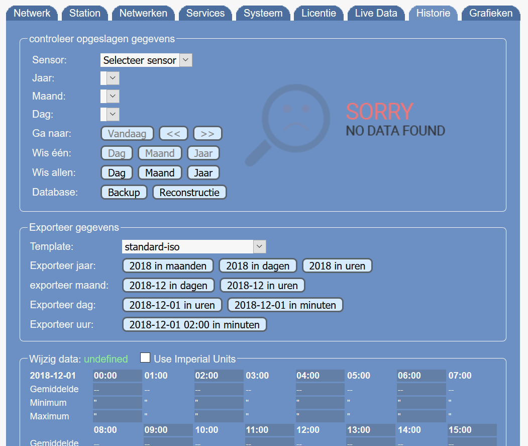

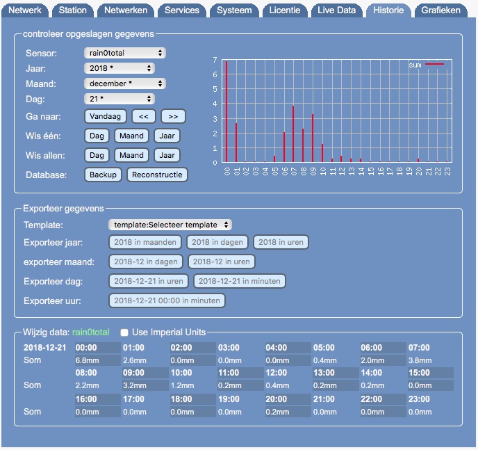

When I ordered a back-up (on tab System), MB Pro did a reboot. When the process started, no import funtion on tab History. I did a new reboot, but also no import function on tab history after the restart.
Meteobridge 3.8 (Dec 22 2018, build 12592), FW 1.4

Re: Data Import function for MB PRO and NANO SD
The import function is gone Boris
- 2018-12-22.png (126.01 KiB) Viewed 7075 times
