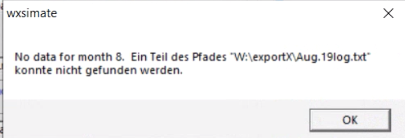

Looks like wxsim searches for Sep.19log.txt Aug.19log.txt
so the file pattern should be
#pragma exportfile=[MMM].[YY]log.txt-
