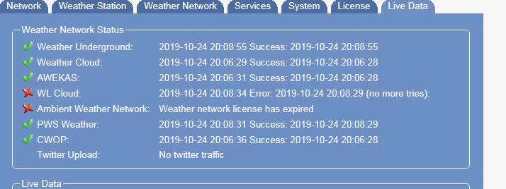

Updated to the Oct 22 update. Tried again and am seeing:
i will check back in a few hours and see if anything has changed.

superduty wrote: Fri Oct 25, 2019 5:10 am Updated to the Oct 22 update. Tried again and am seeing:
Double check the URL and your login info.
Also, for the Ambient Weather error, select Ambient Weather in the Networks drop down again and set it to never upload, then hit save. Should stop it from trying since it looks like you don't have one bought from them.

lightmaster wrote: Fri Oct 25, 2019 5:15 am
OMG, thanks for that info. I had one for years, then they wanted you to purchase a new unit, I declined.

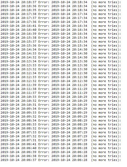

clicking the X provides:

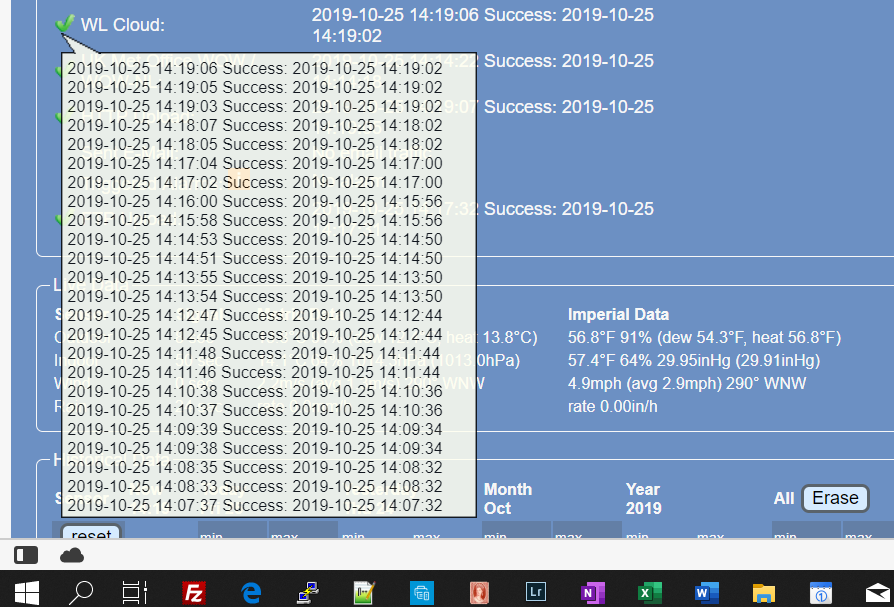

My Meteobridge has been uploading for 6 hours now, but still no data at Weatherlink. Any ideas how long the initial load will take?
Rgds
Gert
2019-10-25 (2).png (166.41 KiB) Viewed 7337 times
Re: WL CLoud network support in Version 4.2
Does it show a green mark for WL CLoud on "weather network" tab? If not it is an issue with the credentials... may be any aditional whitspaces etc...
