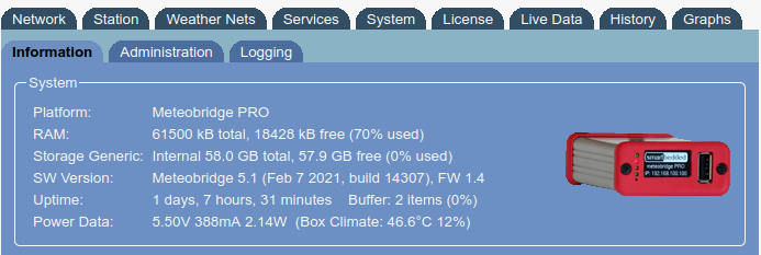

I have just tested with a uSD card reader, and a 64GB uSD card I had lying around. I was able to get this to work.

Maybe you need to see it to believe it:
