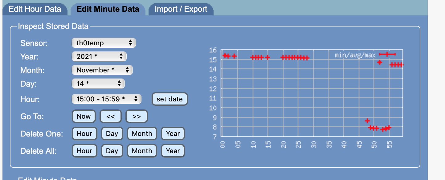

wrong system time after reboot
Re: wrong system time after reboot. **solved**

Just made a reboot test after some hour and the prb is still here...
impossible to have a working reboot
the RPI is on Internet behind a setup box.
looks like the issue is with something in the image which is downloaded.
I see the download, then the RPI reboot, and lost

after having waited 5 minutes, the date is finally set to the correct one (it was not happening with the previous release some weeks ago...)
looks like something has been added in the code as a patch to mask the main issue with the clock during the network bootup.
what about the DB during the wrong time set ?
we have the answer below
Capture d’écran 2021-11-14 à 19.22.01.png (129.63 KiB) Viewed 4340 times
the DB has been impacted ...

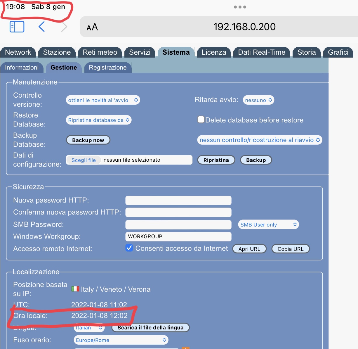

Maybe I have the same problem?
viewtopic.php?f=61&t=16155
