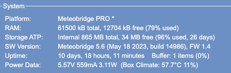

Adding to this discussion from some months ago. I have also a problem with the 1 GB storage that is full. Due to many sensors and storing up to 1 year data in 1 minute interval. As the screenshot shows there is only 34 MB left.
How to release that data? I changed to storing mapped sensors for 180 days. But that doesn't release any used space. Only the remaining estimated days of use goes up a bit but no MB's are released.
Because of the full storage, database it is almost continuously locked and I can't generate graphs and service events don't work well.
Hoping for an answer,
Ton

looks like the Option has moved from System --> Administration to Database --> Administration
(the menu naming and menu items have changed in the last updates)
In the section "Time Resolution" you can choose the release of minute-based data now
if you want to keep your minute data - either do a regular (e.g.) daily export or/and change the internal USB stick to a bigger size (or use the microSD with USB adapter approach discussed in this thread earlier - cheaper and bigger sizes available)

There I changed it to 180 days already. All that happened is that 16 days storage became 26 days, but no memory was released.

TonvG wrote: Thu Jun 08, 2023 7:24 pm There I changed it to 180 days already. All that happened is that 16 days storage became 26 days, but no memory was released.
the database will not shrink when the minute data is deleted (unless you make a database reorg, which won't be necessary) - however, there will be more free space in the already allocated database storage available for storing data; hence the increase from 16 to 26 days.
