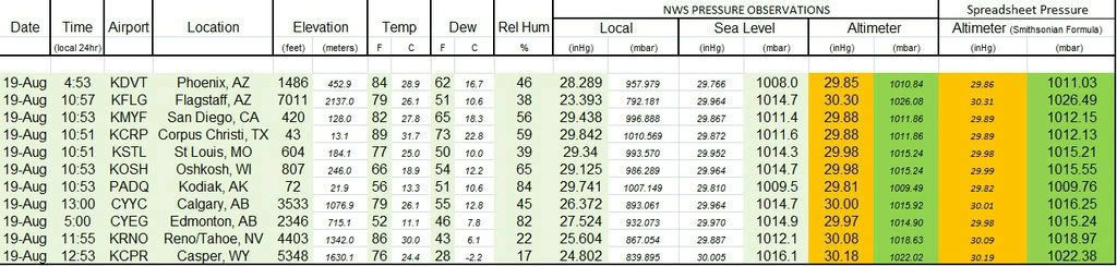

I spent today pulling some NWS observations from various locations in North America with a significant spread of altitudes, temperatures and humidity levels. I've posted those observations below. The data in regular text is the observed values reported at each NWS station and the italic text values are values I calculated. You'll want to compare the last columns (orange to orange and green to green) to see the difference between the altimeter formula and the NWS altimeter calculations.
(If you don't see two orange columns and two green columns, the full image is here...for whatever reason I dont always see the full image posted here even after resizing the photo.)
http://i33.photobucket.com/albums/d82/N ... ations.jpg
From what I can tell, the differences between the NWS reported value for altimeter vs what the spreadsheet altimeter formula calculates appears to be due to rounding and the use of significant figures from within the spreadsheet...in other words, this is likely as good as its going to get without a few formula and constants tweeks.
Boris, unless anyone else sees issues with the formula or the results it produces, I think you've got it nailed down.
