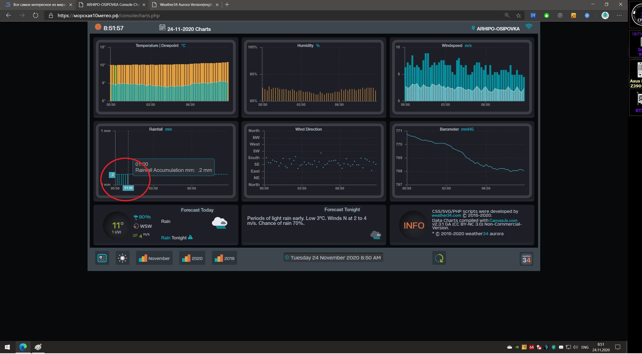

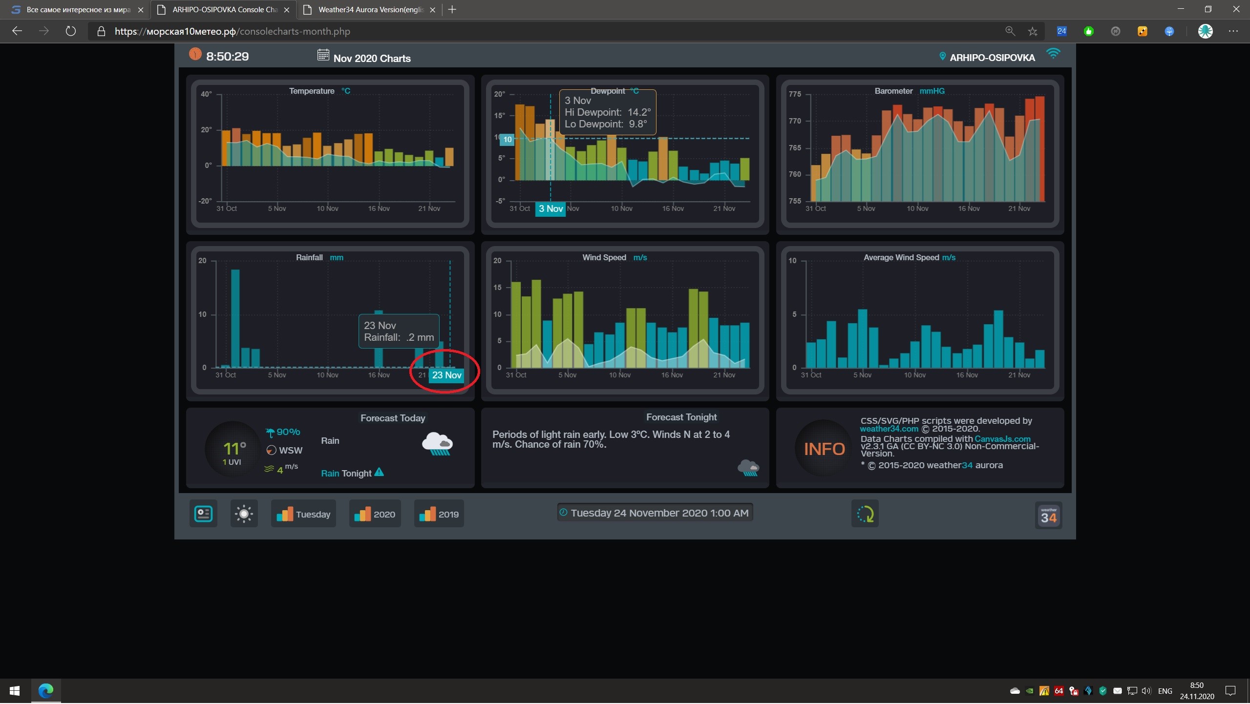

Hi, Brian!
It's not the first time I've noticed an interesting thing. Here is a real example: on 23.11.20, the total amount of rain per day was 0.2 mm. It is November 24, and when you open the trends for the current month, picture # 2 shows the daily precipitation figure for 23.11.20 after 00: 00. And always exactly until 01: 00. In fact, there is no rain, the figure completely coincides with the total precipitation for the past day. The same number is not included in the monthly statistics for the current day.
- pic2.jpg (373.75 KiB) Viewed 4114 times
- pic1.jpg (377.36 KiB) Viewed 4114 times

good afternoon
I have seen this only once before that was a anomaly in meteobridge clock by a matter of minutes I recall we just adjusted the Lat Lon by a few minutes . if you look at your csv for 24 November you will see you an hour behind so perhaps something related to recent shift of clock by an hour it might be worth checking files prior to when clocks were due to change ??
.remember this data comes from meteobridge. I emphasize once again the template only reads and stores it does not control the output of meteobridge data it receives.
your data sent from meteobridge ..so at midnight for the next hour it was sending previous days total rain
0,00:00,10.1,1027.6,0.2,0,6.3,2.8,0,4.9,0.0,140.0,24.3,29,24 Nov,6.9,,70,0.0
0,00:10,10.1,1027.5,0.2,0,7.2,2.4,0,4.7,0.0,182.0,24.3,29,24 Nov,7.5,,69,0.0
0,00:20,10.0,1027.4,0.2,0,6.7,2.6,0,4.4,0.0,150.0,24.3,29,24 Nov,6.7,,68,0.0
0,00:30,10.1,1027.4,0.2,0,8.5,3.2,0,5.1,0.0,147.0,24.3,29,24 Nov,6.9,,71,0.0
0,00:40,10.1,1027.3,0.2,0,6.3,3.0,0,4.7,0.0,166.0,24.2,28,24 Nov,6.8,,69,0.0
0,00:50,10.1,1027.2,0.2,0,6.7,3.3,0,4.9,0.0,158.0,24.2,28,24 Nov,6.9,,70,0.0
0,01:00,10.1,1027.1,0.2,0,6.3,2.7,0,4.9,0.0,154.0,24.2,28,24 Nov,6.9,,70,0.0
0,01:10,10.1,1027.0,0.0,0,5.8,2.4,0,4.9,0.0,126.0,24.3,28,24 Nov,6.9,,70,0.0
as you say after 1am it is correct.
i will also check the script is not using 24 hour summary cant recall off top my head..
- Posts: 1824
I checked the script it is using the correct [rain0total-daysum:--] not [rain0total-sum24h] so the correct string is being used for the chart for current day and has been for years .so have a look at anything related to time in meteobridge settings thats all I can think of..

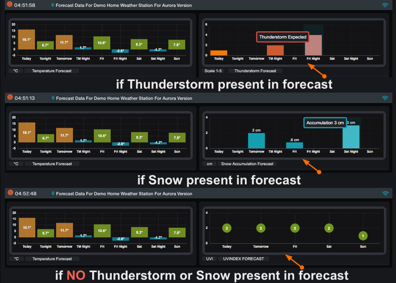

finally finalized the forecast page this morning 26th November.
the top right chart changes according to what if scenario
if thunderstorm present in forecast it will display the thunderstorm scale from 1-5 (which i think is intensity)
if snow present in the forecast it will display the snow accumulation value chart
if snow or thunderstorm not present it revert to UVINDEX forecast chart.
as per screenshot.
as per screenshot.

Looks great Brian,
Can I just ask what happens if in the period of the forecast what happens if snow and thunderstorms are in it?
