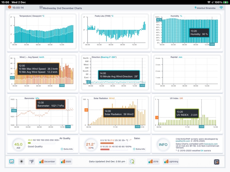

I hope all is well with you on the Covid front. I think the Thunderstorm/Snow/UV layout is an excellent compromise and the design is looks great! :D

simple update contains
request for contact icon ref Gary.
tooltip makeover in main charts.
windchill / heat index seasonal option for small modules simply select appropriate option if you want to use according to your current season.
fireindex ref monitoring Gavin site (SW Australia)
fix kmh wind forecast value output ref Gavin
fix metric snowfall value WU sends metric cm value when either UK or metric option is chosen
add more info link in small moon phase module
