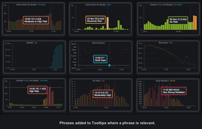

simple update aurora-simple-update-03-12-2020.zip
Gains of not dealing with languages this update add phrases to tooltips where relevant in various charts .

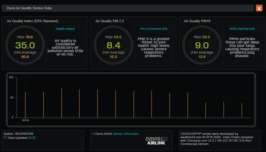

Brian, an odd bug has appeared with the chart for Air Quality caused by negative air temperatures.
My AQI chart had data gaps where the outside temperature went into negative values. As soon as the air temp went back to positive the chart correctly parsed the data.

The orange AQI correstponds from 00:00 to 01:30 and the green from 10:10 onwwards.
Not sure why a negative temperature should be mucking the graph about.
Jason
Thank you Jason think thats what you call "just in time" as I was just about to push an update.
cause was the air quality script was an original code line from when using luftdaten API using position 2 .
now its via meteobridge API its position 18 so if ( rowData[18]>=0) is now correct
it was unfortunately using if ( rowData[2]>=0) which is temperature in the meteobridge API , so classic seasonal scenario getting missed never appears in the warmer months .

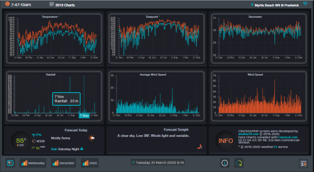

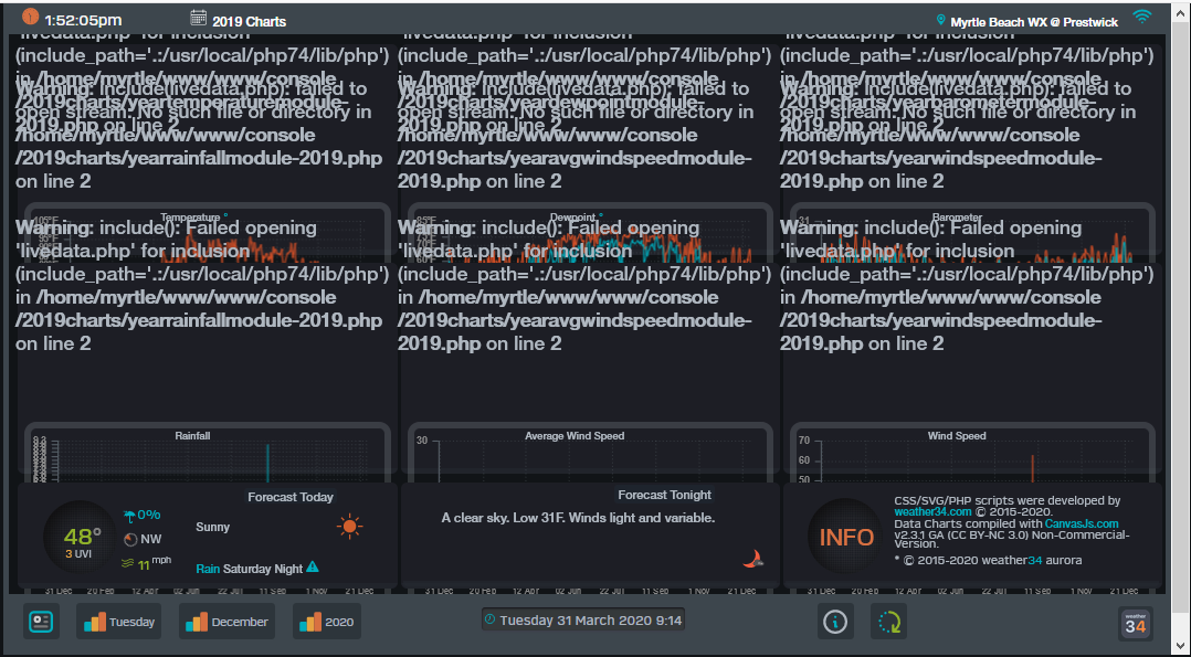

I have a little issue with the latest update in the 2019 charts. Looks like it may be a path problem. Also, the latest version of the consolecharts-2019.php is not on Git. I did see it in the Weather34 Update Zip file. Maybe some others that are different, as well.
Hope all is well.
hi chuck sorry about that i was trying to help someone out last night their server had some strange path configuration and i ended up falling asleep.. hopefully both are aligned now.
No problem. I updated and the data seems to be there, but I notice the date at the bottom seems off. :?:
Hope all is well.
i cant see anything wrong in the simple script , its simply reading the filemtime , which could be when last edited , when uploaded to server.it basically a timestamp set by server.
OK. That makes sense. :D
