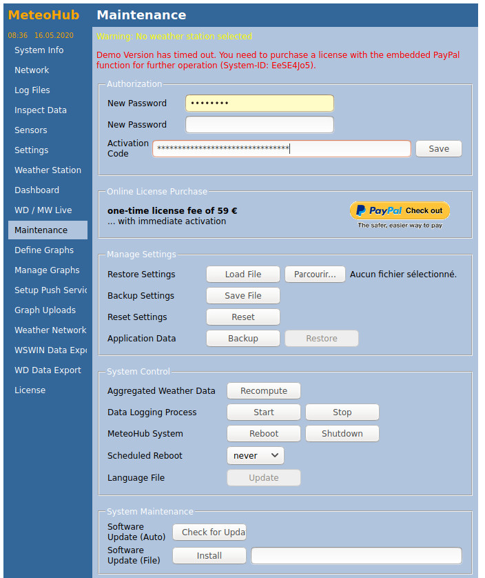

http://192.168.0.6/cgi-bin/meteohub.cgi leads to the joined page image.
Tell me please how to connect to the page shown in the manual at page 70 https://www.meteohub.de/files/meteohub-v4.7en.pdf.
- Capture d’écran de 2020-05-16 08-41-33.jpg (167.44 KiB) Viewed 16132 times

The “ joined “ page you show is the Maintenance Page. You must have already checked the box on the page shown on page 70 in an earlier step.
You’ve almost completed your activation !!. Only one more step remains. Now, click on the Box marked Activation Code and then hit the delete key on your computer to remove all of the symbols currently in the Activation Code Box so it is completely empty or keep using your backspace key until the box is completely empty if the delete key doesn’t work.
Then carefully enter the Activation Code you earlier carefully copied down from the Transfer Webpage making sure you get it exactly the same. Press the save button next to the Activation Code Box and your Meteohub should be activated.
Please, Do not attempt to Update your Meteohub after it’s been activated as it will corrupt your micro SD card and you will have to start all over unless you now make a backup image of the installed and activated Meteohub image on your micro SD card using an image copy program as I mentioned before.
If the activation doesn’t work make sure that the system id shown on your “ joined “ page is exactly the same one you entered on the Transfer Web Page when you used it to obtain your new Activation Code.

It goes back to the same page over and over again when I press the "save" button.
System ID is the one I noted.
Activation code is the one I noted.
Password is meteohub.
Re: LEDs blink in Meteosheeva
You should leave both of the new password boxes empty. Those two boxes are only used for changing the default password from meteohub to something else ( See page 37 of the manual for a screenshot showing both of the password boxes empty ). You only need to enter your new activation code in the activation code box before you press the save button.
If this doesn’t activate your Meteohub then make sure that the system ID that appears at the top of the Maintenance page is exactly the same as the one you entered on the Transfer Web Page when you transferred your license from your SheevaPlug/Meteohub to your RPi/Meteohub. They still should be the same as the system ID generated when you install the meteohub image is tied to the micro SD card serial number contained in the internal micro sd card registries. This is why if you save an image file of your activated meteohub/RPi micro SD card installation and restore it to the same micro SD card it will remain activated, but if you copy it to another micro SD card you will need to do a license transfer to reactivate the new micro SD card installation.
If for some reason they don’t match exactly, your activation code won’t work and you’ll have to do another transfer using the system ID From your RPi/Meteohub that you used when you did the license transfer on the License Transfer Webpage as the “ old “ system iD, the one that is now at the top of top of the page as the “ new “ system ID and the activation code you received from using the Transfer Web Page as the “ old “ activation code. You only need to do this if for some reason the System ID that you see now at the top of the Maintenance page is actually different than the one you entered on the Transfer Web Page when you obtained the new activation code you are entering in the activation code box on the Maintenance page.
