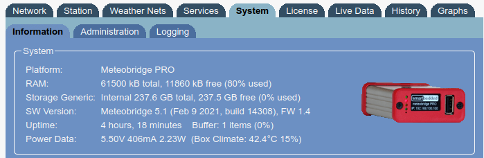

I have an update on this experiment. I had a failure today, but it was NOT the memory card, it was the USB card reader that failed.
I pulled the card and reader and put it in my computer. A filesystem check found nothing wrong, so I tried to run a benchmark on the card. Almost immediately after the benchmark started, the USB card reader disappeared from the system, and the benchmark failed. I put the card in my main reader, and it worked fine. I found another card reader I had bought, and it worked fine in that as well. It is now back in the meteobridge pro and working again.
This is the reader that failed: https://www.amazon.com/gp/product/B07RS ... UTF8&psc=1
