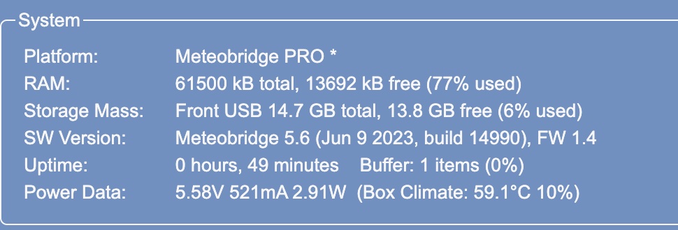

This is shown now.
2. what do you need a cable for ? :roll:
Well, I didn't know that you could replace yourself the inside memory. I didn't see that video before....
I bought this:
https://www.allekabels.nl/searchresult. ... rd=1258217
to backup on the backside.
and this:
https://www.allekabels.nl/searchresult. ... rd=1286156
to connect to the frontside and backside. Next step is moving the database to the frontside. The cable coming from the back seems to be a bit tricky and less reliable to me.

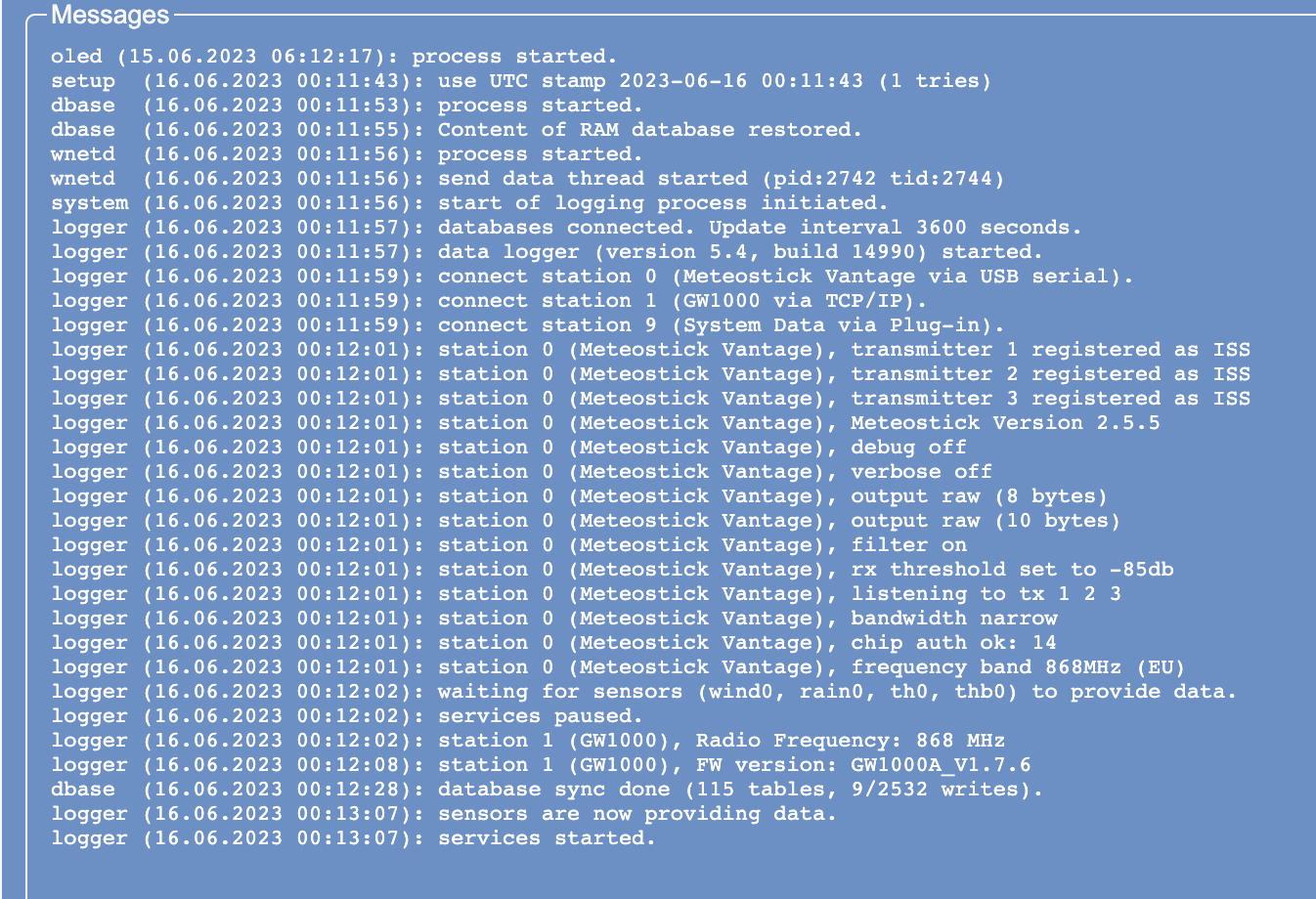

It happened again last night, like all nights:
Schermafbeelding 2023-06-16 om 07.14.24.png (401.8 KiB) Viewed 2442 times
Schermafbeelding 2023-06-16 om 07.07.54.png (53.22 KiB) Viewed 2442 times

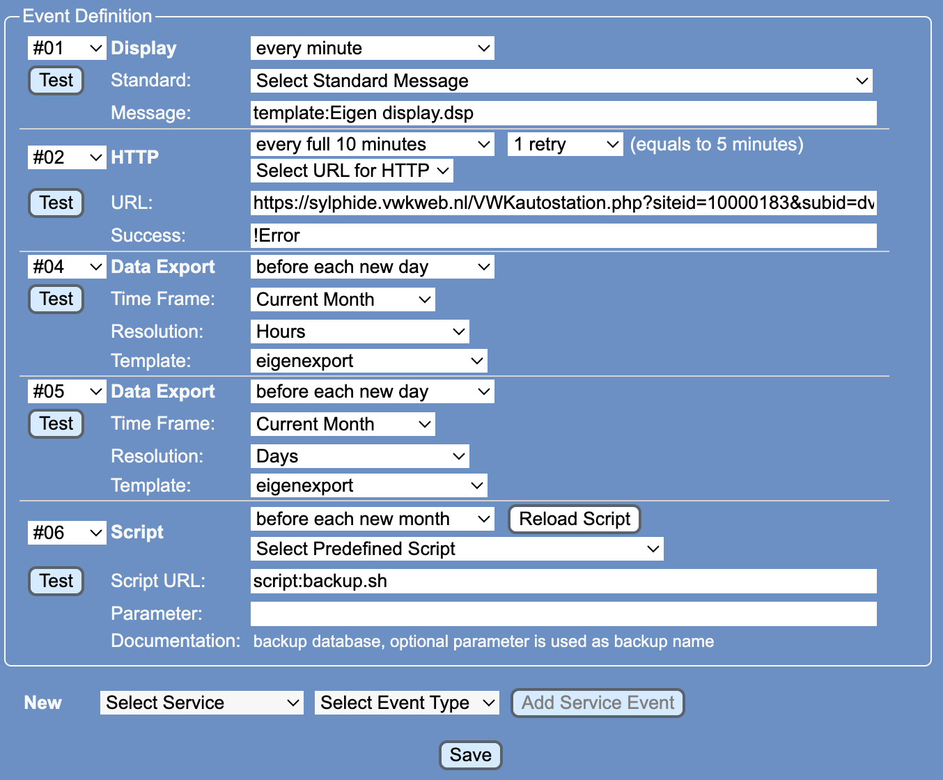

These are my events:
Schermafbeelding 2023-06-16 om 07.10.54.png (233.1 KiB) Viewed 2442 times
Only thing done every midnight is making two export files of the day and month.
And yes, I have selected 'get newest on boot' .

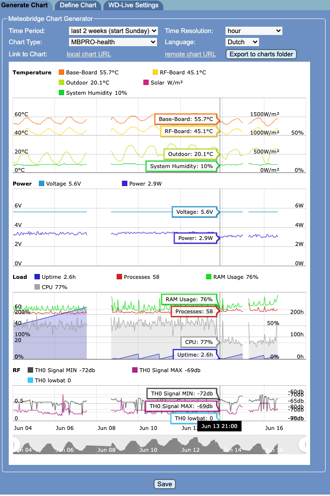

I suggest you create yourself a customized chart showing the CPU load and device temperature - and check what it shows over the past two days and week. If these values are rather high an unscheduled reboot becomes likely due to a system overload. Unfortunately the syslog of the MB gets deleted at a reboot and starts newly from scratch again, so such a script is the only way to find out ...
you can try to match such a chart with the gaps in your sensor readings
I had this myself (too many stations/sensors) and my final solution was getting a RaspberryPi install and move the multiple stations with all their sensors there. No issues ever since. With permanent one minute values. Whenever the system was overloaded a reboot occurred. Boris (the MB developer) checked that with such a script and a hardware upgrade was my only way out.
TonvG
Posts: 27
Joined: Fri Jan 14, 2022 7:29 pm
Re: MB-Pro internal 1 GB USB storage
Post by TonvG »
There is such a graph default in MB I saw. The laste 2 weeks:
Schermafbeelding 2023-06-16 om 17.12.25.png (182.62 KiB) Viewed 2413 times
Some things from the graph.
It is warm in The Netherlands the last weeks, as well as in Germany. Resulting in even higher system temperatures.
Daily restarts since June 9th
CPU load was really high when the system ran out of memory. Much lower at the moment 1 GB was replaced by 16 GB.
RAM usage has gone up a bit it seems.
Conclusions? I can't compare to other systems, but high CPU load doesn't look good to me. Should be better now I think.
