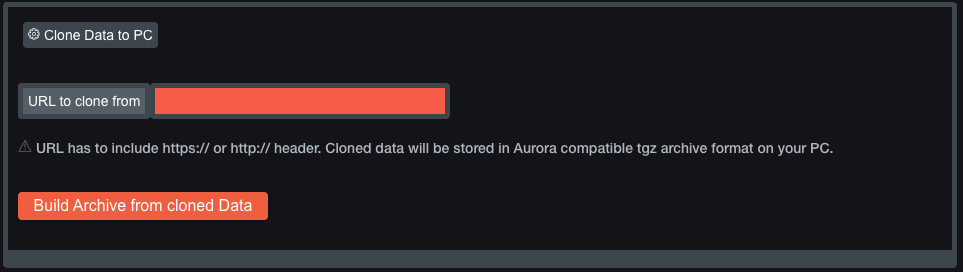

New Aurora Master and Update archives have been built. When you install the Update on you local Aurora install it includes a feature that allows your Meteobridge Aurora Cloud install to read history data from it.
Goto this section on your Meteobridge Aurora Cloud setup. Direct this cloning feature to your existing Aurora site and an archive of the data will be stored on your PC.

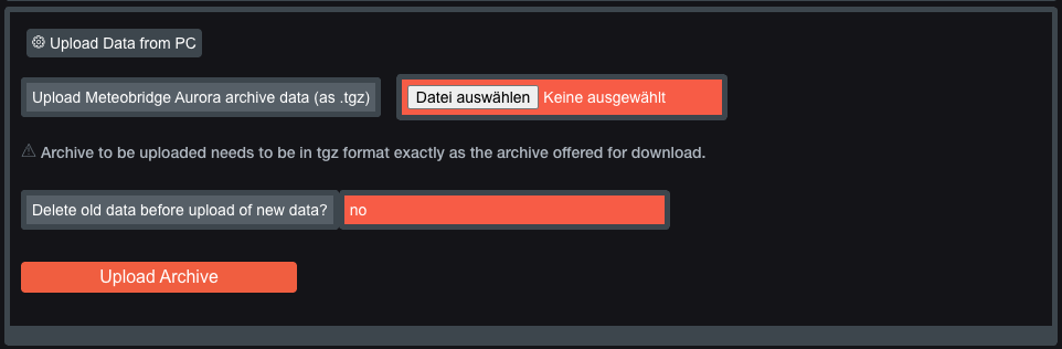

Having downloaded the archive to your PC you can Upload the archive data to your new Meteobridge Aurora cloud install

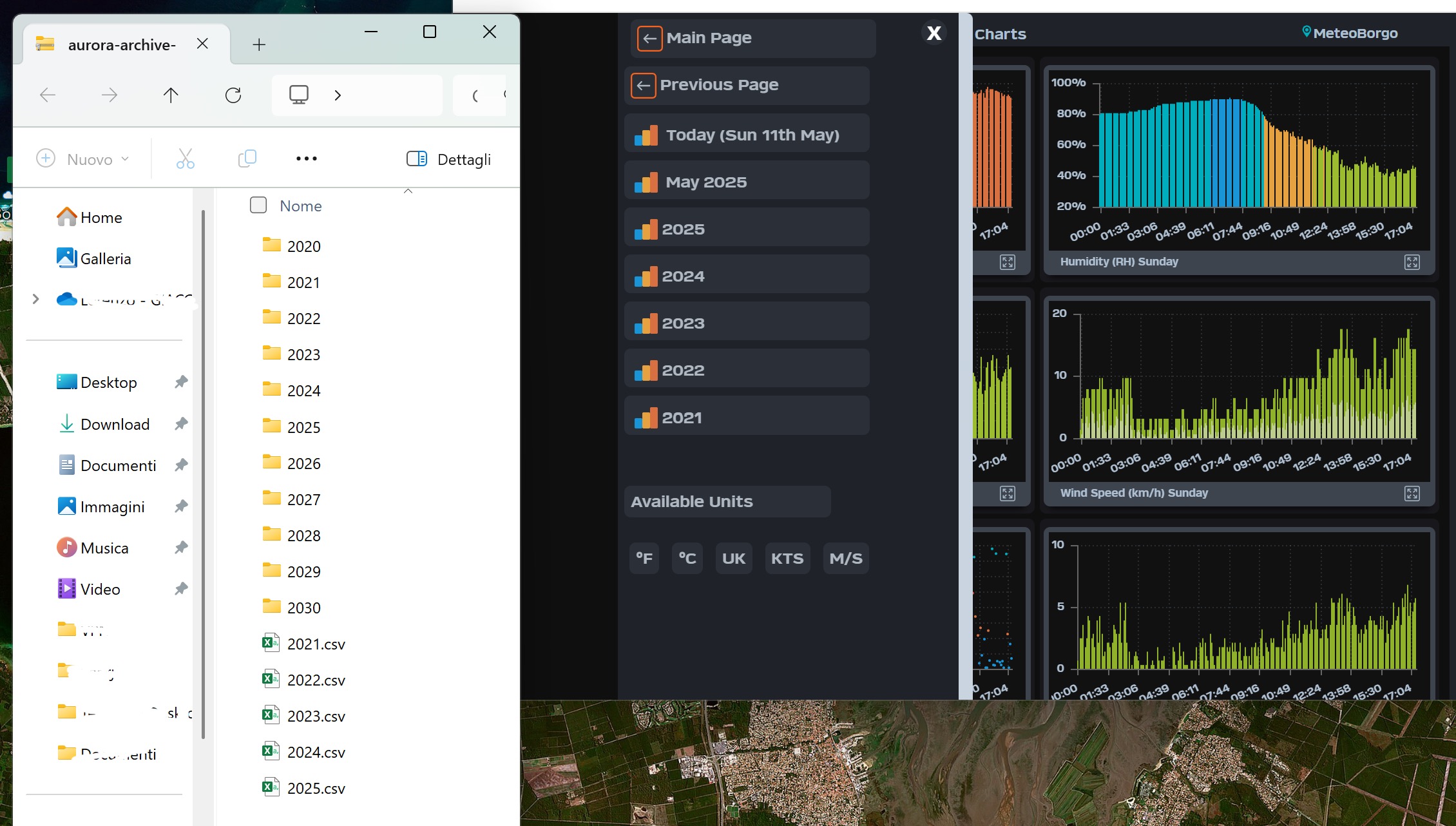

Yes, I did all this but the download from the local version was always 0 bytes so I used filezilla.
Then I compressed everything into tgz format and uploaded it to the new Aurora, everything works for me.

I officially give up (with One.com). I managed to get the archive to work. I downloaded the archive data and went into the cloud version to upload. I got the error message Error: Upload of new data failed (file too big according to php limit). I assume this is yet another limit that my hosting company is putting on me. The size of the archive file is 5.3 mb

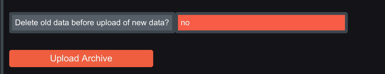

I had the same problem. Try uploading one year at a time. Leave “delete old data: no”.pwilman wrote: Sun May 11, 2025 9:01 pm Boris,

Lorenz1982,
Thanks so much for your advice. That worked spot on. I now have all of the archive data from my local install, back to 2019 uploaded to my cloud install. I am finally a very happy man.
