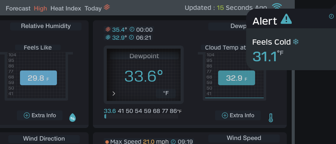

A small bug. It's simultaneously cold and hot here today. It's an Imperial mesurement thing. Doesn't appear with ISO.
Screen Shot 2021-01-01 at 4.08.47 PM.png (134.16 KiB) Viewed 5561 times
Also, I do like having the webcam on the index/home page. Unfortunately, that leaves a blank spot on the almanac that might be able to used a different way in the future? You can see this on my site -- cam is position 9. https://bollar.org/wx/weather34/weather34-almanac.php
can you please pm the password to setup screen which you can change at anytime .. i have an inkling of what is causing heatindex to show
found the heat index appearing another piece of stray code leftover . latest update 02-01-2021 fixes that ..many thanks .

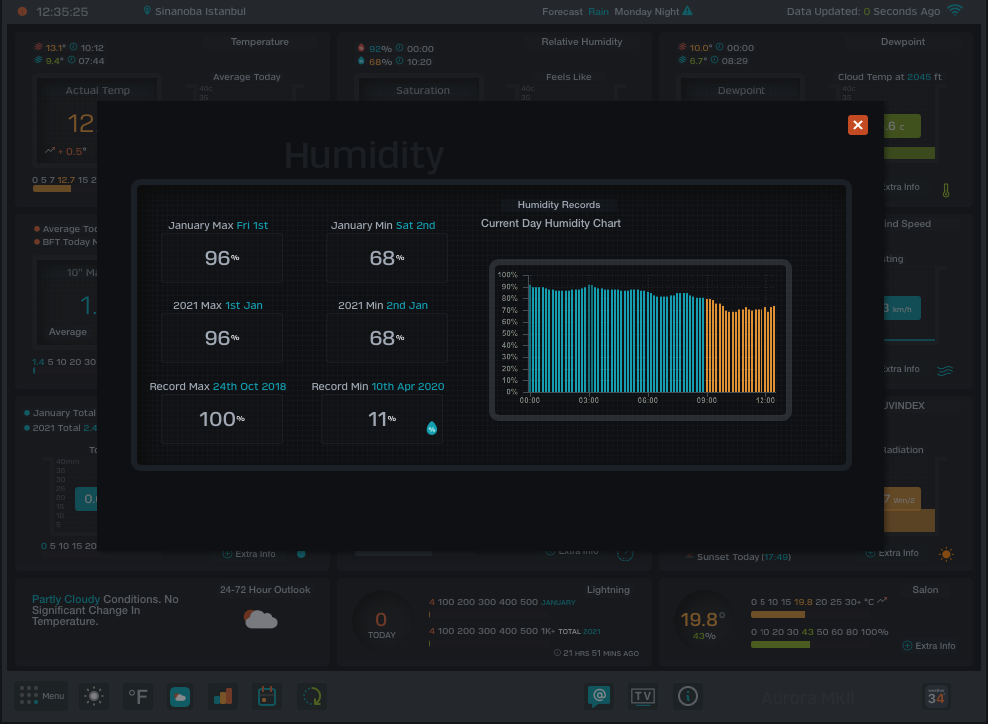

Aurora MKII 02-01-2021 update adds additional chart to extra info screens in MKII version.just run simple update thats it..
these additional features are not available in MK1 version .
also the almanac screen will contain more data towards the end of month , but caution the extra almanac data will not work with meteobridge TP-LINK type devices . so this needs some thought on how to smoothly implement . please be patient it will come just needs focus .
Screenshot at Jan 02 12-35-31.png (160.29 KiB) Viewed 5533 times

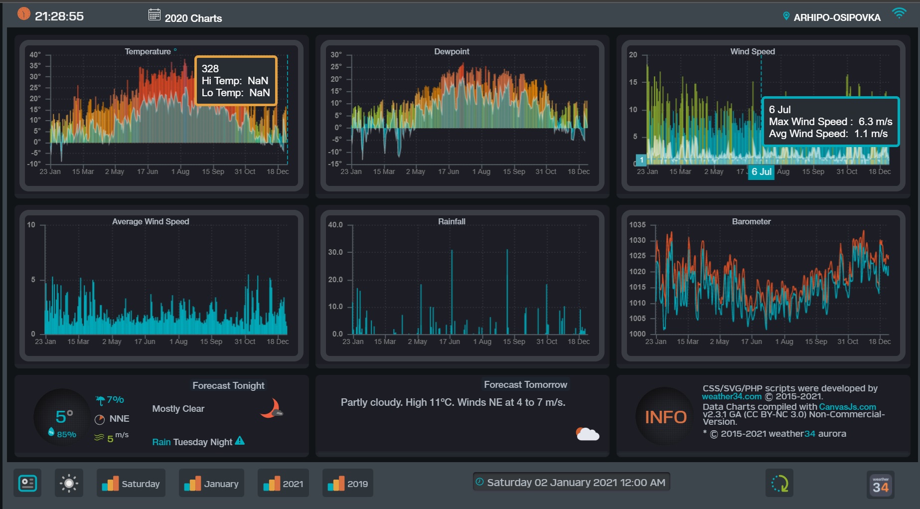

alexeysailman
Posts: 87
Post by alexeysailman »
Hi, Brian! Still, as in the attached picture, after installing the last update, nothing has changed. The last entry at the end of the year on the top left trend is " nan"

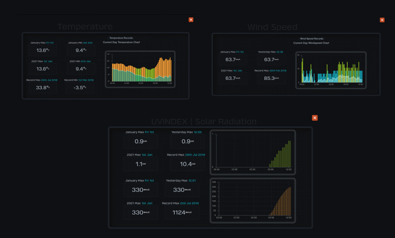

The latest update for 3rd of January for the Extra Info screens seems to have broken them
If you have a look at my site you will see
http://ringwoodweather.ddns.net/Aurora2/index.php
Graham
Hi Graham your site always has a fixed css cache issue Ive noticed this for many months . it often takes an hour or two to recognize new CSS thats one of the reason I dont use your site to check for issues . I cant confirm if its a cache server level setting or it just doesn't immediately react to file changes . I did raise this to you many months ago when I had FTP access it often sent me round in circles unfortunately only to find there was a server cache or similar in use perhaps a hard setting in the .htaccess file .

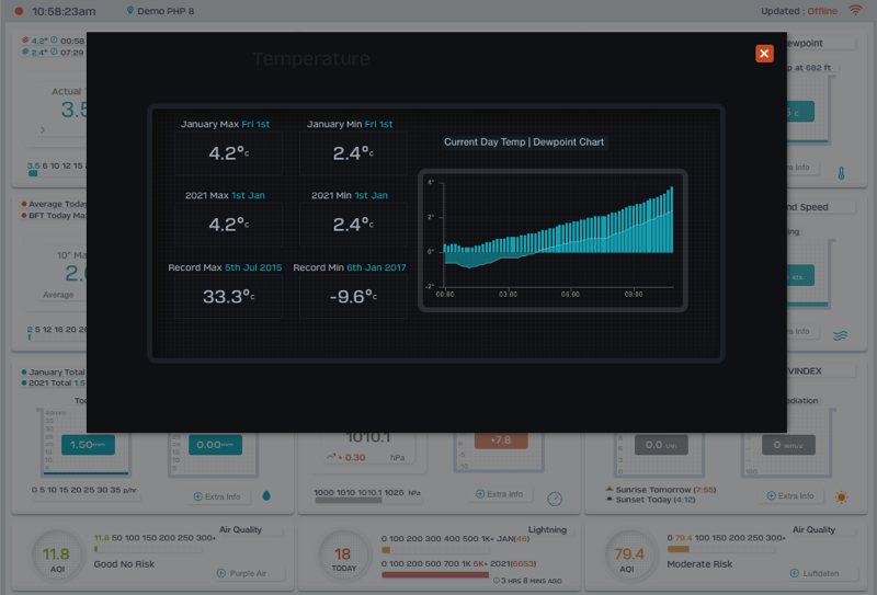

if place your current day chart csv http://ringwoodweather.ddns.net/Aurora2 ... an2021.csv into my local demo
I get this in screenshot below .. I hope that helps somewhat..
edit.. I can confirm you are NOT reflecting new CSS dark file as I type has there is a new set of lines not present that begin with @media screen and (max-width: 760px) {
which was only added this morning and wasn't present in any previous releases.
you can see here at the time writing there is nothing related to @media screen and (max-width: 760px) {
http://ringwoodweather.ddns.net/Aurora2 ... 1609669330
