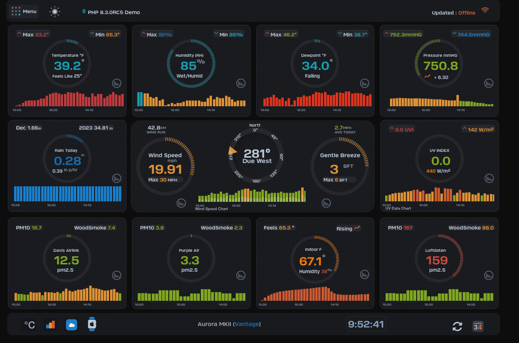

ToTo wrote: Fri Dec 29, 2023 7:37 pm Ideas? of course ;-)
+ The diagrams for the air quality in Theme 8 are still missing.
+ We now have a lot of themes, it would be nice if the currently selected theme number in the menu could be identified with a different color.
+ The menu in Theme 8 overlaps the footer.
+ The font size in the menu changes between different themes, I find the font size in the menu of Theme 5 suitable?

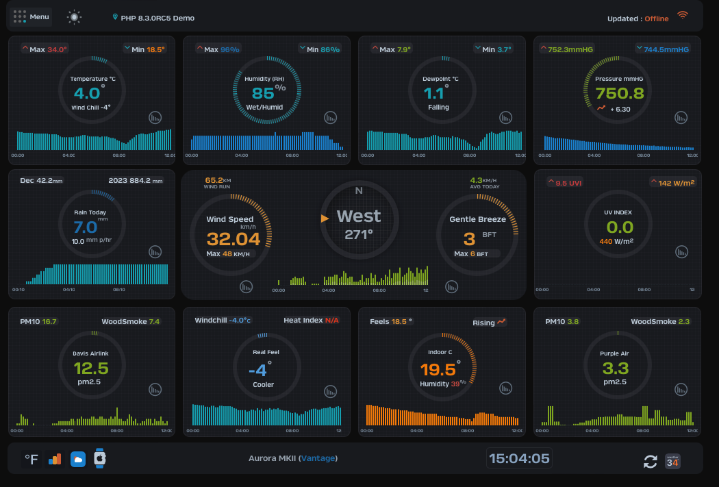

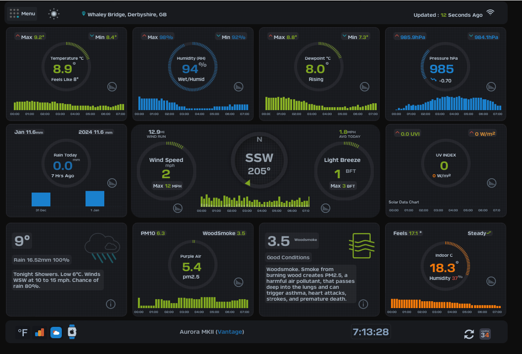

good morning ..patience is a virtue the AQ charts are there just need to compile a Luftdaten and Indoor chart output.. unfortunately not all bottom modules have a chart data to use .
pass on the color identifiers for menu..
theme 8 menu overlap fixed (z-index:1)
font sizes will standardise the menu font size across layouts.
aq charts so far below
Torsten here we go or see demo https://whaleybridge-weather.com/weathe ... yout-2.php ,note no chart data for woodsmoke without compiling new scripts to use the woodsmoke formula

Good Morning,
i check the demo https://whaleybridge-weather.com/weathe ... yout-2.php
looks good
+ Menu Fonts und Color identifiers i haven't noticed any changes yet, will there be?
+ Refresh button on theme 8 switch to theme 7 :wink:

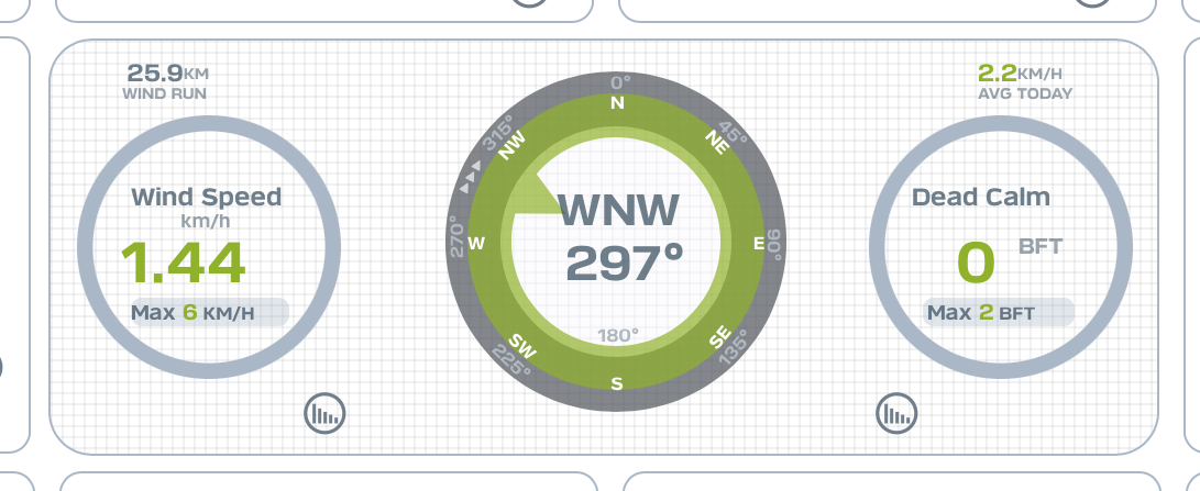

+ Text "wind speed chart" and "solar data chart" are too close to the chart legend (is the text necessary?)
+ perhaps adjust the size of the Windspeed and BFT modules to the other modules?

1. menu takes time slowly being done need to check IOS iphone perhaps tomorrow.sorry no color identifiers .
2.fixed
3.fixed
4.in the future :-)

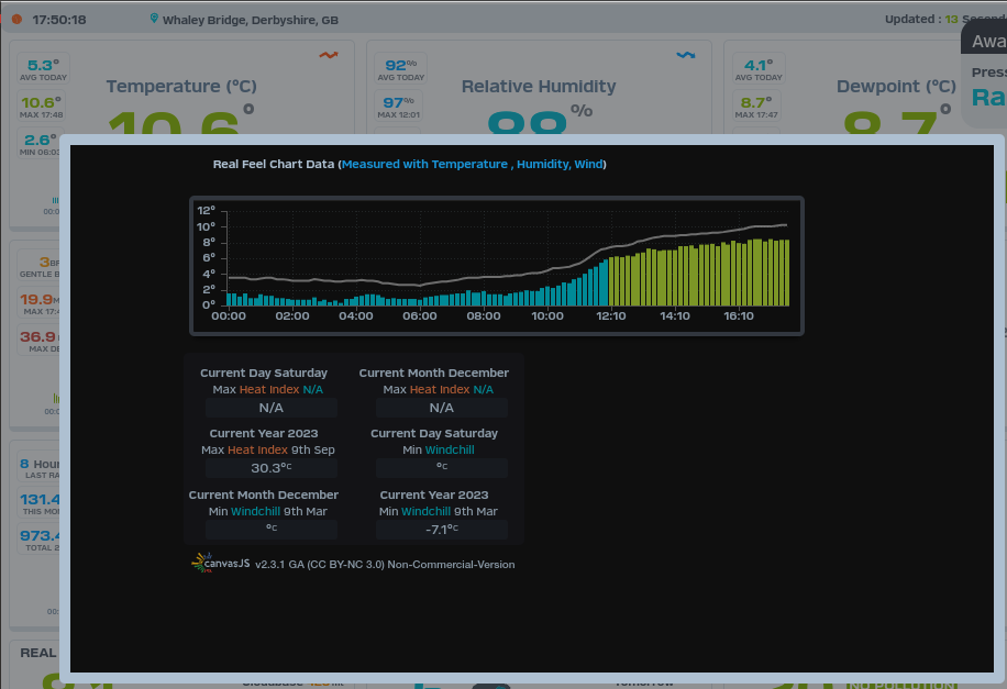

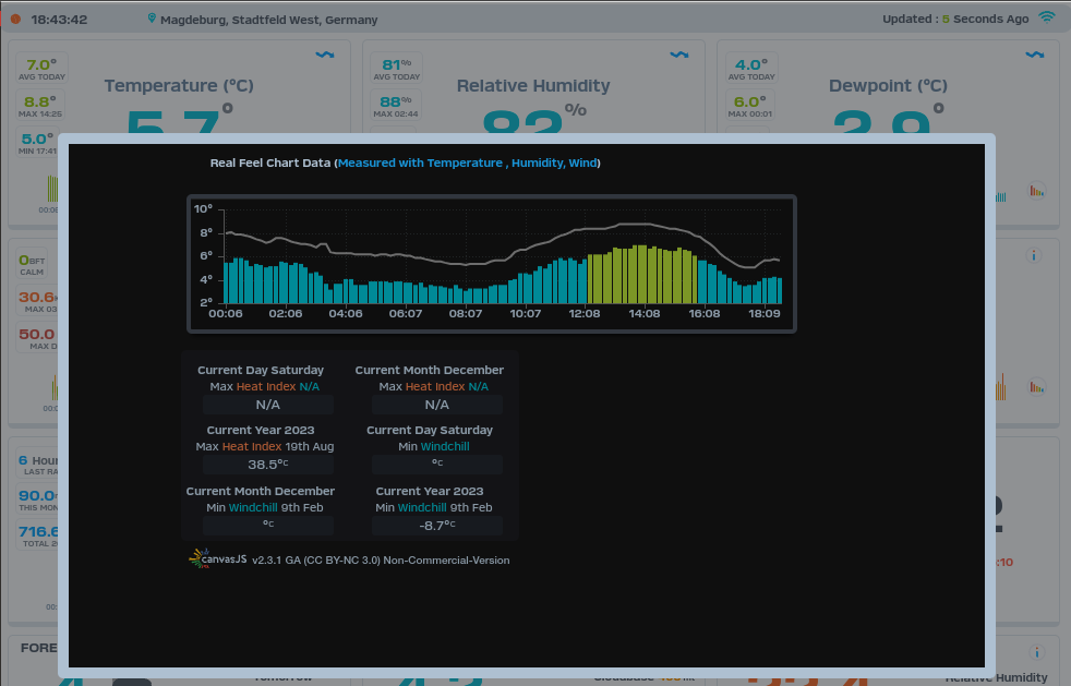

Hello everybody,
I have seen that when implementing the new template (2024) together with Weather34-simple-update-2024-R2, all the data regarding Heat Index and Windchill do not appear.
At first I thought it could be due to a mistake on my part in the configuration of the website, but I have been observing other servers that have the same template and the same thing happens to them.
Some examples are:
https://wetter.de.cool/console2/weather34-os-tablet.php
https://whaleybridge-weather.com/weathe ... tablet.php
https://singaporeweather.info/weather34-os-tablet.php
I take this opportunity to congratulate Brian and the people who help in the development of this software.
Greetings and happy new year.
Manel
Manel wrote: Sat Dec 30, 2023 8:12 pm Hello everybody,
Some examples are:
Manel
Good afternoon Manel

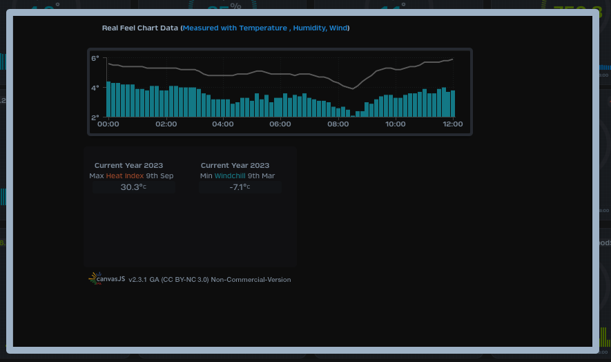

thank you for the observation , unfortunately the heat index,windchill current day /month max data were removed from the API many moons ago I just forgot all about it , they were removed to cater for others like air quality data , the API is maxed out so it was a case lose something to add something.so i removed them see below..
anyway I have completely compiled a different compass approach basically simplyfying the whole thing , its nice to have all this detail but sometimes it just creates so much additional code when putting new ideas together so I really just created a circle border and simple rotating arrow that obviously rotates to a bearing .
part of the simple css approach
/*2024 weather34 compass very simple approach */
.weather34-compass-2024 {
  display: block;
  width: 100px;
  height: 100px;
  border-radius: 100%;
  box-shadow: 0 0 10px rgba(0, 0, 0, .35);
  position: absolute;
  font-family: 'verb';
  color: var(--body-text-dark);
  border: 8px solid var(--modulesborderside);
  margin-top:-80px;
  margin-left:-50px;
just a basic clean simple compass that blends in with design.
also the real feel module got a chart output .
streamlined removing the missing day/monthly max expected value areas.
have a wonderful new year all..brian

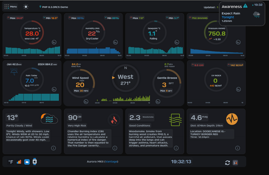

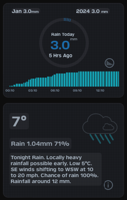

today

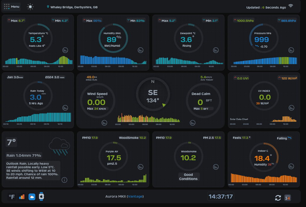

a rewrite on forecast module for theme 8 again just really simplified the whole thing .
also compiled a new set (50 or more new svg forecast icons for theme 8, similar to originals but just has outline ) .
theme 8 rain module now shows rain icon when its raining( station current rain rate greater than 0)
shown below or demo via https://whaleybridge-weather.com/weathe ... yout-2.php

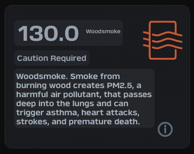

this mornings changes, Woodsmoke has there is no chart data I re compiled to look similar to the forecast module, think it blends better ?
have a good day brian..
demo at https://whaleybridge-weather.com/weathe ... yout-2.php

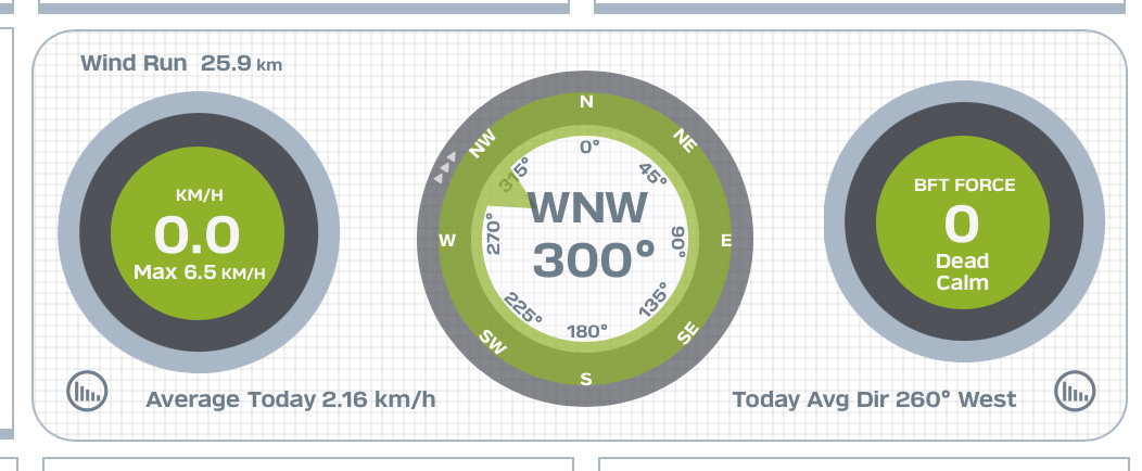

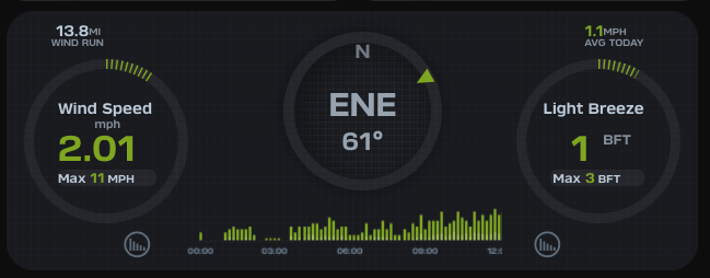

I noticed that in theme 7 is shown the “average wind speed” value unstead of the “wind speed” value.
MeteoBorgo: www.meteoborgo.it
lorenz1982 wrote: Tue Jan 02, 2024 1:05 pm I noticed that in theme 7 is shown the “average wind speed” value unstead of the “wind speed” value.
Hello Lorenzo , confused me ? its not easy but not sure which is incorrect ?
more progress to cater for those without air quality and have matching modules ..more to come .
Firerisk module now matches forecast , next will be heat index/windchill/feels
..brian

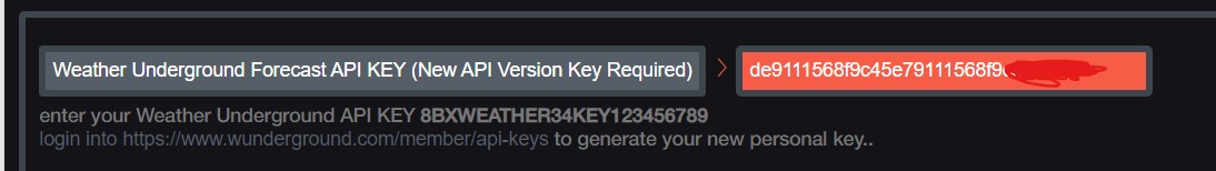

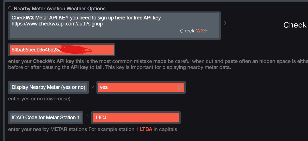

Hi Brian. For some time now I have had an error displaying the weather via the wu api key and the metar one. I bring some screenshots to try to show you what I'm talking about. I don't know what I can depend on, but it's as if the dashboard doesn't draw from the api keys. could you try to figure out what it could be?? Thank you

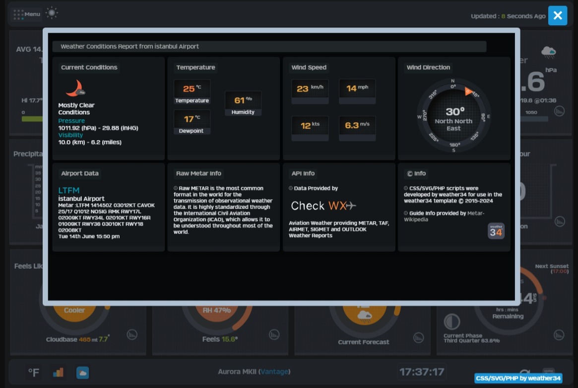

xxvincixx wrote: Tue Jan 02, 2024 6:50 pm Hi Brian. For some time now I have had an error displaying the weather via the wu api key and the metar one. I bring some screenshots to try to show you what I'm talking about. I don't know what I can depend on, but it's as if the dashboard doesn't draw from the api keys. could you try to figure out what it could be?? Thank you
I am also having the same issue with both Weather Underground and CheckWX. I tried regenerating and re-adding my keys also. The data remains from Istanbul instead of my area (Massachusetts USA) and the API usage on both sites shows 0. I installed the template just a few days ago, then applied the R2 simple update, then configured everything accordingly. Everything else works great! Love the UI!
