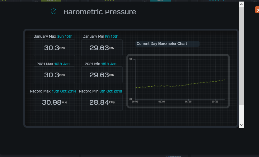

Do you remember my previous post? It was about the difference in atm. pressure readings between MK2 and the template from the meteobridge itself . I dropped two links to them. The very value of atmospheric pressure in the template, its maximum and minimum are not the same as on the console and in the meteobridge itself. Even after yesterday's update, the daily trends disappeared altogether.
https://xn--10-6kcwaznenhomt1p.xn--p1ai/index.php
https://admin.meteobridge.com/8f0945daa ... /index.php
sorry alex i cant help you .im more inclined to drop mmHg its obviously not working and im having great trouble following what your asking or highlighting and there is a quite long period between your responses often a week or weeks . to be honest i cant even remember your last issue .so my sincere apologies but I will remove mmHG in forthcoming update. unless you can provide some form of code i understand then ill quite happily help.
when you say trends do you mean charts ? if so barometer file had a missing code from yesterdays update please try this mornings update which also includes some preparation for new API structure .
the new API structure will provide better end of day for a universal use .it is noted from a few that the time of meteobridge just before end of day is not the same as server , the difference can be upto a matter of minutes or even seconds .it is not a meteobridge problem generally if there is any slight difference between hosted server time and meteobridge time then the end of day for month/year charts will produce an incorrect date . it is not a widespread issue but there are a few who have this problem so the new chart end of day will be required to be set at 00:15 therefore giving plenty of time to run the end of day without any crossover of dates . the new end of day basically uses the new api structure where it gathers the previous days Hi,lo,avg,sum at 00:15 so it won't miss any data right until midnight.

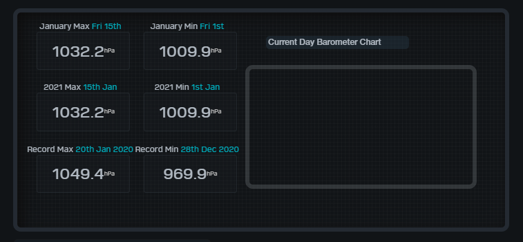

Brian, the MK11 todaybarometermodulechart2.php is not generating a chart.
I'm updated to 14th Jan pm-release. I think the problem is related to the added IF statement in the wrong place.
MKII has this code:
if(allLinesArray.length>0){
	if ( rowData[2] >-150)
		for (var i = 0; i <= allLinesArray.length-1; i++) {
			var rowData = allLinesArray[i].split(',');
				//dataPoints1.push({label:rowData[1],y:parseFloat(rowData[3] *<?php echo $conv ?>)});
				dataPoints1.push({label: rowData[1],y:parseFloat(rowData[3]*<?php echo $conv ;?>),color:WEATHER34CHARTCOLORS(parseFloat(rowData[3]))});
Changing it to this fixes the problem:
			if ( rowData[3] >0)
Jason

was fixed this morning see above post..
“ barometer file had a missing code from yesterdays update please try this mornings update which also includes some preparation for new API structure .”

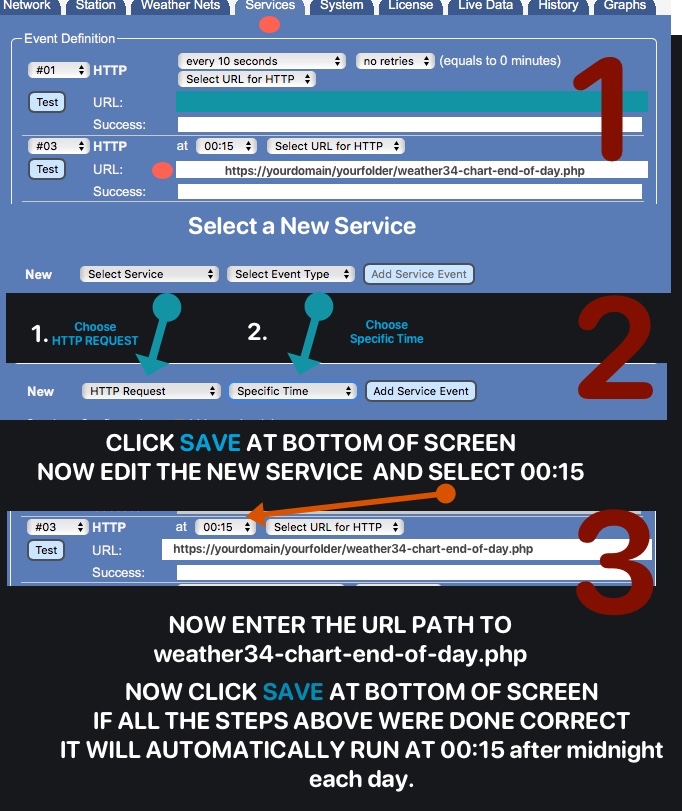

Jason the API all done Boris has updated the API a short while ago . for now MKII only it is a new file called weather34-chart-end-of-day.php that basically takes all of yesterdays hi lo , avg sum at 00:15 each day . Next week ill add it onto the Aurora MK1 as it also needs various new livedata.php code .
but here his the drift which I will push the update out later. its pretty straight forward 1,2,3 and save :-)
newchart setup.jpg (198.18 KiB) Viewed 4394 times

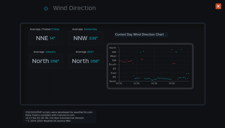

* Adds new wind direction info screen (2:15pm).

Setup New End of Day Charts Procedure
* Important First requires meteobridge reboot
*important existing users disable existing end of day service first !!
*new file for end of day weather34-chart-end-of-day.php
* Step 1 Goto services tab .
* Step 2 select service HTTP Request .
* Then select Event Type Specific Time now click save.
* Step 3 goto new service select 00:15 from drop down.
* Then enter the url example
* https://yourdomain/yourfolder/weather34 ... of-day.php
* now at the bottom click save thats it !!!.
* If added correctly it will automate end of day at 00:15am each day.
the chart output for current month and year are identical to previous all this update is doing is to insure there is no rollover of dates .it does
not effect your charts you have now the new file simply will append data to existing files.
once again thanks to Boris for promptly updating API numerous times yesterday :-)

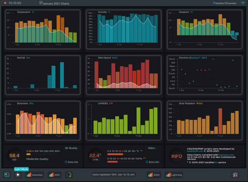

One browser anomaly that I have noticed, Scroll bars on Extra Charts (below) - I think occurred after adding the Charts credits. I am only seeing this on Firefox (Windows) and I have not tried it on Firefox MAC. Seems to be OK on the other browsers.
Cheers,
Hi Chuck thank you good old Firefox slips pass me again :-) ..just pushed a fix should be fine now .
Yes MKII is the way forward far more pleasant on the eye and to work with maintaining (theoretically !).
weatherist34 wrote: Sat Jan 16, 2021 7:32 pm Hi Chuck thank you good old Firefox slips pass me again :-) ..just pushed a fix should be fine now .
That fixed it! :D
