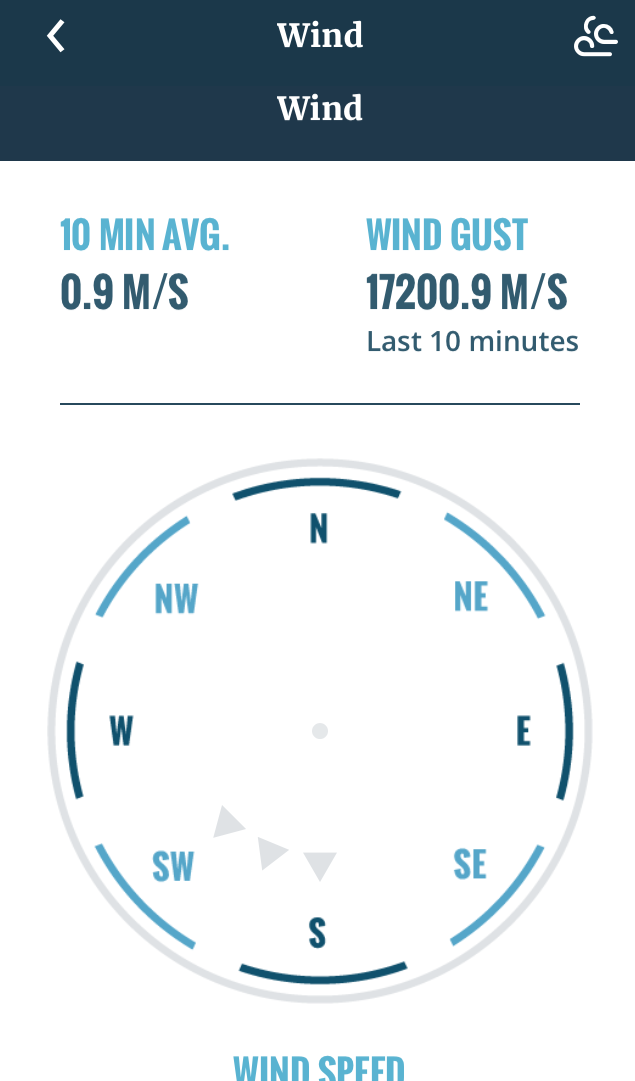

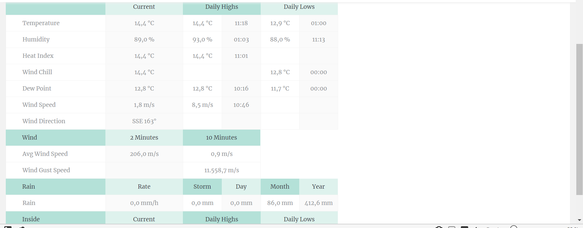

Hi
I don't know if this is the right place, but now I try otherwise Admin must advise.

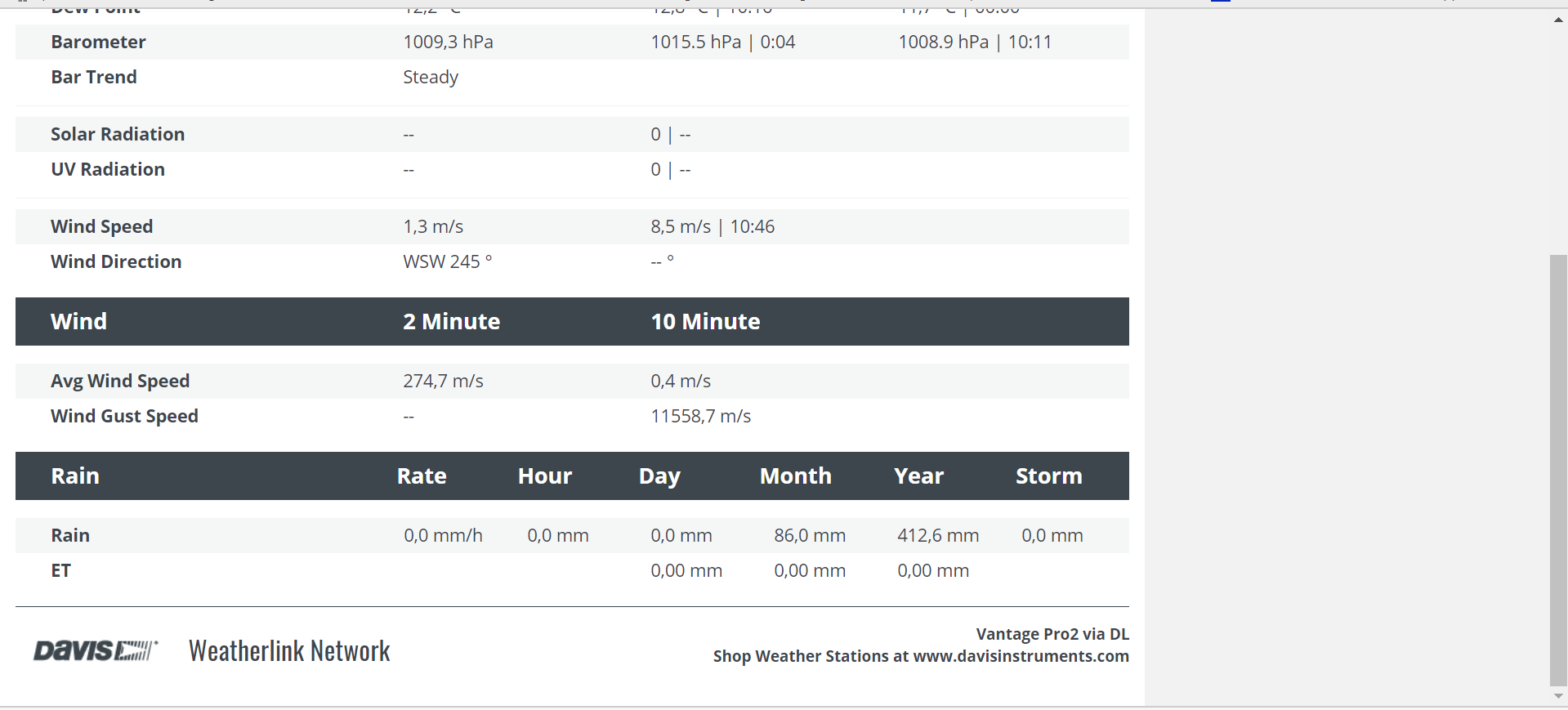

I've installed upload to Weatherlink via Meteobridge and it works really well. I also installed the IOS Davis Weatherlink App and it works fine too. The only thing that seems strange is Windgust, which seems pretty high!!
Are there any others who have installed the Davis IOS App and have problems with Wind Gust?
Any good advice where to start looking for this issue?
Rgds
Gert

gand
Posts: 46
Re: WL CLoud network support in Version 4.2
Post by gand »
Hi
Screenshot for the Summary. Strange Windgust as well
Gert
Bug does only affect Davis consoles with old firmware that does not support LOOP2 packets. It should be fixed with just released update.

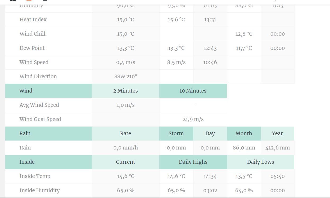

Hi
I have rebooted to the latest version and it's much better now, but still to high (or maybe there is an explanation)
In the summary I have 21.9 m/s gust. I can't recognise that figure from Meteobridge.
Rgds
Gert
Should be fine with just released fix.
@gand: Did update your MB and it now shows a 10 min gust around 1-2 m/s on WL.

Hi Boris
Thanks for your hard work, seems to work perfect now.
BTW, as soon as I'm close to the weatherstation (300 km away), I'll upgrade the firmware.

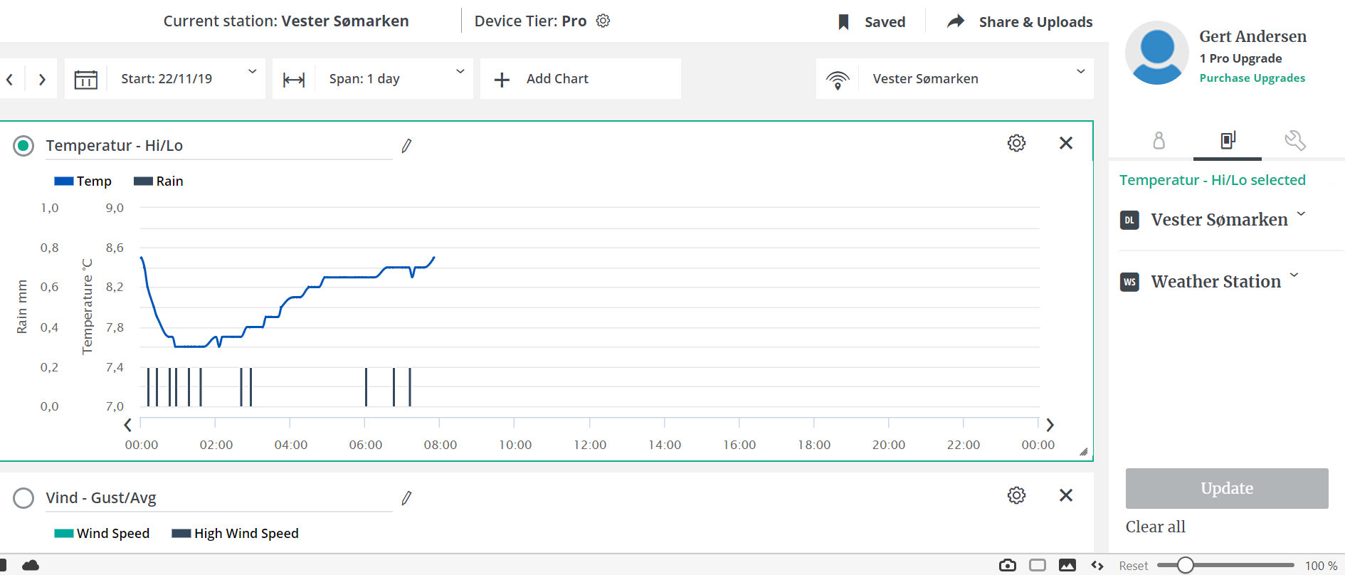

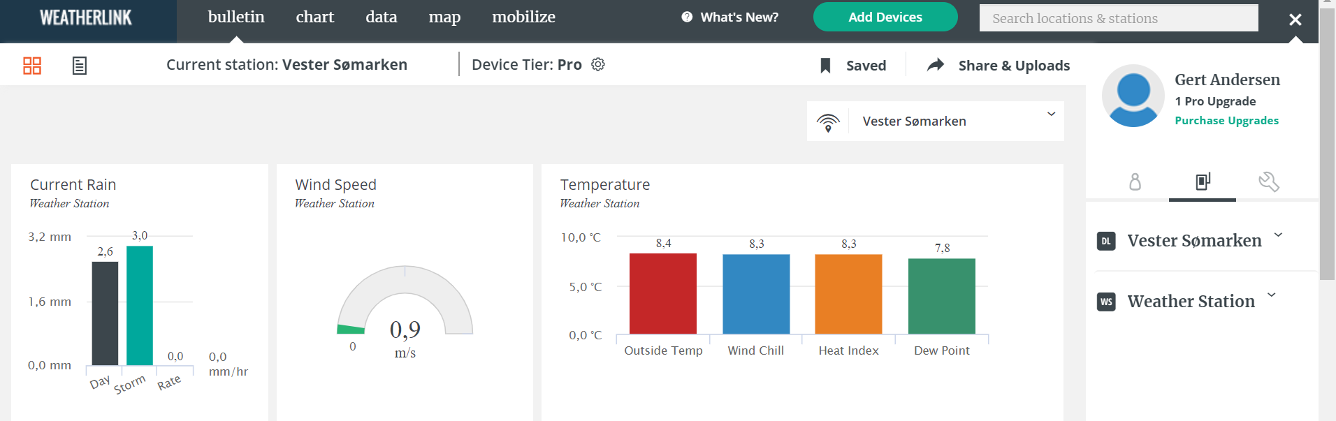

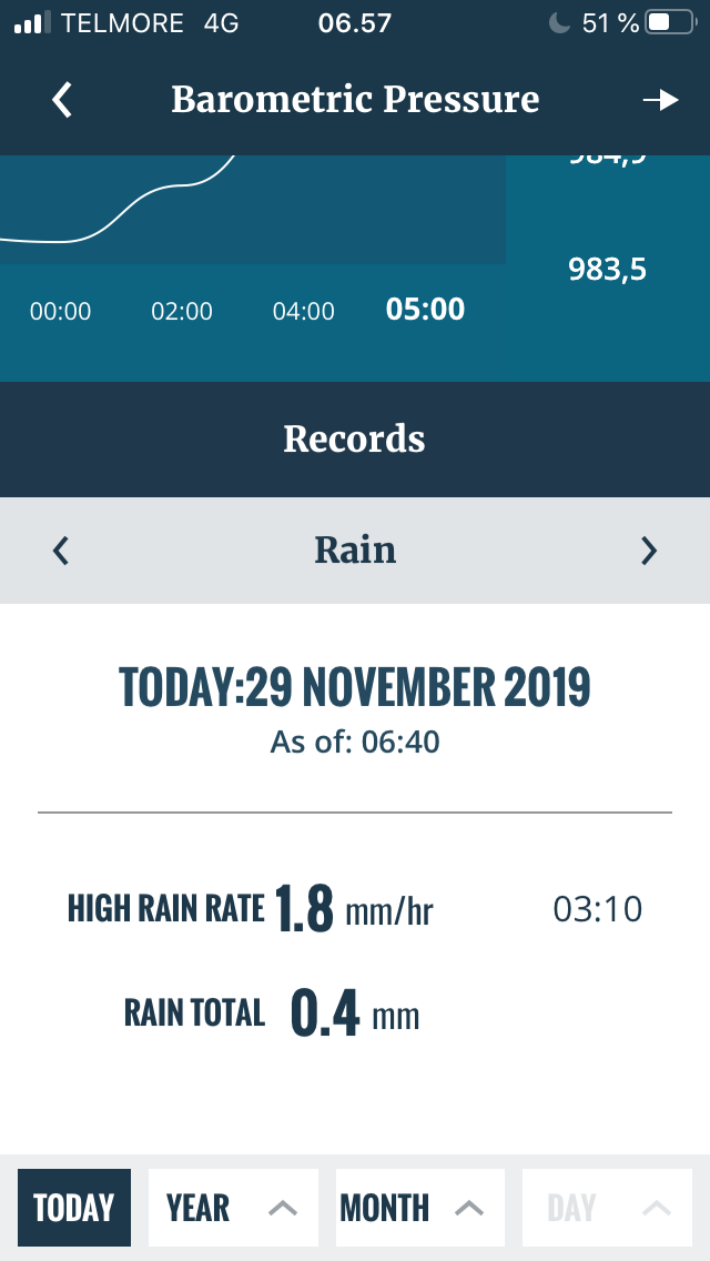

Hi

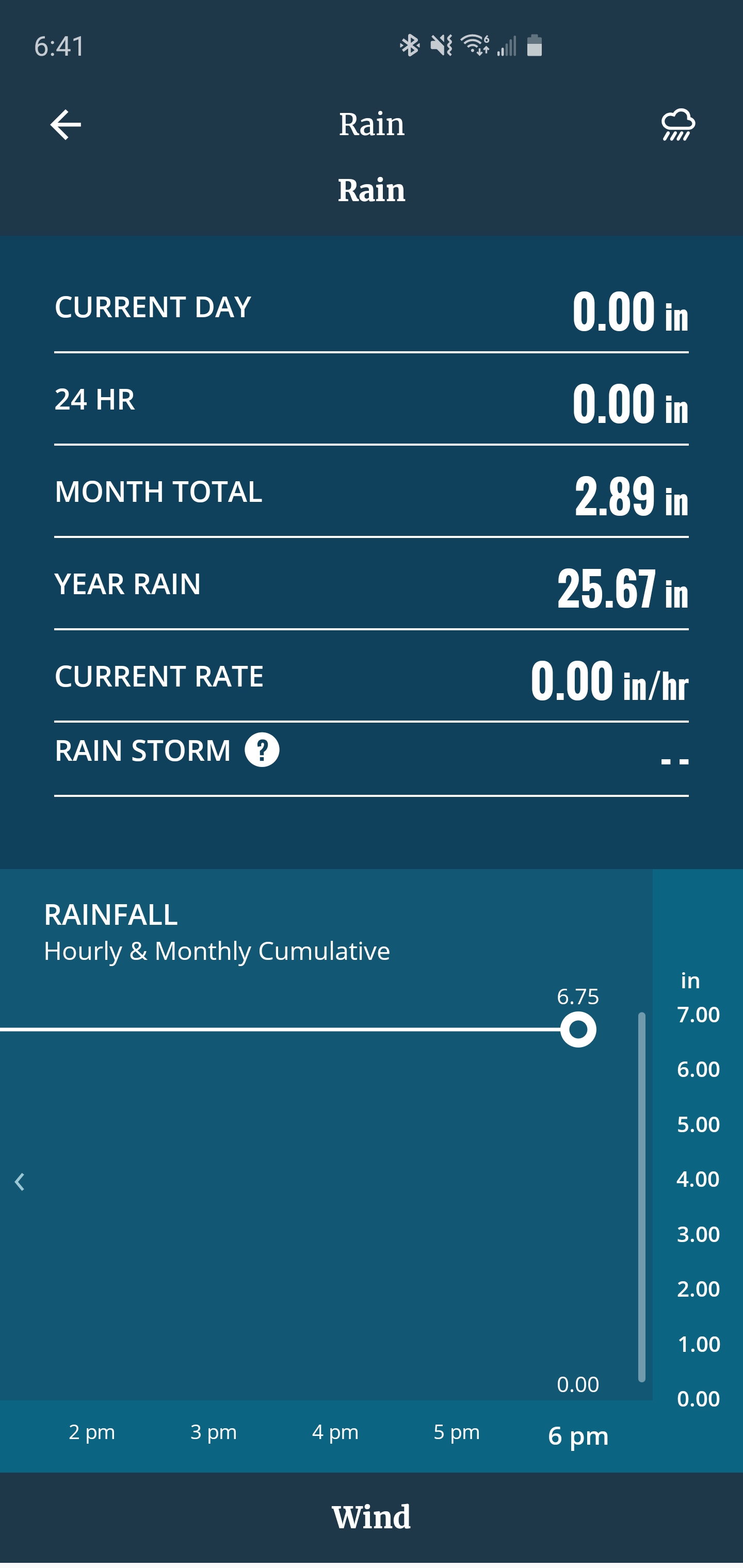

Hi
I have a question regarding rain. In the Weatherlink Bulletin the current rainfall shows 2.6 mm. If I look at the graph/data it shows 2.2mm (11 marks). In the data part there are also only 11 marks, each with 0.2mm. My console shows 2.6mm. Same thing with the Davis IOS app.
Is this a failure from the upload from MB or is it a bug in WL?
Any ideas?
I have upgraded the console to FM 3.80 using Loop2 packets.
Screenshots attached.
Rgds
Gert

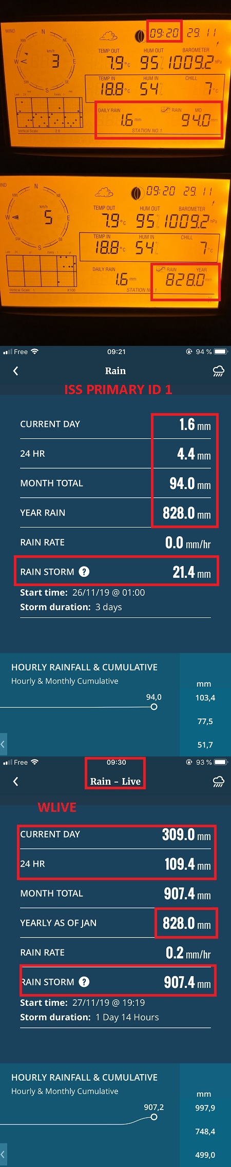

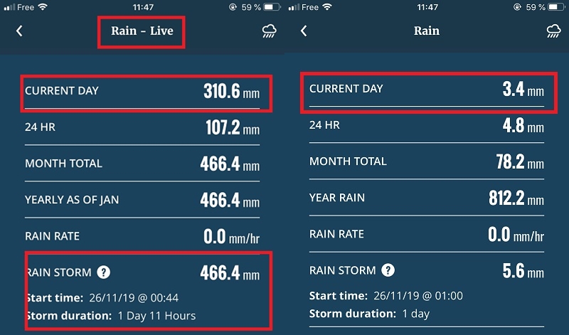

Hello
i have another problem on my side with my WWL device and the recording of the rain live ... most certainly a bug in reading the code that manages WLL precipitation!
3.4 mm recorded by my station against the 310.6 mm for the WWL :?: :?:
rain-live WWL
rain-live WWL
on the other hand no problem for my MB-pro and the report properly recorded and reported for example on the template WD34
http://valdefench57sgz.franceserv.com/pws/index.php

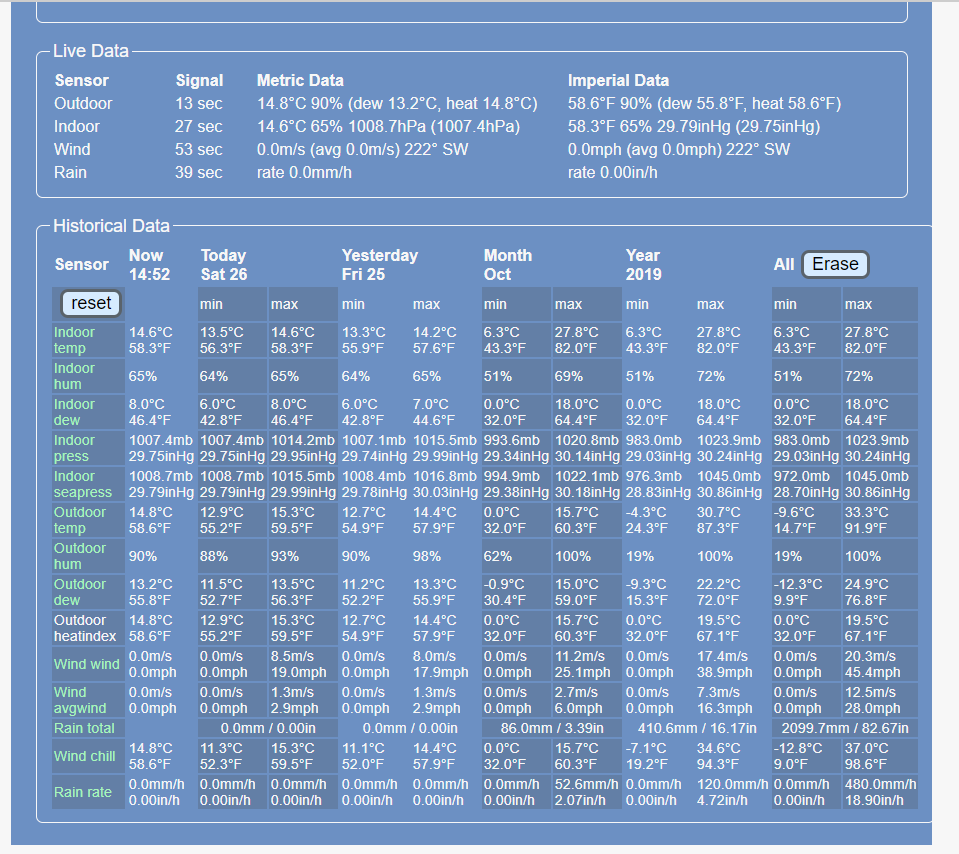

lightmaster
Posts: 37
Post by lightmaster »

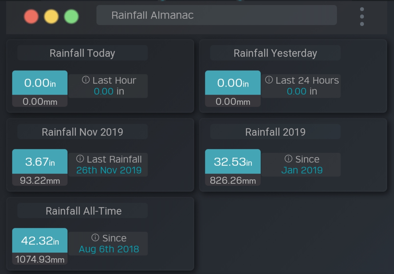

Here is the monthly and yearly rain data from my NanoSD:
This is what WL.com has for rain:
On WL.com, the table's monthly rain and the charts monthly rain don't agree, and neither match the MB's data. Yearly rain with WL.com doesn't match MB.

Post by gand »
hI
For my part MB and WL match pretty good, only a couple of mm for yearly rain. Graphs and records(WL) for rain don't not match MB. Wind and temp match MB. Pretty odd.

meteolive57290
Posts: 62
Post by meteolive57290 »
admin wrote: Fri Nov 29, 2019 12:45 am What kind of rain data does the Meteonbridge show, when it reads data from the WLL?
@Boris
MB is monitoring with WL-IP from my main station
for me no worries in recording rain
it's my WWLive (application and web) that records completely inconsistent reports
while if I take my station singularly everything is correctly recorded

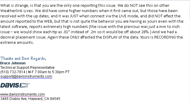

here is the answer I received from Davis (after my first report that goes back to May and the replacement of the device)
rain_WWL
rain_WWL
response Davis
response Davis
