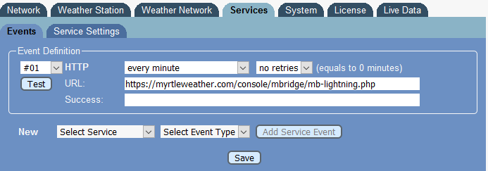

I may not have it correct. I have a new https Service running on the TP. Do I need it on the Nano?
hmmm no as you are on the tp link .. can you see the file https://myrtleweather.com/console/mbrid ... htning.txt in a ftp program and see if the file time updates per minute . dont use it on the nano i did yesterday allsorts of weird things happened and lots of lockups on the nano . no idea why so i reverted to tp link for just lightning..
i could add a timestamp on end of script might be useful at the moment .curious im using identical at present
Just checked and it is not updating. I changed file permissions to see if it would start and no luck. Maybe I should try uploading and empty file.

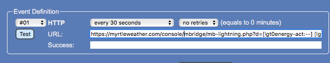

doh :-) look at the screenshot its missing the data :-)
https://myrtleweather.com/console/mbrid ... ing.php?d=[lgt0energy-act:--] [lgt0dist-act:--] [lgt0dist-age:--] [lgt0total-daysum.0:--] [lgt0total-monthsum.0:--] [lgt0total-yearsum.0:--] [lgt0total-sum10.0:--]
think it should be this
https://myrtleweather.com/console/mbridge/mb-lightning.php?d=[lgt0energy-act:--] [lgt0dist-act:--] [lgt0dist-age:--] [lgt0total-daysum.0:--] [lgt0total-monthsum.0:--] [lgt0total-yearsum.0:--] [lgt0total-sum10.0:--]

HA HA :D
OK. Got it now.
ok :-) ill use it for an hour then update GITHUB ..and yes its updating as expected now :-)

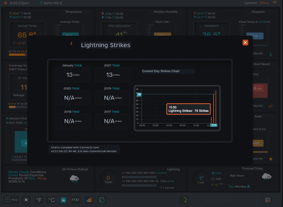

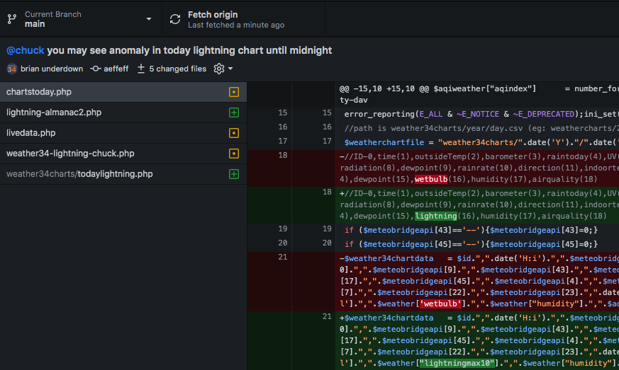

Github just updated files to show current day lightning chart . you may see an anomaly until midnight basically used the unused wet bulb position in charts .
if you know your previous years totals or estimated you can replace the phrase N/A with direct edit , I could add an option to setup to set total but it may be only you and I using this method via a separate TP LINK.
file to edit N/A would be lightning-almamac2.php
example you can see the N/A just replace with estimate or know value

next month compile month, year chart data screen..one step at a time seems to produce results :-)
OK. I have customized my side menu a little, but this will let me use your Lightning SVG. :D
