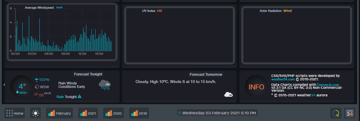

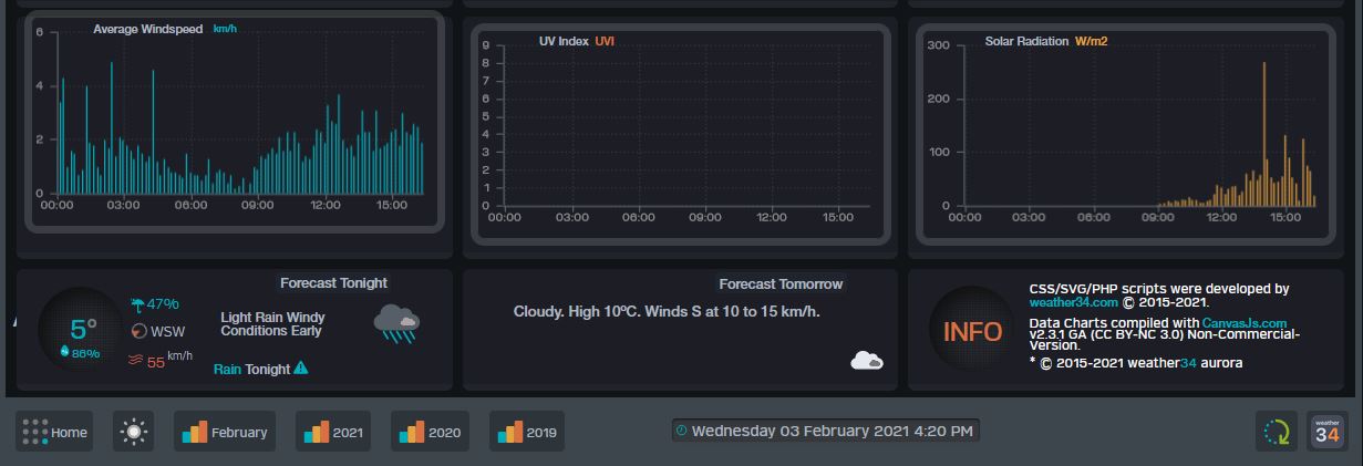

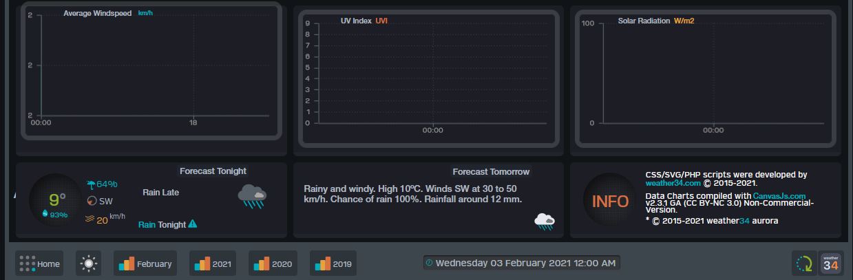

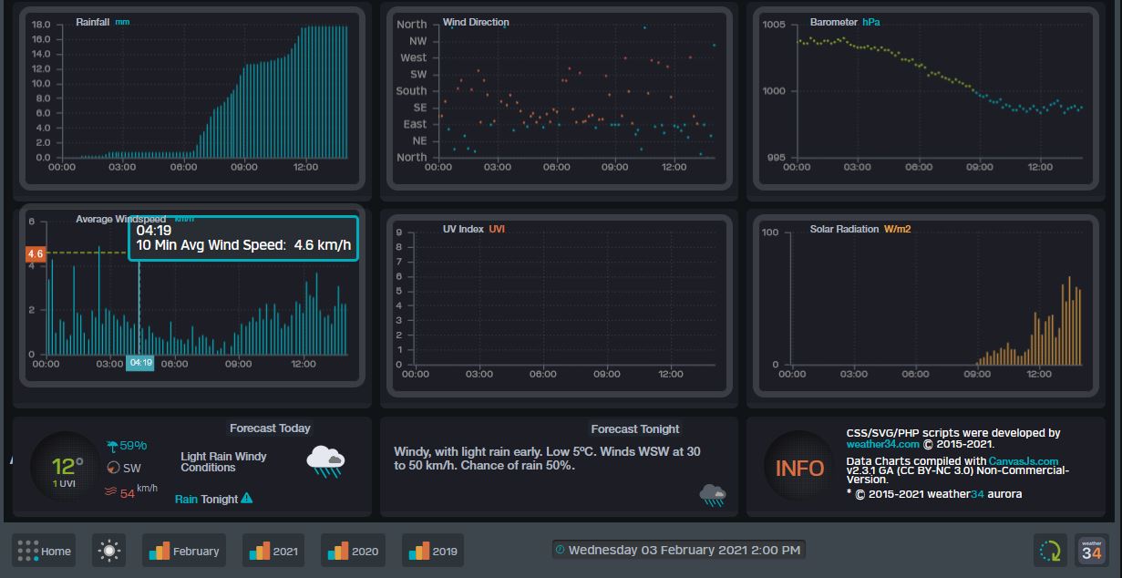

Hi, I have another weird situation with the Aurora MKII template.
Around 17:00 my time (CET) the daily charts for UV and Solar Radiation disappear - only a blank window is shown, no gradation, nothing.
It remains like this until midnight. Then the (of course during the night) empty windows appear with scales etc. until 17:00 when they disappear.
Any idea what went wrong here ?
I have done two independent installations from scratch on two different web servers with the 31-Jan-2021 version.
Both show the same phenomenon.

whats the CSV file showing for today ? i.e 3Feb2021.csv . please provide a url so I can dump this file locally to replicate if possible then I can address it
I attach the 1st three days (today only partial). As it already started on 1 Feb. They will need renaming as they have a _2 in their name.weatherist34 wrote: Wed Feb 03, 2021 7:38 pm whats the CSV file showing for today ? i.e 3Feb2021.csv . please provide a url so I can dump this file locally to replicate if possible then I can address it
I had already looked through them but couldn't find anything suspicious at first glance.

nothing unusual found perhaps you need to look locally .
try adding
date_default_timezone_set($TZ);
as shown below thats all I can think of definitely don't see any issues locally.
your file 3Feb below I guess you have no uv or just shite weather.

assume you mean in the todaysolarmodulechart2.php resp. ...uvmodule ...php filesweatherist34 wrote: Wed Feb 03, 2021 8:13 pm nothing unusual found perhaps you need to look locally .
try adding
Let's see what happens tomorrow ...
- Lot of rain - and only a few lame attempts of the sun to come out.your file 3Feb below I guess you have no uv or just shite weather.

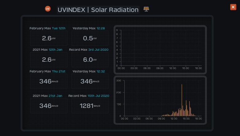

This chart (Extra Info/Solar Almanac, see your post above) is not displayed in my Aurora - the Solar extra info leads to an overall almanac page (weather34-almanac.php), which is not what I'd expect here. The Almanac button already leads to that same page.
Shouldn't the extra info be connected to another php script?

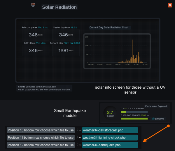

5th February simple update
* Adds optional small earthquake module (10:28am).
* Adds setup screen option for small earthquake module (10:28am).
* Adds solar extra info screen (10:28am).
* Important update requires Meteobridge Reboot (22nd January).

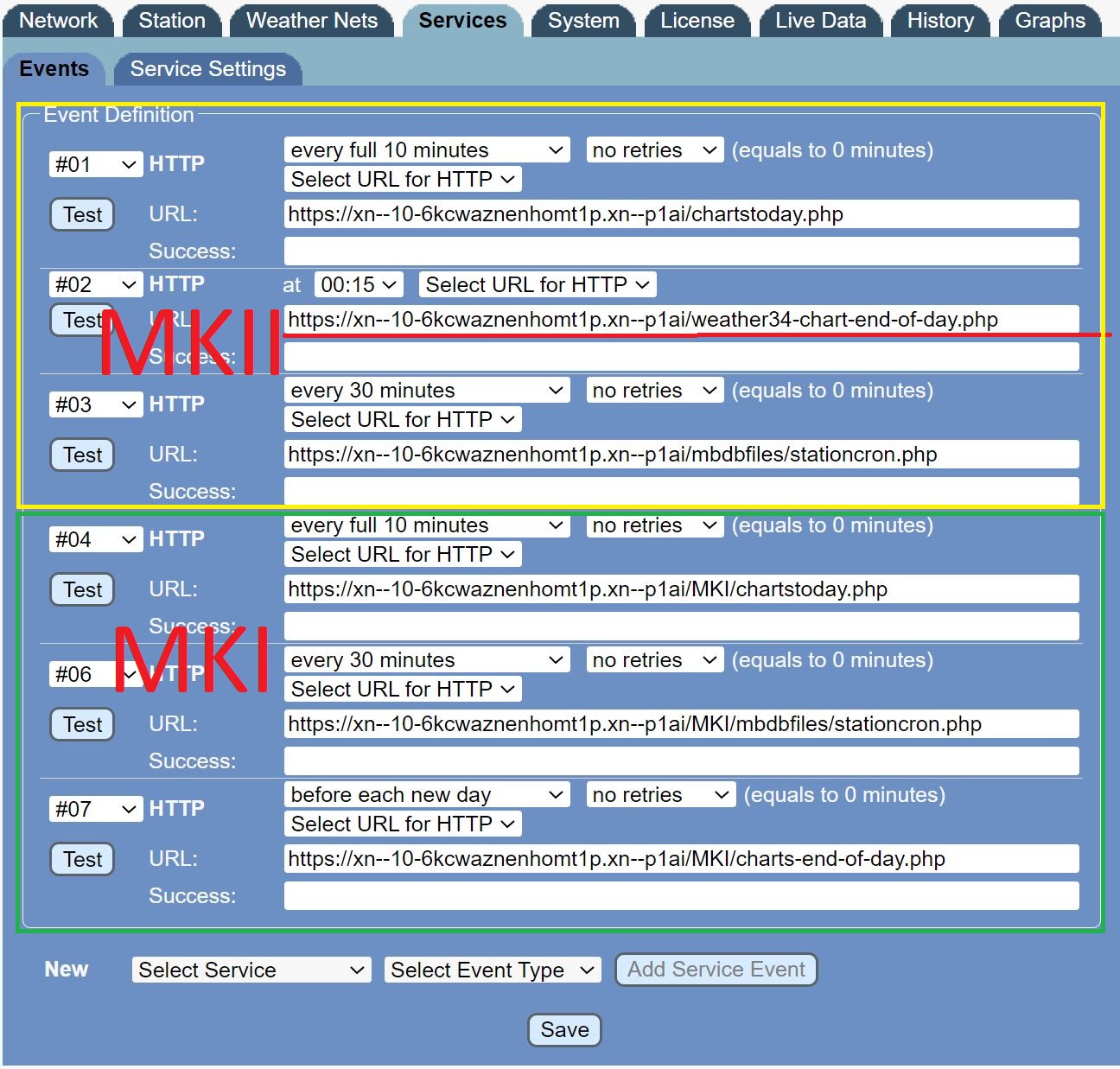

Hi, Brian! Recently I ran into this problem: the script for the file stopped working normally weather34-chart-end-of-day.php. When a new day arrives, the daily highs and lows are no longer added to the history for the month and for the year, respectively. But what is interesting is that I have MK1 running in parallel (I have marked everything in the attached picture) and everything is fine there. If you copy a string from mateo bridge https://xn--10-6kcwaznenhomt1p.xn--p1ai ... of-day.php and run it separately in the browser, then the past day is added correctly. Meteobridge was updated and rebooted several times, but the problem did not go away.

i have seen the same exactly same issue here your not alone , for some reason when running the script to collect yesterdays data at 00:15 meteobridge itself does not generate any data , i am currently running the old method just before end of day as you highlight.i have not had the time to look further into it .the only difference in script itself is it compiles yesterday data at 00:15 other than that it is identical so im going too look closer at the weekend to see i can fathom it out but my problem i cant stay awake till midnight etc so i have to wait till next morning. i have some idea but as above need to look closely .its worth noting ive yet to see this on any user websites ive monitored.unfortunately i dont monitor yours i will try..

If there is such a need, I can provide credentials from both my site and meteobridge via private messages.
- Posts: 1824
no thats ok i dont need those , if you want to help try running it at 2am to see if it does the same .

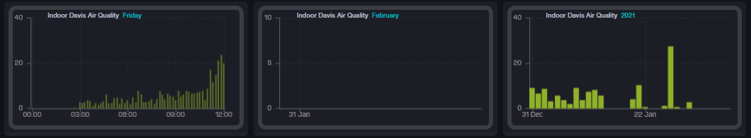

I noticed a little anomaly with the Davis Air Quality Month and year Charts. The data shows for the Day Chart but nothing for February. Is it because the 24 hour average is very low?

hi chuck you have 0.0 averages per day since Jan 29TH which was 2.9
29 Jan,8.8,-1.7,-3.2,-8.8,0.0,8.7,0.2,0.2,1027.2,1023.8,2.9,733.0,35.5,2.9,309.0
30 Jan,9.4,-2.4,5.8,-6.4,0.0,8.7,0.2,0.2,1028.1,1022.2,3.0,793.0,37.8,0.0,187.0
31 Jan,15.3,9.4,13.9,5.8,31.5,10.1,0.3,0.3,1022.3,1003.7,1.0,141.0,29.3,0.0,196.0
1 Feb,12.4,4.2,11.7,3.2,4.3,9.4,0.4,0.4,1005.9,1003.0,0.8,179.0,35.9,0.0,311.0
2 Feb,9.0,2.1,4.4,-3.0,0.0,12.0,1.2,1.2,1006.9,1003.9,2.6,972.0,28.5,0.0,306.0
3 Feb,11.6,0.5,-1.9,-7.3,0.0,14.1,0.7,0.7,1015.4,1006.8,2.2,758.0,21.6,0.0,297.0
4 Feb,9.3,-2.5,5.7,-8.8,0.0,6.0,0.4,0.4,1019.1,1013.7,2.7,650.0,22.2,0.0,224.0
only user I can think who has a similar setup is graham http://ringwoodweather.ddns.net/Aurora2 ... charts.php for comparison
