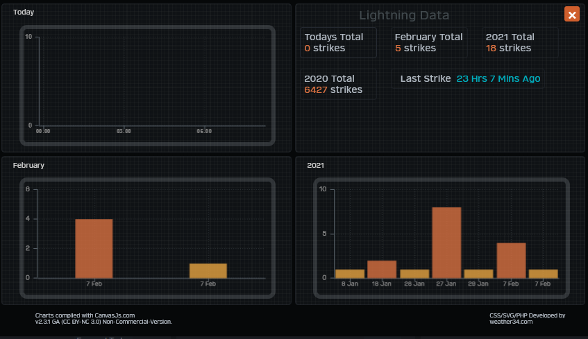

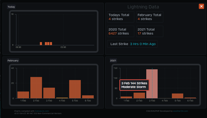

Hello Chuck I just pushed an update to GIT basically cleans up code and layout . also in small lightning module after 1 day the phrase Extra Info will appear instead of example 12 Hours 3 Mins Ago .
the exact time ago appears in larger popup as normal i.e 5 days ago etc
so should resemble this but yours will have less previous years .

Ok. That looks great!weatherist34 wrote: Sun Feb 07, 2021 7:19 pm Hello Chuck I just pushed an update to GIT basically cleans up code and layout . also in small lightning module after 1 day the phrase Extra Info will appear instead of example 12 Hours 3 Mins Ago .

good stuff think thats enough for a while no plans anything extra anytime soon. have updated via GIT just now just tweaked the colors and phrases in the lightning charts .shown belowprestwickwx wrote: Mon Feb 08, 2021 3:29 pm Hi Brian,
I have the latest lightning update and I edited my data files to correct the February date and add in the January 2021 strikes.
Looks like everything is fine.![]()
also simple update was updated .its worth what me and chuck are using is a separate TPLINK with meteobridge software just to drive a weatherflow lightning sensor so all this recent lightning stuff is only related to that.Ecowitt extra sensors are not supported in any way template has no idea what or how to handle those so Im afraid those emailing thinking they found a bug Ecowitt is simply not catered for .sounds harsh but Im simply not getting sucked into that array of mess especially has I dont own any of it so I stand little chance of resolving anything related to Ecowitt.

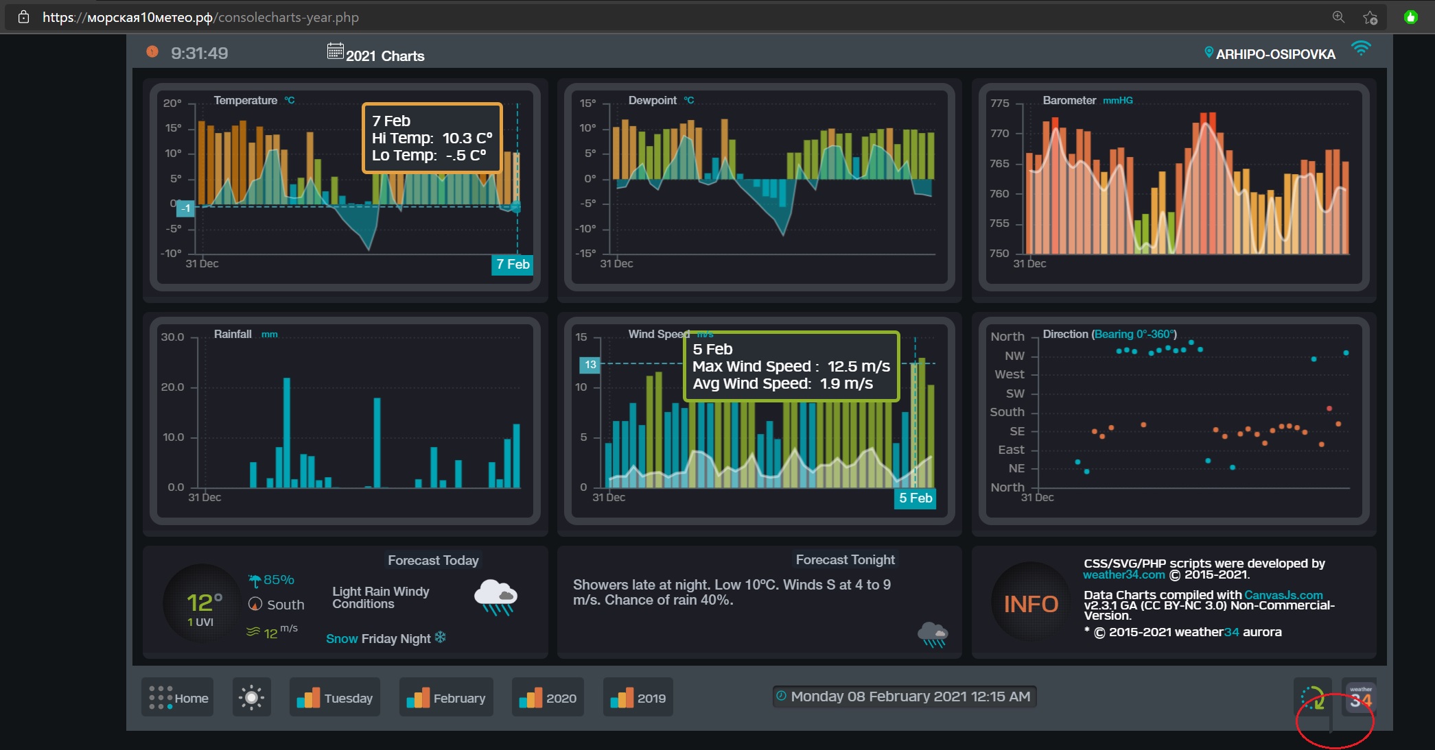

Hi, Brian!
Today, again, the day was not saved "automatically" on MK2 (everything is fine on the parallel working MK1).
Here, by the way, there is a strip in the lower right corner.
- pic.jpg (392.81 KiB) Viewed 4929 times
- Posts: 1824
as above Alex try setting it to run at 2am

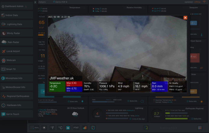

Brian: Update 8th Feb 2021 - Weather34-large-cam.php
My webcam image is large. In yesterday's update it is no longer scaled to fit the data-lity pop-up window size but instead has scroll-bars.
https://jmfweather.uk/a2/index.php and https://jmfweather.uk/a2/weather34-large-cam.php.
This is the same on Chrome or Safari.

- Posts: 1824
hi it was highlighted this morning , there is a fix for this coming later , sorry for the inconvenience but i dont use a webcam so trying to find a solution for various outputs from different users .jasonmfarrow wrote: Tue Feb 09, 2021 3:04 pm Brian: Update 8th Feb 2021 - Weather34-large-cam.php

- Posts: 1824
just updatedjasonmfarrow wrote: Tue Feb 09, 2021 3:04 pm Brian: Update 8th Feb 2021 - Weather34-large-cam.php
* Fix large webcam image size ref Theo/Jason (5:40pm).
