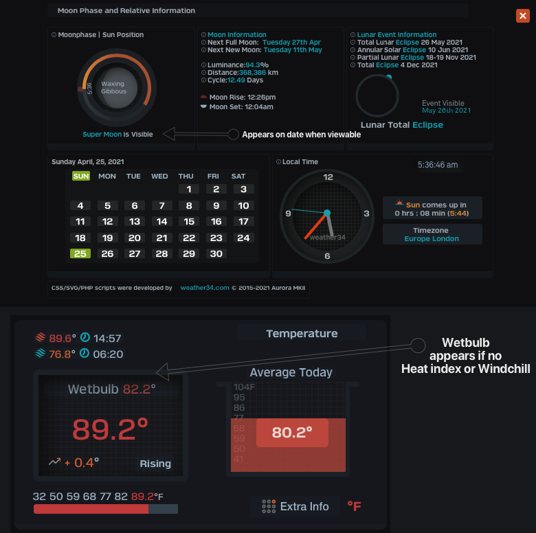

* Adds Request for Super Moon events 2021-23 Ref Toto (08:08)
* Adds Request for Wetbulb display Ref Peter H (08:08)

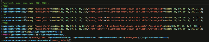

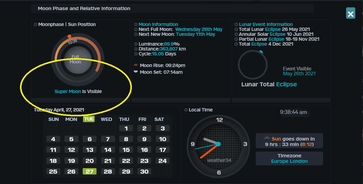

simple code to display Super Moon events , the phrase will appear on the date expected .
jmontamat
Posts: 267
Location: Barcelona Spain
Post by jmontamat »
Works !!!!
Sin título.png (180.46 KiB) Viewed 5710 times
Thank you Josep dont think it could fail :-)

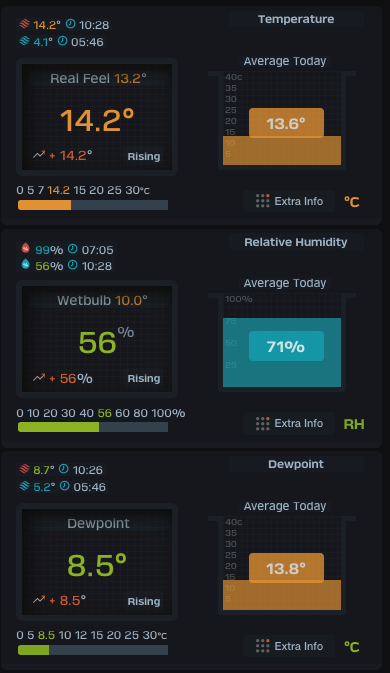

Download Update 27th April 2021
* Important New API values requires Meteobridge Reboot (11:14)
* Adds Humidity Day Average Gauge (11:14)
* Adds Dewpoint Day Average Gauge (11:14)
* Moves Feels Like to Temperature Module (11:14)
* Moves Wetbulb to Humidity Module (11:14)

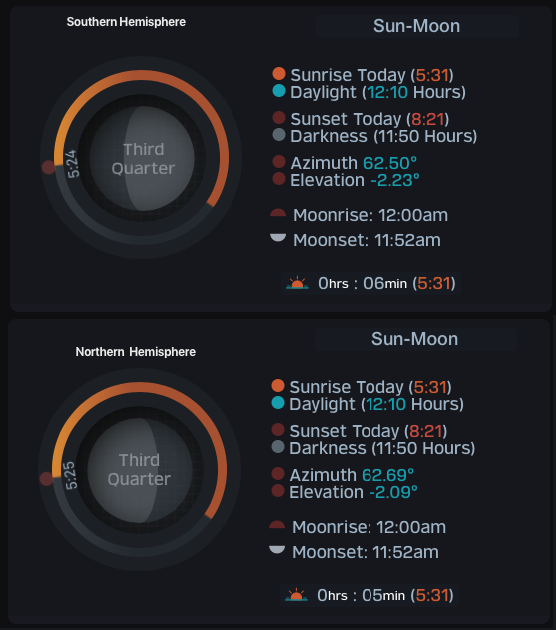

Gday Brian , I hope your break from the city is going well, I have a couple of strange issues with the latest version of the template, Firstly the moonset times are 1 hr behind actual since our timezone (SYD Australia) finished daylight saving, and I did change the UTC offset to compensate. Also the graphic is upside down inside the moon disc, I know you wont be back for a couple of weeks but if you could take a look after you return it would as always be appreciated.
Kind Regards
Gary
Hello good morning perhaps I had too much amber nectar , bit of a dumbass mistake by me ...I can do the simple fixes/cockups I make here, but nothing complex so updated below.I can't replicate the moon times error , I would need to look deeper when I go back to Istanbul..
Download Update 2nd May 2021
* Rotation moon phrase for Southern Hemisphere Ref vortexya (07:36)
