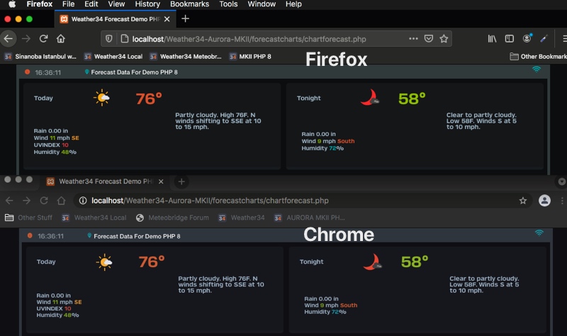

Hi Brian,weatherist34 wrote: Sun May 16, 2021 3:06 pm super it just needed a UTF8 php header line sorry should have thought of that earlier. anyway have a good day .brian
Just updated to the latest and the odd character in the Forecast temperature returned. Here is what I found looking at the Header:
This code in line 1 produces the odd character:
<?php include_once('updaterwu.php');include('wudata.php');header('Content-Type: text/html; charset=utf-8');?>Code: Select all
<?php header('Content-Type: text/html; charset=utf-8');include_once('updaterwu.php');include('wudata.php');?>Strange

it feels like working blind cant see any discrepancies locally here on two localhost servers, or ICDSOFT server so im baffled .look later see if i can reproduce but so far i haven’t been able too. perhaps it needs code “if error echo pour a beer come back tomorrow “

A good Stout or pint of Ale always solves the problem.weatherist34 wrote: Wed May 19, 2021 4:17 pm hello chuck
it feels like working blind cant see any discrepancies locally here on two localhost servers, or ICDSOFT server so im baffled .look later see if i can reproduce but so far i haven’t been able too. perhaps it needs code “if error echo pour a beer come back tomorrow “![]()
It may be something that is configured slightly different on your ICDSOFT server vs mine - I am sure we are in different data centers.
I reversed the order and everything is fine.
Cheers,
Update - I am thinking it might be the .htaccess file on the webserver. Perhaps yours includes a line AddDefaultCharset UTF-8 in the file.

may be thats the answer having the utf header 1st
- Posts: 1824
hmm I dont use a modified htaccess on local server. I updated GITHUB/Download according to your idea, I still couldn't replicate locally in browser safari, chrome, firefox (Mac OS).also contains some other minor adjustments .here is what I see locally

Ok. Must be some unique conf. on my server. As soon as I reverse it, Chrome and Safari show the odd character - Firefox is fine.
I also checked my php.ini for default_charset = "utf-8"; and I don't have that line.

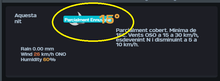

Good morning Brian.
Would it be possible to correct this superposition by shifting the temperature value?

- Posts: 1824
Good morning Josep
no problem all done just add a z-index has the position is from the master css files shifting it would also push other out of sync.
css is straight forward [data-title]{z-index:9999}

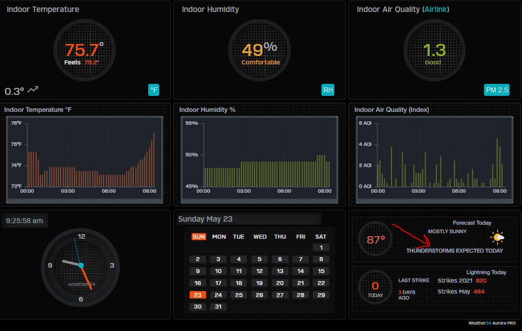

Hope all is well.
Just noticed a minor issue. The Forecast being reported seems to be slightly different on the Indoor page than on the others. Different source maybe?
Best wishes,
Hope all is well.
