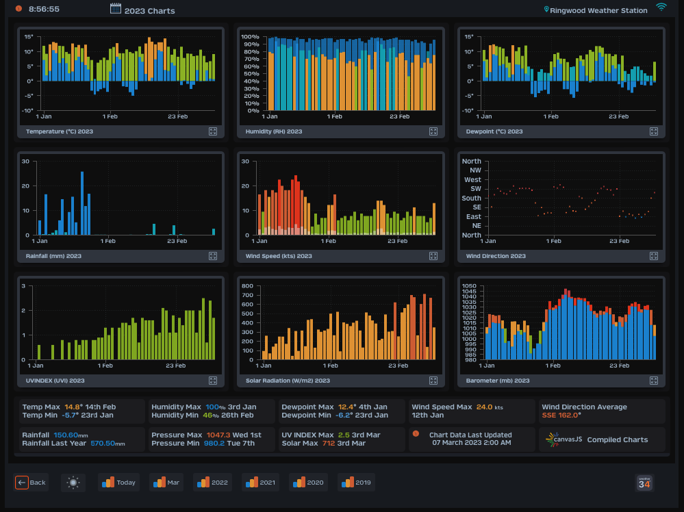

2.Restructured code for end of day charts file and today charts file .Making it easier for end users to modify or fix missing CSV data shown below the position number is the corresponding CSV chart file position .remember the code compiles the data from the previous day at 2am don't confuse it with current day max/min/avg ..
csv year file example
3.additional CSS added to theme 5 preparation for new theme option 6 (based on new Davis console layout this will be nigh on a replica but with additional support for Air Quality and minor icon and color shade differences to avoid any infringement but in short its a replica as requested .
4. minor CSS code fixes and as always verified for latest PHP 8.2.3 https://www.php.net/downloads.php
this update is primarily for Purple Air Quality users with just minor additions for others .April should have a significant update for all users .
update download is also in the first post of this thread.
if you are not using Aurora MKII from August 2022 or later do not try to run this update !! it will break your existing older version.please install a new master Aurora MKII version available in the first post of this thread and then simple run this update .
https://www.mediafire.com/file/mu3kcmsj ... 3.zip/file
1.Contains Woodsmoke addition for Purple Air users
// meteobridge and chart position number
$weather34chartdata = date('j M',strtotime("yesterday"))."," //date chart position = 0
.$meteobridgeapi[82]."," //Max Temp chart position = 1
.$meteobridgeapi[84]."," // Min Temp chart position = 2
.$meteobridgeapi[52]."," // Max Dewpoint chart position = 3
.$meteobridgeapi[120]."," // Min Dewpoint chart position = 4
.$meteobridgeapi[100]."," // Rain Total chart position = 5
.$meteobridgeapi[94]."," // Wind Speed Max chart position = 6
.$meteobridgeapi[123]."," // Wind Speed Avg chart position = 7
.$notused."," // Not Used chart position = 8
.$meteobridgeapi[135]."," // Pressure Max chart position = 9
.$meteobridgeapi[137]."," // Pressure Min chart position = 10
.$meteobridgeapi[114]."," // UV Max chart position = 11
.$meteobridgeapi[107]."," // Solar Max chart position = 12
.$aqiweather["aqi24h"]."," // Purple Air 24 hour Avg chart position = 13
.$meteobridgeapi[184]."," // Davis Airlink chart position = 14
.$meteobridgeapi[171]."," // Wind Direction Avg chart position = 15
.$meteobridgeapi[167]."," // Max Humidity chart position = 16
.$meteobridgeapi[169]."" // Min Humidity chart position = 17
1 Mar,7.2,3.8,4.4,-2.0,0.8,8.5,1.8,**,1035.9,1028.0,1.7,171.0,8.3,22.5,40.0,92.0,79.0
2 Mar,5.5,1.8,2.5,-0.8,0.0,5.4,0.7,**,1029.9,1027.1,1.5,171.0,31.7,53.8,76.0,93.0,72.0
3 Mar,5.8,2.1,1.7,-0.6,0.0,5.8,0.9,**,1032.7,1029.8,1.1,149.0,28.3,37.9,58.0,85.0,72.0
4 Mar,4.3,1.7,0.7,-1.6,0.0,3.6,0.4,**,1032.6,1026.7,0.8,130.0,39.2,77.4,16.0,83.0,73.0
5 Mar,5.4,1.0,2.4,-1.3,0.2,5.4,0.4,**,1026.7,1010.5,1.5,169.0,42.5,60.2,298.0,93.0,71.0
6 Mar,7.5,2.4,5.9,-2.4,2.2,10.7,1.7,**,1017.1,1012.9,3.4,336.0,45.8,3.8,311.0,100.0,89.0

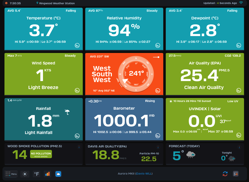

Simple Update March 2023 (Rev 4)
https://www.mediafire.com/file/z157gf19 ... 4.zip/file
Adds woodsmoke formulas to Davis Airline and Luftdaten modules (see screenshot) so template offers woodsmoke for purple air, Davis airline , luftdaten devices.

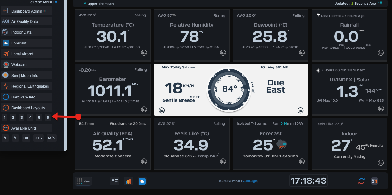

Good morning Simple Update Rev 3 March 2023
https://www.mediafire.com/file/xgzb62sb ... 3.zip/file
Introduces first additional theme 2 more to come in coming months , access the theme/layout via menu number 6 option and also 4 additional modules option added to setup screen .prior to running the theme please set the 4 additional modules in the setup screen.
screenshots below ... if you have provided FTP access for updates then you are up to date , you can check via hardware info screen for REV 3 !
