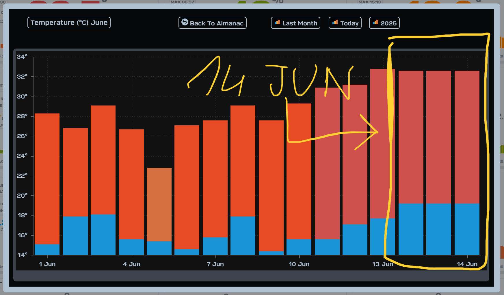

Hello, I had the same problem with yesterday's data. I manually deleted it by reloading the correct archive.pwilman wrote: Thu May 15, 2025 6:20 pm Boris,
Not sure if its relevant, but I seem to have had 3 instances at 14th May added to the graphs. All with exactly the same data. Dont think I have done anything. Does not bother me majorly, but thought I would report it just incase there is a bug somewhere that others experience.
If you have a look at www.paulwilman.com you can see my cloud dashboard and if you click on the extra data button for any of the variables you will see what I mean. I have not noticed this before.
Paul

It happened again.
How can this be solved?

Lorenz,
I thought Boris implemented some sort of script that checked for instances of multiple daily records and then deleted the duplicates. It could have been that he implemented only on my version of the software???
I have not had any recurrence of the issue since I raised it with Boris. I noticed it happened about a week ago, but by the time I got round to thinking about reporting it the duplicates had disappeared.
One for Boris I think.
Paul
Paul

Maybe it's as you say.
Today the duplicate of June 14th has disappeared.

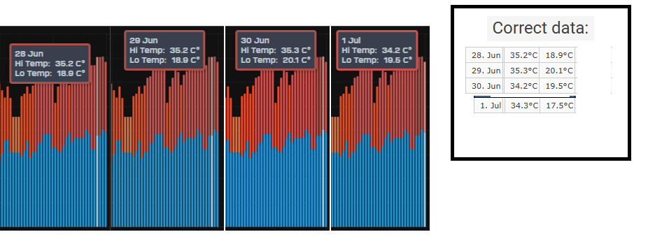

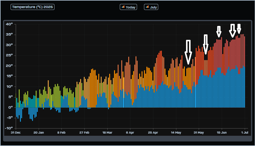

Good morning. I still have several data repetition problems.
Repetition 3 times: May 24, June 5 - 14 - 24.
Repetition 2 times: June 27.
Another different problem:
June 28 and 29 have the same data but it is wrong.
From June 29 all the data is wrong by 1 day.
Example: July 1 shows the data of June 30.
Sorry for my English, I add the images.

should work again fine.

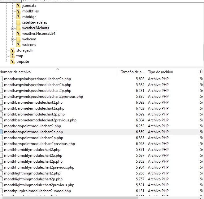

Hello, good afternoon, I installed my new website, here it is for you to see: https://climachivilcoy.com.ar/
Here I am seeing that I have many duplicate files, is this normal or can I delete the ones that have the same name?

There are no duplicates, do not delete.

Hi, thanks for responding. Yes, I looked at it carefully later and you're right. Sorry for misinterpreting.

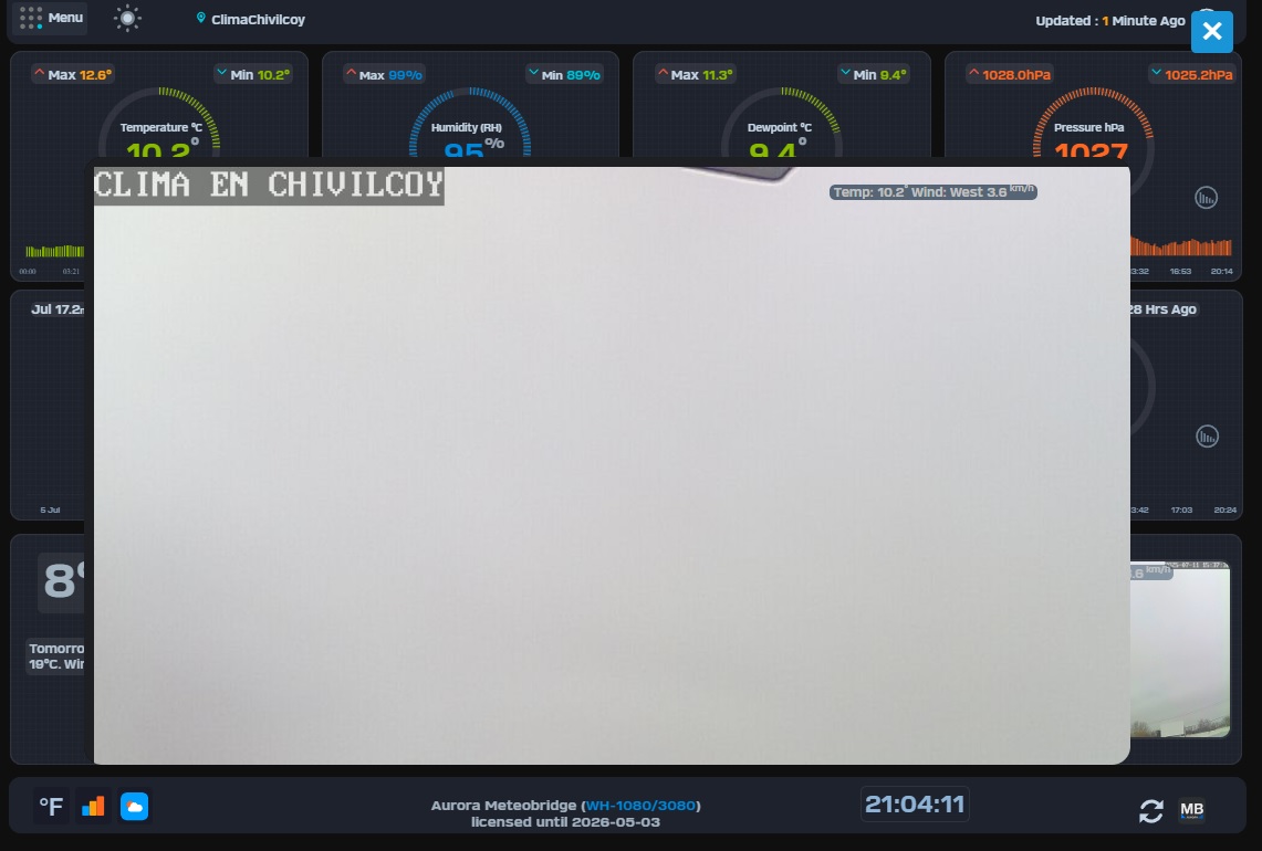

Now I have a problem, when I click on the image of the WEBCAM, it remains with too much ZOOM, why is that? How can I solve it?
You can check it here: https://climachivilcoy.com.ar
I attach 2 images
I attach 2 images

Scaling of larger web cam image should be fine now.
