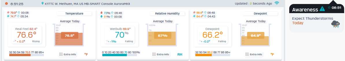

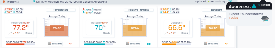

I am seeing the Awareness offset as well on my system under W10 Firefox & Chrome. On Chrome it's not as far off but stiil out of the frame.
See below:
Awareness to right Light Screen.PNG (54.72 KiB) Viewed 5545 times
Awareness to right Chrome Light Screen.PNG (53.94 KiB) Viewed 5545 times

@ron my guess there is some css line in there causing some variation, i will endeavor to find it , i couldnt see it until installed firefox on my new mac last night so now i have something to work with ..many thanks… brian

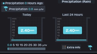

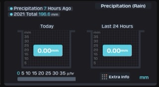

I have the phenomenon, that always between 7-8 o'clock, a rain is reported before 7 hours. Something must not fit with the calculation of the $seconds_ago in the module weather34-rain.php for this period.
There was no rain the last days.
Greetings Torsten
thanks think I found it ? see what happens tomorrow :-)

Posts: 259
Thanks, I think the fix was too fast ;-)
Now, no minutes are displayed when raining < 1h .
If I comment out this line:
//else if ($seconds_ago <= 7200) { echo 'Precipitation&nbsp;<blue>'.intval($seconds_ago / 3600) .'</blue>&nbsp;Hours Ago'; }
the minutes are also there again displayed.
Whether now further the last rain is indicated between 7-8 o'clock, I must observe the next days. I have actually rather the variable $raintimeago=$originalDate124 in suspicion, that here something wrong is supplied by the Meteobridge?
