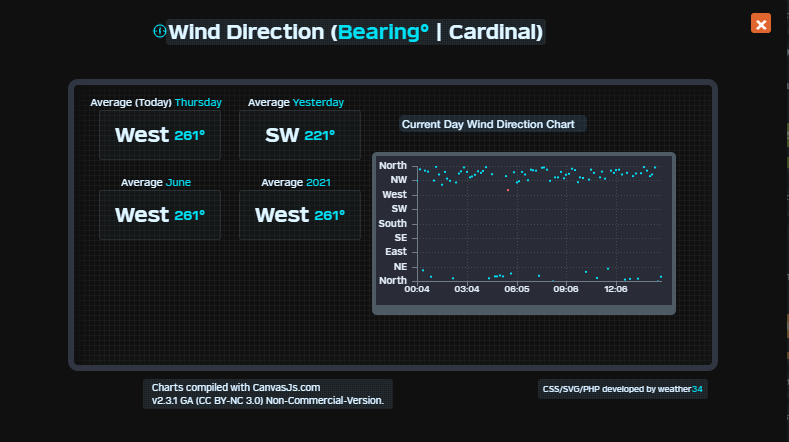

Sorry, I have a couple of questions I hoping you can help me with. I am trying to work out if it’s something I have done or it is a constraint of using Ecowitt (which you mentioned before) or the type of meteobridge I have (it’s not a pro or a NANO).
I have noticed in the wind direction module the average for today and the month appears to be wrong. In the image below you can see the wind direction during the day has been generally North/North West, however the average for the day is saying West. I noticed yesterday the average was SW, when it has been blowing from the same direction (NNW) for a number of days now. I checked the csv file for today and the wind direction being recorded has not been below 300. Do you know why this would be the case?

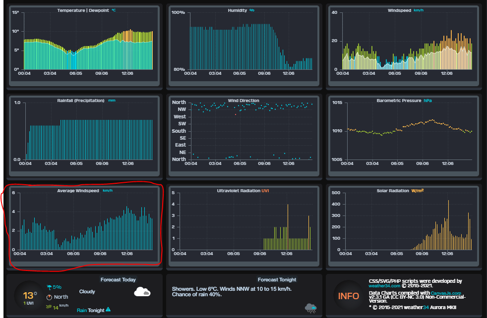

Secondly, can you tell me what the chart circled in red is supposed to show. I know its labelled as average wind speed but it always is very low when compared to windspeed in the top right hand corner. I have watched it over a couple of days and it barely gets above 5 and yesterday was quite windy here so it looks a little odd. It looks as though it is based on m/s rather km/h
Today charts.PNG (98.81 KiB) Viewed 5427 times

cheffy wrote: Thu Jun 17, 2021 7:16 am Hi Brian,
Lastly, I have tried to include the weather34-lightning-chuck module because I like the extra detail, however it does not update with my data and just remains the same (demo data). The normal weather34-lightning works fine and captures my data but this version does not. Is there something I have to do to make this work or is this a limitation of using Ecowitt?
Thanks as always,
Neil
Hello sometimes you need to sit on the dunny with a "coldie" :-) helps the learning curve of using new hardware ...
Circled chart ..
No in all seriousness wind average is based on past 10 minutes that's why its critical to run the chartstoday at every 10 minutes because where the averages are generally recorded is based on the previous 10 minutes .
If you were separate the data in the top right wind chart it would resemble the average chart circled.

G'day Brian! :wink: It might be a bit cold to sit on the dunnie with a coldie at the moment. It’s winter here and it’s a rainy cold day with the temperature around 11 degrees – which is cold for us aussies, it's definatly beanie/scarf/gloves kind of day!
In terms of the circled chart, yes I am running the chartstoday every 10 mins. I looked into this a bit further today, I can confirm the chart is showing m/s rather than km/h. I checked the average wind speed in the top right corner (which is km/h) and converted these numbers to m/s and they match exactly to what is in the circled chart. I am not sure if this is a bug, but I have checked all my settings and the chart itself is even labelled km/h. In the end I don’t really need this chart because the average is displayed in the chart in the top right corner, is there any easy way to swap this chart out with something different? I see on other sites people have done this - I assume this is relatively easy to do? What do I need to do, I have looked but I can’t find where this needs to be changed.
In terms of my wind bearing question I had, I have now worked that out. The wind over the last few days has been blowing from a N/NNW direction. Most of the readings have been in the range of 320-360, however there are number that fall into the range of 0-40. Obviously when this happens and you average it out over a day it dilutes the wind direction and becomes more westerly rather NNW…..if that makes sense! I took the csv file for yesterday and manually calculated the average and it comes very close to what is being reported in my template – so it is working as expected.

Good morning many thanks ! that wind average chart was missing the correct conversion formula just fixed that . as for winter we are entering the dreaded humidity season its quite oppressive here being near the sea front in a peninsula the humidity gets trapped and combine the warmer temperatures its gets stupidly uncomfortable .
