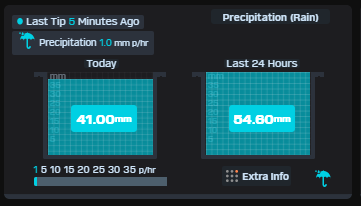

I seriously think the rainfall buckets need to overflow...mine are both full!
Just add some dribbles down the side whenever the day's total is over 25mm for those of us that have slightly wetter climates!

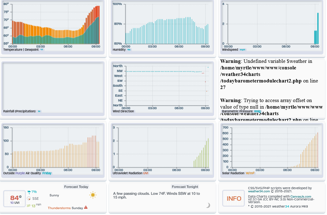

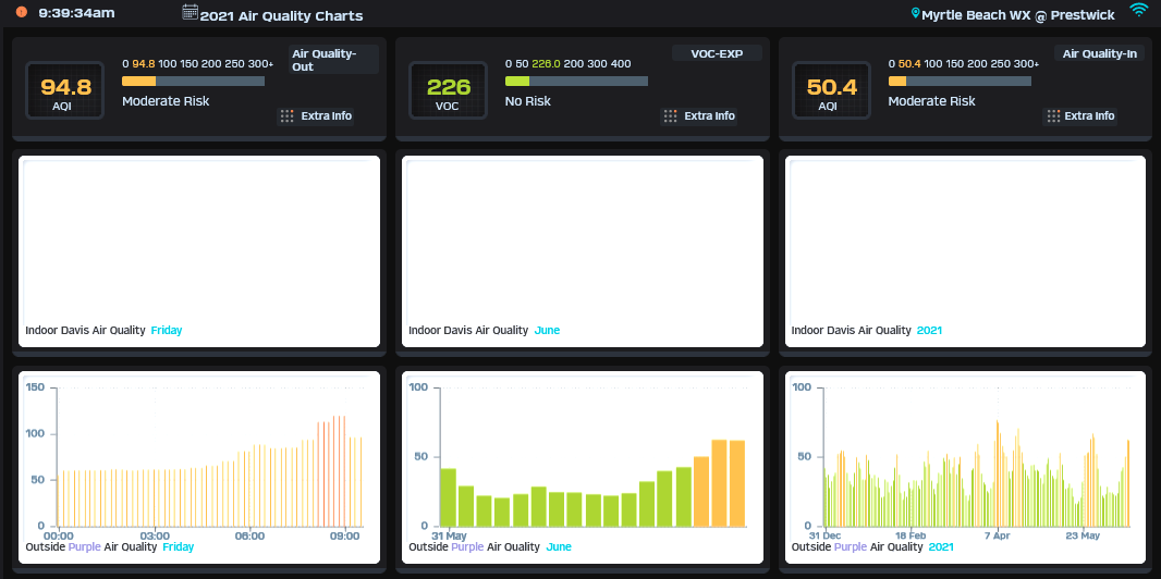

I just updated and the only thing I see is an issue with the Barometer Chart, Rainfall, UV and AQI
I read your info about the chart color theme. Is main overall default theme now set as Light?

@Jason there was a slight error in rain/humidity gauges scaling I forgot to adjust in the files that said animations are a heavy burden on cpu resources , I don't disagree with the idea just need a smart clean solution .I see these gauges has relative indicators not true accurate measuring tools .more of a visual element to indicate i.e if you had 40mm of rain today then the buckets full and there are puddles in the pathway unless you have the perfect flat path

I checked the preload and updated all of the recent files (last week) from the Download. Still seeing all of the issues.
I will keep looking and I can always revert back until I find it.

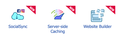

might be worth checking this , in the ICDSOFT CPANEL they introduced a new server side cache feature which is server side ,its enabled by default this caught me out a few weeks ago when I found some files were not reflecting changes simply disabled it its beneficial for big sites , Wordpress etc, just a thought ?
- prestwickwx
- Posts: 510
I purged and disabled and also ran the full update file. Still no change. Very strange.
- Posts: 1824
try updating via the update file … its indicating an error reference to units for rain , pressure , I tried replicating it here but I cant. guarantee its something simple..
- prestwickwx
- Posts: 510

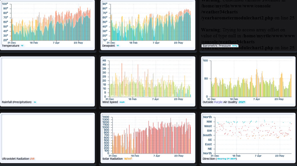

I rain the update file, but still seeing issues with rain, pressure and UV charts.
Warning: Undefined variable $weather in /home/myrtle/www/www/console/weather34charts/monthbarometermodulechart2.php on line 25
Warning: Trying to access array offset on value of type null in /home/myrtle/www/www/console/weather34charts/monthbarometermodulechart2.php on line 25

the console log shows its related to units
labelFormatter: function ( e ) {
return e.value .toFixed(<br />
<b>Warning</b>: Undefined array key "rain_units" in <b>/home/myrtle/www/www/console/weather34charts/todayrainfallmodulechart2.php</b> on line <b>155</b><br />
1) + " <br />
<b>Warning</b>: Undefined variable $weather in <b>/home/myrtle/www/www/console/weather34charts/todaybarometermodulechart2.php</b> on line <b>155</b><br />
<br />
<b>Warning</b>: Trying to access array offset on value of type null in <b>/home/myrtle/www/www/console/weather34charts/todaybarometermodulechart2.php</b> on line <b>155</b><br />
0) ;

No problem. I will look around see if I can spot anything.

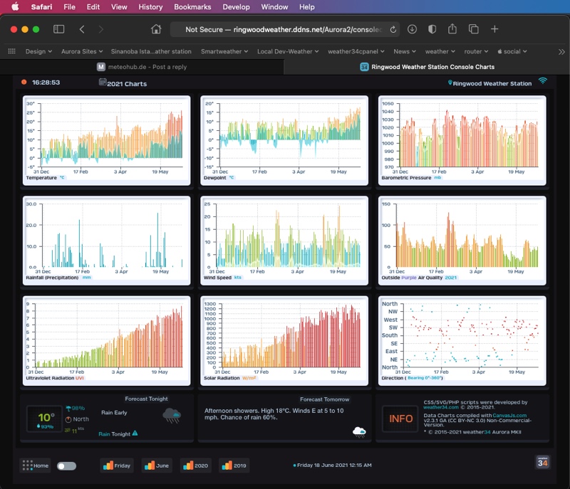

I did check Ron, and Graham. Ron does not have a UV module and Graham's charts don't seem to be loading.

https://micklehamweather.com/Weather34/ ... s-year.php loads ok here
grahams loads fine here see screenshot that said at times his site url is slow to load here in Istanbul , I think its his own personal server at his home..
plot thickens on this one ?
as a last resort just do a new install in separate folder and see what happens , just transfer over your CSV files to render charts.

My fault it was ringwood that was not loading.

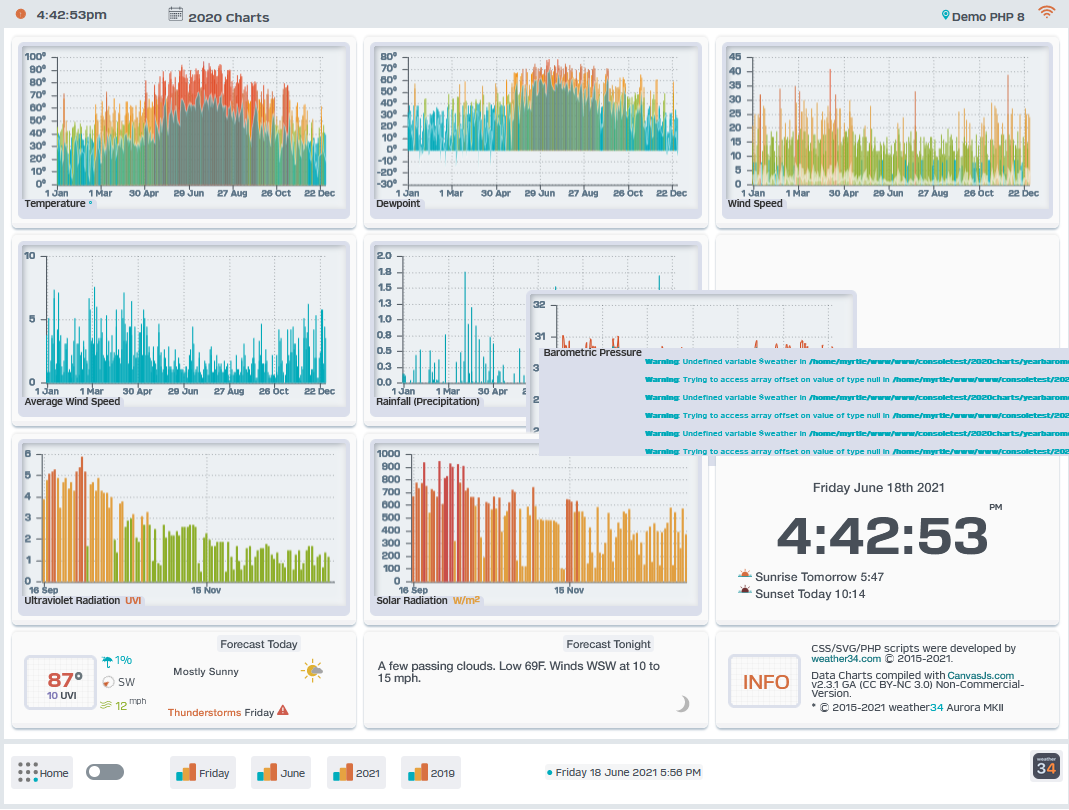

I grabbed the full master download and that fixed all of the issues except one. I must have been missing some file updates from github - since I tend to use it for all updates.
The remaining issue is in the 2020 charts. It is also shows in the Master Demo File (latest download) as you can see from the screen capture. I does not show up on Ron's site, so maybe its a previously updated file that did not get in the Master download.
: Undefined variable $weather in /home/myrtle/www/www/console/2020charts/yearbarometermodule-2020.php on line 5
Warning: Trying to access array offset on value of type null in /home/myrtle/www/www/console/2020charts/yearbarometermodule-2020.php on line 5
Warning: Undefined variable $weather in /home/myrtle/www/www/console/2020charts/yearbarometermodule-2020.php on line 6
Warning: Trying to access array offset on value of type null in /home/myrtle/www/www/console/2020charts/yearbarometermodule-2020.php on line 6
Warning: Undefined variable $weather in /home/myrtle/www/www/console/2020charts/yearbarometermodule-2020.php on line 7
Warning: Trying to access array offset on value of type null in /home/myrtle/www/www/console/2020charts/yearbarometermodule-2020.php on line 7

I think I found the issue in: yearbarometermodule-2020.php
Went back to the older version:
Seems to be fine.
<div class="modulecaptionchart">Barometric Pressure<blue1>
<?php
if ($weather["temp_units"]=='C' && $position8=='barometer-modmmHG.php') {echo 'mmHG';}
else echo $weather["barometer_units"];
if ($weather["temp_units"]=='C' && $position8=='barometer-modmmHG.php') {$conv=0.750062;}
else $conv=1;
