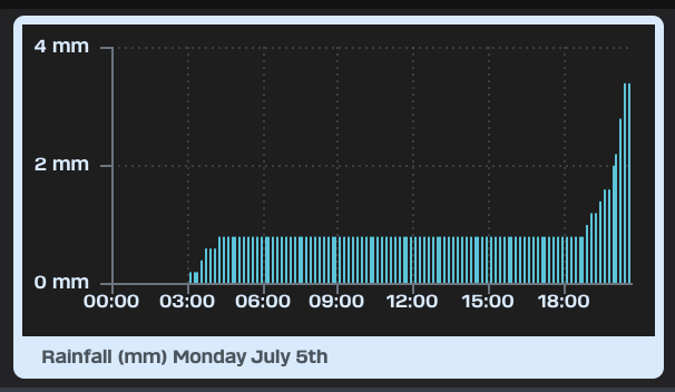

Nope. It's not the chart. It's the raw data. In weather34charts/2021/5Jul2021.csv the first few lines are:
The 5th comma delimited item is the day-total rainfall. However this was yesterday's day-total rainfall. The rainfall at midnight should be zero...but it's not. Changing that 11.0 to 0.0 results in this chart:
So there are two possible fixes: 1) correct the chartstoday.php code to use the correct value at midnight (00:00) or 2) get the weather34charts/todayrainfallmodulechart2.php chart code to ignore midnight rainfall readings.

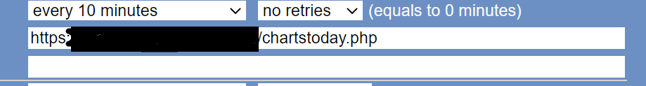

Considering that the chartstoday.php script is scheduled by my Meteobridge NanoSD "every full 10 minutes" there is a case for saying that the bug might exist at the Meteobridge end. According to Brian's instructions chartstoday.php is called by the meteobridge "every full 10 minutes".
If "every full 10 minutes" adheres to our expectations then it should execute any script at precisely 23:50:00 and 00:00:00 and 00:10:00 etc. Which then, if true, at 00:00:00 the Day_Rain_Total should be zero. If the "every full 10 minutes" is not precisely 00:00:00 but might be 23:59:59.9 then I can understand why the Day_Rain_Total is not zero when calling chartstoday.php.

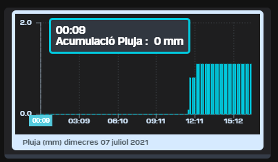

I use TP-link and the first record is at 00:09 maybe it is a time lag between meteobridge and the server template?

There is a difference between "Every 10 Minutes" and "Every Full 10 Minutes". You use the former; the timing of which is established from when the meteobridge was last rebooted. "Every Full 10 Minutes" is supposed to be 00,10,20,30,40 and 50 minutes past each hour.jmontamat wrote: Wed Jul 07, 2021 4:44 pm I use TP-link and the first record is at 00:09 maybe it is a time lag between meteobridge and the server template?

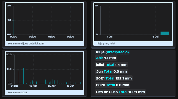

You have clearly implemented this "every full 10 minutes" and demonstrated the problem. You had 1.1mm of rain yesterday. This is reflected in your charts and it's making the mess of the current chart as your 8July2021.CSV has 00:00 rainfall at 1.1mm when it should be zero... This shows that for some reason the 00:00 chartstoday.php is using the previous day's Rain_Day_Total and not resetting to zero...jmontamat wrote: Wed Jul 07, 2021 6:57 pm You are right I will try Every Full 10 Minutes in my test page to yer what happens tomorrow .....

Hello sorry not been able to engage , the problems lies in meteobridge itself has it sends yesterday rain total at midnight as you can see in your csv file at 10 minutes after midnight its not visible . template simply only reads what it is in the file and the data is what is sent from meteobridge itself at that given time.jasonmfarrow wrote: Wed Jul 07, 2021 3:05 pm Considering that the chartstoday.php script is scheduled by my Meteobridge NanoSD "every full 10 minutes" there is a case for saying that the bug might exist at the Meteobridge end. According to Brian's instructions chartstoday.php is called by the meteobridge "every full 10 minutes".

so ive added a simple ignore first line of csv data in the raintoday chart therefore in raintoday chart the data visible starts at 00:10 not 00:00 ,all we are doing is disguising the anomaly.
