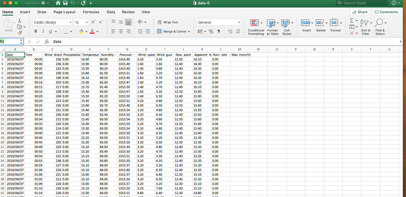

I attach a copy of my meteotemplate export...
Also have weathercat...don’t know if a workaround from there would be easier ?
Regards,
Leon.

Okay, there's a lot here that's not going to work.
First, you have semicolons instead of commas. Second, you have the date/time separated out from eachother.
Did this file come directly from MT? The columns also seem mixed up.
From MT 17.1 (latest version) my columns are:
0 DateTime Date and Time
1 T Temperature
2 Tmax (max temp)
3 Tmin (min temp)
4 H Humidity
5 D (dewpoint)
6 W Wind speed
7 G Wind gust
8 B Wind Direction
9 RR Rain rate
10 R Cumulative daily precipitation
11 P Pressure
12 S Solar radiation
13 A (apparent temp)
Can you provide an unaltered download from MT?

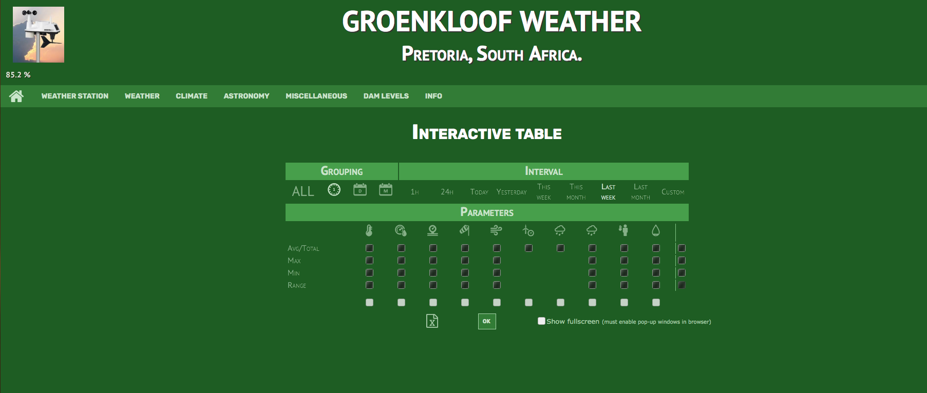

Screen Shot 2019-04-22 at 18.42.32.png (130.33 KiB) Viewed 8034 times
I have been using the interactive table to export .csv file for chosen dates.
That is also the file I posted on dropbox.
Is there another way ?
Kind regards,Leon.
staze
Posts: 198
Re: Data Import function for MB PRO and NANO SD
Post by staze »
oh. yes, that's the issue.
You want to go into the MT control panel, and under "Backup" just select "All" or a specific year and "OK". It should download a database export.
At that point, all you should need to do (since you're already on ISO units) is change the solar radiation field to 0 rather than null. I would suggest using TextWrangler, or BBEdit. Do a find and replace for ",," and replace with ",0,".
Then save the file, and try importing into MB.
