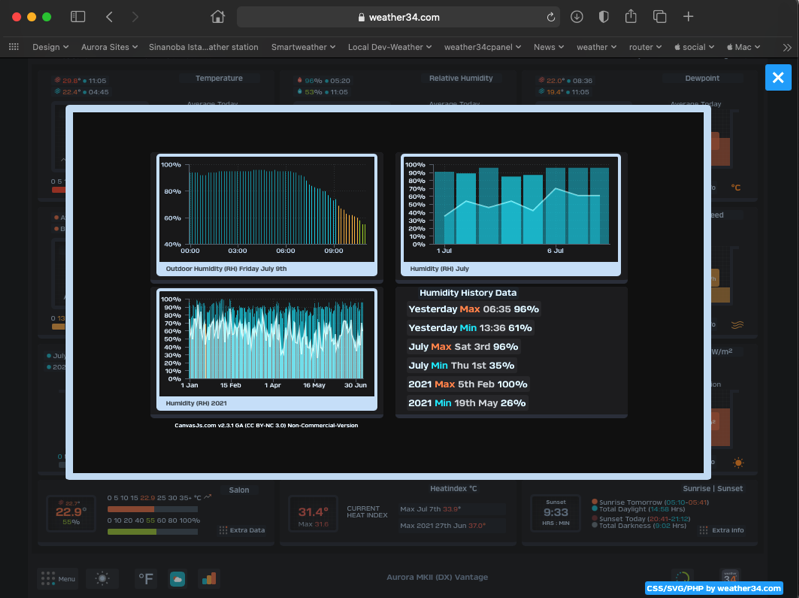

Josep todays update adds the month, year humidity charts to extra info for Humidity see screenshot.*note need to allow a couple of days to collect data in the CSV file after applying the update file as there are two new strings in the end of day file.

* (11:00) Adds month/year humidity charts to extra info screen
* (11:00) Humidity month/year charts allow 2 days for csv data

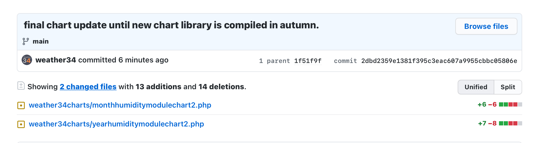

@chuck and others Github was just updated for some reason github app was timing out so check to ensure the two month,year humidity chart files are correct ,you can cross check as the originals were looking for older out of sync positions.
have a good day
weatherist34 wrote: Fri Jul 09, 2021 2:48 pm @chuck and others Github was just updated for some reason github app was timing out so check to ensure the two month,year humidity chart files are correct ,you can cross check as the originals were looking for older out of sync positions.
have a good day
Ok. I have them.

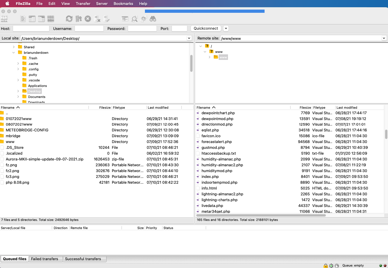

Looking for some help have moved to a mac computer from windows pc.to transfer updates I have been using FileZilla using the same on new mac I am unable to see the zip files in the directory on host site this includes the backup and any updates/also when transferring zip updates they appear to be unzipping ?
Thanks Richard

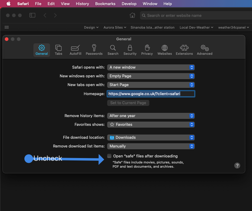

good morning Richard , long time since I used Filezilla but I installed this morning on Mac OS Big Sur.
are you saying it unzips when download it to your computer ? if so see screenshot in Safari preferences disable automatic opening /unzipping possibly options like this in other browsers .
in Filezilla you need to make sure the window is showing your user name area , probably the download is in the downloads folder , in the screenshot below I put it on the desktop.
also need to check your FTP login user name has priveleges for accessing the root folder of your website then you should something like below once connected via FTP .* now may differ in layout of root folder on different hosts .not much I can really offer been a long time since I used it but 30 seconds install and it simply worked as expected .I use a built FTP option/plugin in the developer app I use for designing this template https://code.visualstudio.com simply allows me to push files to server after editing .

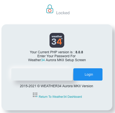

for those PHP 8 curious observers all good on latest PHP 8.0.8 release
php 8.08.png (41.19 KiB) Viewed 3694 times
