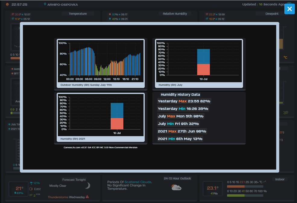

Hi, Brian!
For the second update in a row, I observe such a thing: when pressing the extra info button in the humidity module, the entire history for the month and for the year disappeared in all other modules (temperature, pressure, wind, etc.) everything is fine

Your module looks fine from here - maybe a cache issue?

month year humidity only introduced 3 days ago in the end of day hence no history from january as per previous comment,its not really the ideal time to release a new chart for year .better to have waited to start of new year as mentioned before .

Ha, fixed. :D

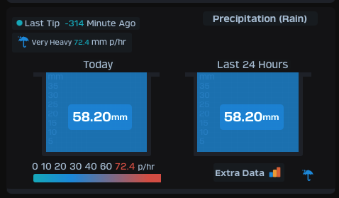

@Jason this is not exactly what you asked for in terms of animation but if rain for day is greater than 35mm/1.3in the bucket uses a stronger bolder blue .ignore the last tip my demo is a different timezone compared to realtime data from Lars in Singapore I was using his data in demo.better than nothing ?.. https://singaporeweather.info/

weatherist34 wrote: Mon Jul 12, 2021 11:06 am @Jason this is not exactly what you asked for in terms of animation but if rain for day is greater than 35mm/1.3in the bucket uses a stronger bolder blue
Brian, I just had a brainwave. When the bucket gets full (say at +35mm or +50mm) then after that the bottom of the entire rain data box should have a layer of the bolder blue colour which would look like it is flooding the box as the bucket is full. Is that doable? I don't think it should grow too much; perhaps only increment every 25mm of additional rain? Something for the autumn fee-based version?
Jason

Good afternoon Jason
not sure I follow or picture your idea visually . for reference mostly the autumn paid version is really all about chart layouts as it will use a new chart library .
