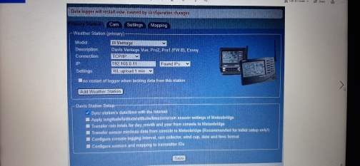

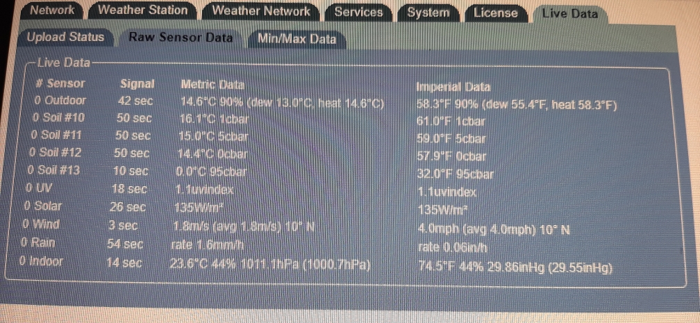

Hello everyone,my firts message here..I need some help
please find attached some pictures...
I have a problem since this morning
Weather station Davis Vantage Pro IP data logger and send information for a long time by meteobrigde tp linkl-mr3020 V10 F
"These stations can be equipped with an IP-based Logger called WLIP. If you have one of these, please select WLIP operation (and how often Meteobridge should pause to allow upload to Davis Weatherlink services in parallel to Meteobridge operation) and enter IP and port (separated by a colon) in the input field next to the selection box (example: "192.168.1.222:10001"). This will tell Meteobridge to connect this station not via USB but via your LAN/WLAN (in the example on IP 192.168.1.222 at port 10001). When you don't specify a port, the WLIP default port (22222) is used."

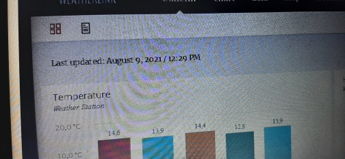

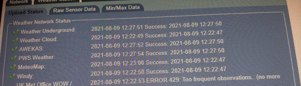

Well,I have the settings WL upload every 1 minute to weatherlink.com(the bulletin) but its not working at all...If I turn off meteobrigde..working but with meteobrigde non
The rest everything was ok..
The last thing I did..turn off meteobrigde and now I try with another software(weatherdisplay)released conection everyminute to allow weatherlink.com updates and with this software everything its ok.... :roll:
Someone out there have the same issue..need some help
