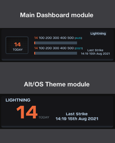

* (16:58) **Adds a basic module to support Ecowitt lightning
* (16:58) **Adds 2 options in setup to use Ecowitt basic lightning module
* (16:58) **Ecowitt lightning must be mapped to [lgt0----] example [lgt0total-daysum.0:--]
* (16:58) **Adds Humidity forecast if no UV,SNOW,RAIN,HEAT INDEX
Ecowitt lightning is a very basic module in time I will look into chart data but not at the moment something is better than nothing.
you will need to create a separate service to run which I will publish in due course , it simply is just a few strings as we don't need a full blown API this will also enable chart data to be logged daily, monthly,yearly as seen here in a live example with weatherflow lightning module https://myrtleweather.com/console/index.php

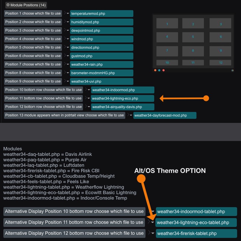

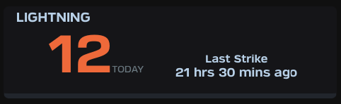

Ecowitt Lightning
c. Ecowitt Lightning Only
To use the basic Lightning module when using a Ecowitt or alike sensor you need to run this in the meteobridge service Select the Services Tab
1. Goto Select new service
2. Select from the drop down menu HTTP Request
3. Select periodically in the next menu
4. Click Save at the bottom of the screen
5. Now look for new HTTP request
6. select 1 minute
7. NOW INSERT THE URL with the appending script and required strings examples and note please inspect the string
8. https://yourdomain.com/aurora/mbridge/m ... ing.php?d=[lgt0energy-act:--] [lgt0dist-act:--] [lgt0total-nonzerotime:--] [lgt0total-daysum.0:--] [lgt0total-monthsum.0:--] [lgt0total-yearsum.0:--] [lgt0total-sum10.0:--]
8a. https://yourdomain.com/console/mbridge/ ... ing.php?d=[lgt0energy-act:--] [lgt0dist-act:--] [lgt0total-nonzerotime:--] [lgt0total-daysum.0:--] [lgt0total-monthsum.0:--] [lgt0total-yearsum.0:--] [lgt0total-sum10.0:--]
9. now click save .
10. * Make sure you have entered the appending string correctly in the meteobridge services setup up screen
11. * In the template setup screen you can select the module weather34-lightning-eco.php or if using Alt/OS theme select
weather34-lightning-eco-tablet.php
*The structure for the basic simple string
mb-lightning.php?d=[lgt0energy-act:--] [lgt0dist-act:--] [lgt0total-nonzerotime:--] [lgt0total-daysum.0:--] [lgt0total-monthsum.0:--] [lgt0total-yearsum.0:--] [lgt0total-sum10.0:--]
setup info page https://weather34.com/homeweatherstatio ... guide.html
live example using basic lightning module http://ringwoodweather.ddns.net/Aurora2/index.php
PS ..as far im going with this brand for now so please no requests for other sensors from the brand.

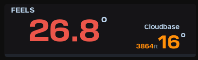

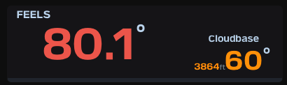

* (10:48) **Update for Alt/OS Theme layout
* (10:48) **Adds cloudbase temp to feels module if no heat index,windchill

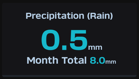

Download Update 17th August 2021
* (07:28) **Update for Alt/OS theme update
* (07:28) **Adds month rain total if no rain rate
* (07:28) **Adds true last strike timeago for Ecowitt lightning modules
* (07:28) **Adds wind average trend arrow
for Ecowitt Lightning Sensor use see end of setup guide
here Setup Info Guide https://weather34.com/homeweatherstatio ... guide.html

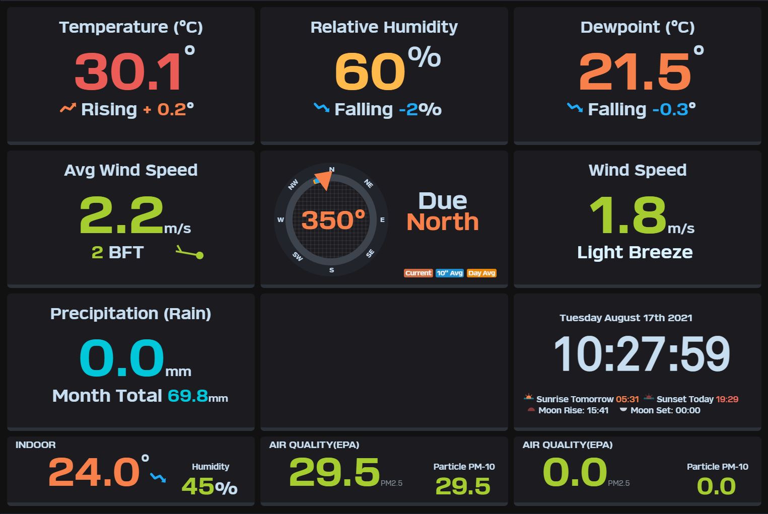

try the update just added basically interacts with position 8 using mmHG in main dashboard view .
* (10:17) **Adds Pressure module mmHG for Alt/OS Theme

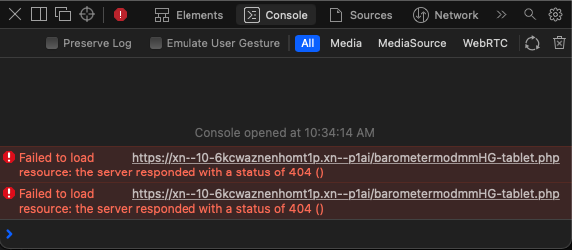

Thank you for your speed!

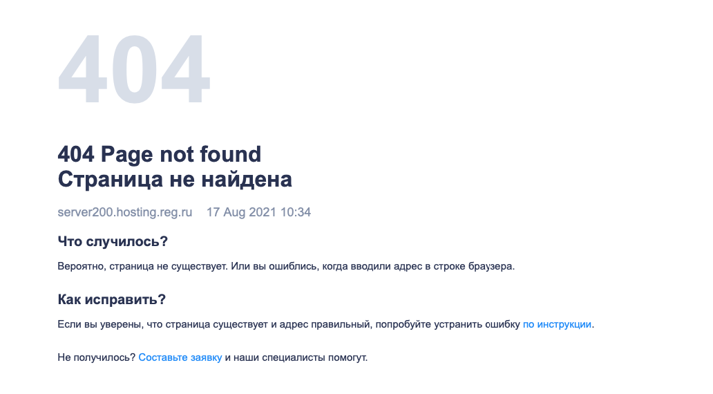

Only here there are no readings and when you hover over the pressure module, the cursor appears in the form of a cross. As I understand it, it should be similar to other modules - when you click, a pop-up window with a history appears
- pic.JPG (152.15 KiB) Viewed 5774 times
- Posts: 1826
Hi you have a 404 returned on the file barometermodmmHG-tablet.php so you need to check if was uploaded to your server
https://морская10метео.рф/barometermodmmHG-tablet.php

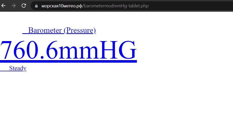

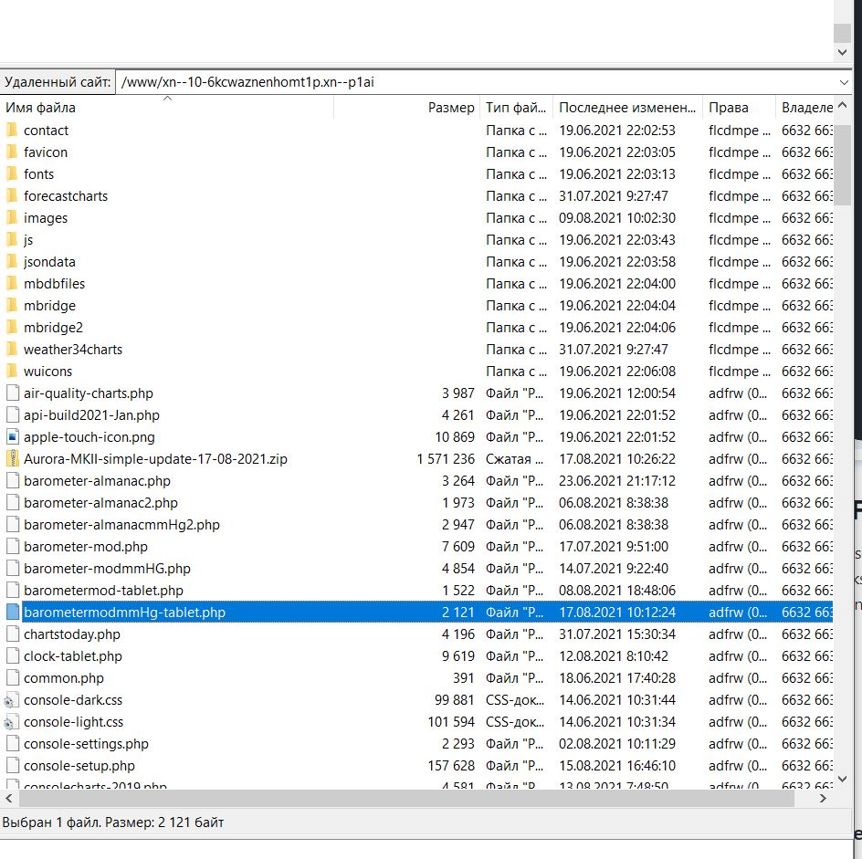

alexeysailman
- Expert Boarder
- Posts: 87
Strange... File barometermodmmHg-tablet.php on the server there is and if I have this link in the address bar of the browser, insert it: https://xn--10-6kcwaznenhomt1p.xn--p1ai ... tablet.php, then it will look like in the second attached picture
- pic1.JPG (39.94 KiB) Viewed 5759 times
- pic.JPG (192.73 KiB) Viewed 5759 times

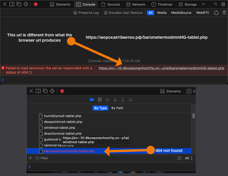

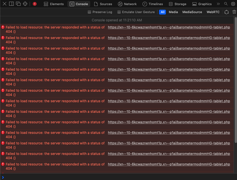

- Posts: 1826
https://морская10метео.рф/barometermodmmHG-tablet.php returns a 404
so do you have a redirect or rewrite of url ?
see console log error the url is different
very sorry can't help, you will have to resolve at server level ,console log reveals the anomalies
continuous string of 404 returns
- Posts: 1826
solution download the update again and run it that should resolve it . your server is case sensitive configured? so I've adjusted the updater-tablet.php file to comply with that.
