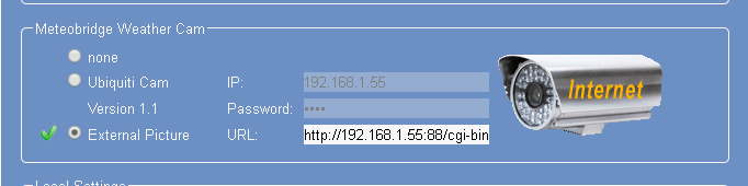

I use a local foscam
External Picture URL: 192.168.1.55:88/cgi-bin/CGIProxy.fcgi?cmd=snapPicture2
correctly generates aircam.jpg but does not load ftp.
in fw 3.6 works well.
I guess the problem is in:
adds support for HTTPS URLs for grabbing web cam pictures.
Platform: TL-MR3020 (plus USB hub)
RAM: 29364 kB total, 3312 kB free (88% used)
SW Version: Meteobridge 3.7 (Aug 26 2018, build 12309), FW 1.4
Josep.
Josep.
- Sin título.png (17.78 KiB) Viewed 8538 times
