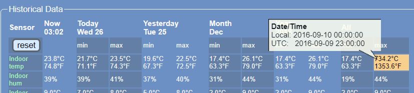

ok I tried to import a cumulusMX csv for 1 whole year. I noticed in the historic data the ALL indoor temp Max was 734c and climbing. the date listed and that value is the overall Raincounter value.
this is obviously a bug and the indoor temp for "All max " is somehow linked /mixed up to the raincounter value.
when importing the values are:
"LogDateTime","Temp","Humidity","Dewpoint","Windspeed","Windgust","Windbearing","RainRate","TodayRainSoFar","Pressure","Raincounter","InsideTemp","InsideHumidity","LatestWindGust","WindChill","HeatIndex","UVindex","SolarRad","Evapotrans","AnnualEvapTran","ApparentTemp","MaxSolarRad","HrsSunShine","CurrWindBearing","RG11rain","RainSinceMidnight","WindbearingSym","CurrWindBearingSym"
"2016-09-11 00:00:00","11.2","81","8.0","3.0","8.0","199","0.0","0.0","1010.13","734.2","24.7","48","3.0","11.2","11.2","0.0","0.0","0.0","7.8","9.8","0.0","0.0","183","0.0","0.0","SSW","S"
in its current state the CumulusMX import values do not copy over to the correct values in Meteobridge.
Re: Data Import function for MB PRO and NANO SD
Thanks for spotting these errors. I changed the code accordingly. Now lines starting directly with a digit or with " or with (" are recognized as data records. Delimiters can be anything. Decimals need to be separated by "." (German "," notation for decimals is currently not supported).
An Update covering that is just released.
