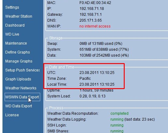

On all of my Meteohub Sheevaplug units, UTC is always equal to Local time. How can I fix this??
Posts: 8033
Re: Setting UTC time takes no effect
try another time zone. there are ones devided to continents, which should work.
Post by lks6869 »
I changed the time zone to "US/Pacific" and it works correctly now. Choosing "Pacific" does not work, seems to be an invalid selection.
